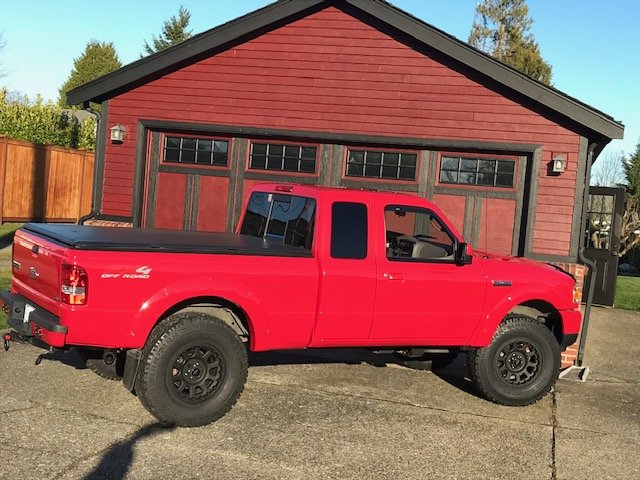

Fast forward from the mild lift and new shocks at the start of the year to this past week. Went round and round on trying to find a spare set of either Ranger 16" rims or Explorer 17" rims for the Ranger. The current smallish tires on the OEM rims are snow tires, so wanted an all-terrain tire as I plan on hitting the easy and moderate trails in Moab this Spring and might as well keep the snow tires mounted.
Ended up with a new set of Pro Comp Bandido rims in 16"x8" for a decent price from 4WP. Tires are Cepek Fun Country II's sized 285/75/16, also decently priced and mounted from 4WP.
Here's a picture from yesterday:

That's looking pretty good. No clearance issue with those 285's?

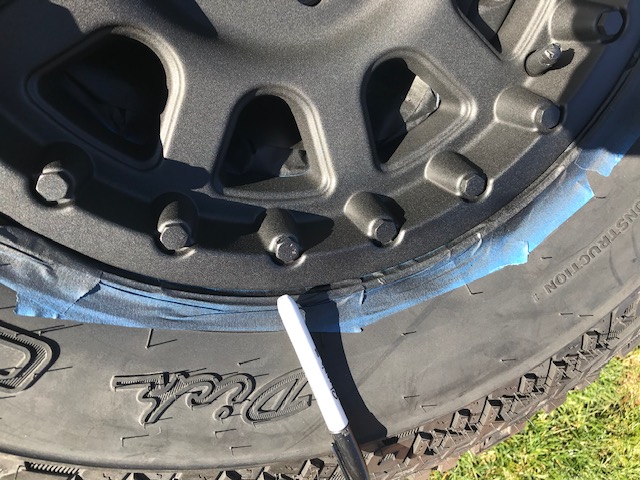

The "bolts" are just a design feature, but difficult to believe this went unnoticed at the shop. . . So in defense of 4WP, I didn't give them the opportunity to fix this - - but since I left the shop before noting the broken-off bolt, and already confronting them with the "upcharges" at the outset, figured I'd just "sack up" and chalk it up to failure on my end for proper inspection before acceptance.
But, I'm skilled enough to fix this. . . And, thought the flat black was too flat, so addressed this as well. . .
Project "Slippery Slope" - 2011 FX4
Close inspection shows the grade markings on the sacrificial bolt I used to make the repair.
As for the clearance, I get a rub near full lock on the front end. And although the rig is not flexy, will get some stuffing issues when out on the trail. But along the lines of the plan for this vehicle, mild lift and accommodations for overlanding, not hard core trail use. . . (for now).
Close up of the new wheels mounted.

Is it rubbing on both sides at full lock? I found on the passenger side, there were a couple nubs that aren’t on the driver’s side wheel well liner. Cutting those off with a Dremel fixed the problem. On the driver’s side there is a hump in the wheel liner that can only be fixed with a lift or a cut and patch job. I suspect there may be something there that required the hump. So pre-key mod, here I come. I did have the trim a little on the driver’s side wheel well liner a little too.

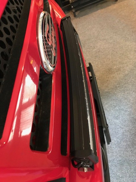

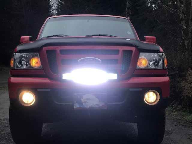

Between adding the torsion keys/rear blocks (December) and mounting the new wheel/tire combo (March), added a few lighting upgrades. Since overlanding is the objective for this vehicle, don't even plan on adding upgraded bumpers (yet), so a front bumper that's winch capable with tabs for lights wasn't even on the shopping list; however I did want some additional lighting both front and rear.
For the front I went with a AUTOSAVER88 24" Triple Row Curved LED Light Bar:
Here's an overhead shot of curved radius - pretty good match for the curve of the front bumper:

For the rear, always liked the flush-mounted flood lights, not wired to reverse, but on a separate switch. Selected the OFFROADTOWN 5'' 78W Lights:
Pretty easy to cut into the fender, just drill and jigsaw. Also relocated the trailer plug from dangling under the frame to the bumper (to the right of driver side light, left of license plate).

Sandman - To some degree, these tires will be "self-clearancing", meaning that what ever they rub up against, they'll wear through it or I'll eventually get around to cutting. . . soft parts anyway. . .
Stranger - Plenty of faux bead locks out there that look way cheesier than these, but anyone who ever put a Ranger in four wheel "low" will know in an instant those aren't bead locks . . . and while I don't really care for the "bolts", I went with the cheapest aluminum rims I could find in 16"x8".

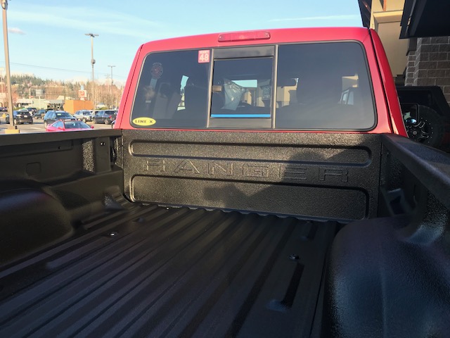

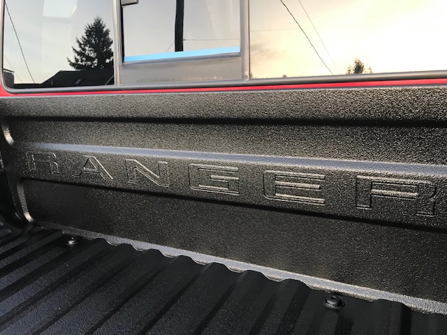

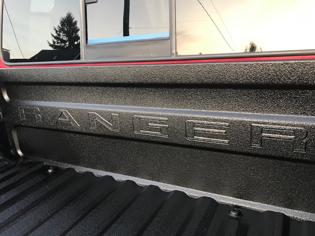

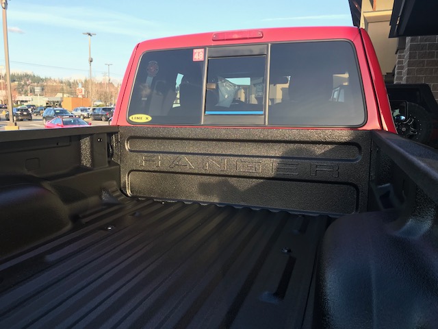

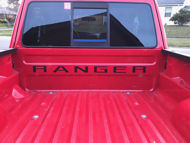

Since on the subject of paint, will address the use of Line-X. The bed was scuffed up and had a few minor dents, and although I've used Hercu-Liner and Monsta-Liner with pretty good results, Line-X or Rhino Liner always looks a whole lot better.
I also like experimenting with different features on new and older versions of the Ranger, and like the idea of the letter "inserts" that are sold aftermarket to the 6th generation Rangers to fit into the tailgate. No plans to apply them to the tailgate, but thought they'd look good in the bed.
Think I was right:
And I thought they would look even better "murdered out" after having the Line-X applied. So fixed the dents and turned the truck over to a local shop.
Like the results:
Money shot:
I also like experimenting with different features on new and older versions of the Ranger, and like the idea of the letter "inserts" that are sold aftermarket to the 5th generation Rangers to fit into the tailgate. No plans to apply them to the tailgate, but thought they'd look good in the bed.
Think I was right:
Like the results:
Money shot:
Knocking out some wiring this weekend, so stay tuned,
Paul
You used "inserts" on the flat surface to give a raised letter effect? Thats pretty slick ?
