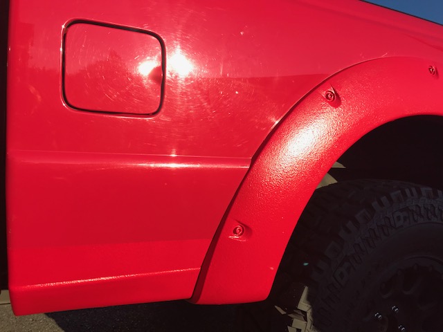

Fender Flare:
All in all, the paint on the rig was in very good condition - - some scuffs and scratches on the fender flares, and my guess is that the P.O. might have towed it behind a motorhome, as the front bumper, grill, sideview mirrors, and windshield all look like they've been lightly sand-blasted - - not too bad, but noticeable. And as mentioned, the leftover epoxy on the hood, and my questionable efforts to remove it, made me determined to correct that problem area.

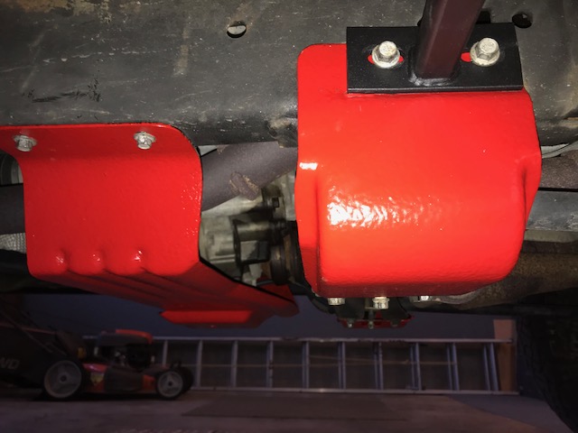

One of the items that was slated for Monsta-Liner was the new rock sliders I mounted up a few weeks ago, but after test fitting them on the truck decided to leave them black.
Coated the underside of the rockers where the sliders bolt up:

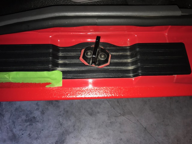

And then rolled the liner to coat the inner door jambs:

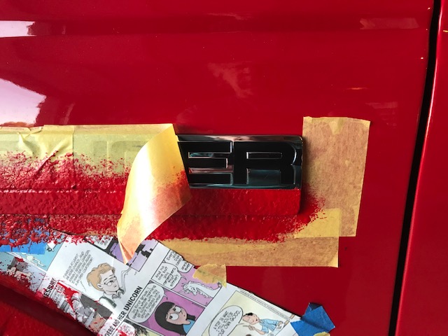

Did some other small stuff too, like the lower "chrome" section of the Ranger emblems on the front fenders:

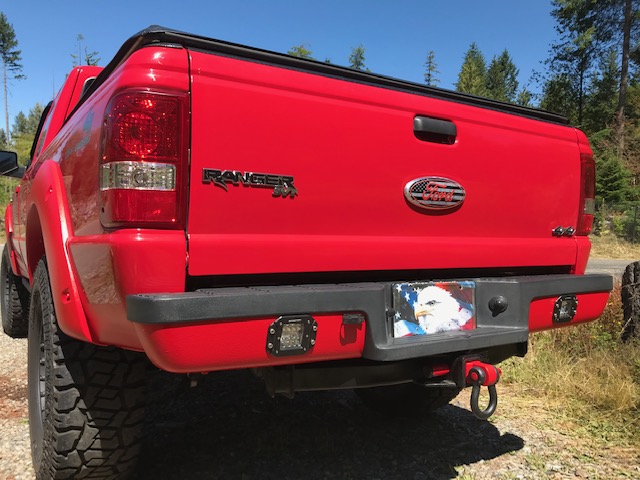

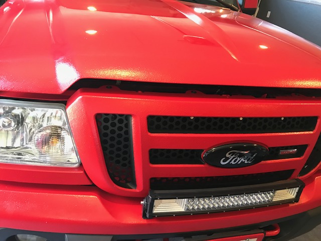

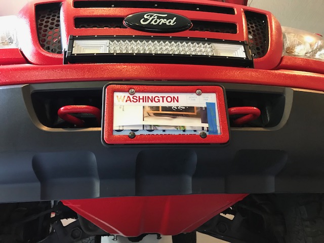

Knew when I wired the front and rear LEDs, as well as the "Raptor" lights into the grill that all that stuff would need to be removed in order to execute this project, so the reassembly took some time, but always a chance to improve the build.
Front end back together:
Hood not closed (gap), but you can see the coating on the hood lip, concave hood centerline, as well as grill, headlight surrounds, and bumper.
Another shot of the front end showing some of the accessories that also got a coating of Monsta-Liner (tow hooks, license plate frame, and skid plate[!]):
Mentioned earlier that the desire to use the bulk of the product led to interesting choices for applying the Monsta-Liner, so decided to coat a few skid plates, and the torsion key covers. . . I know, I know, seems more like a "show truck" choice than an "overlanding" choice, but think they came out well:

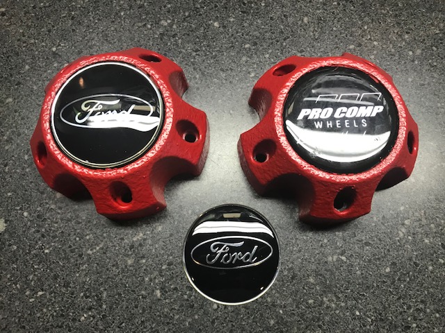

Another accessory painted was the wheel hub covers - - black rims, black tires, this added some color:
Added Ford emblems to the hub covers - - nothing against Pro Comp, just rather make it look OEM.

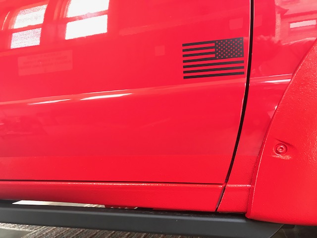

Last addition was a set of opposing flag stickers for each door:
Glad I opted to leave the sliders black - - definitely ties the black components (rims, sliders, flag stickers) together.

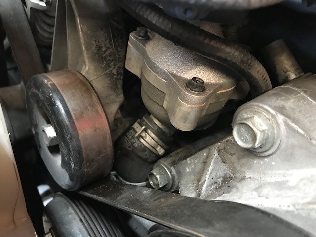

Work day to finally replace the leaky stock thermostat housing. . . I'm a Ford guy, but who at the Blue Oval thought this plasticky-thing was a good engineering option?
Forgot to take a photo pre-demo, but you can see the scaling between the two pieces.
Got the link for Simmons Autosportz from lurking on this site, here it is for anyone interested: https://simmonsautosportz.com/products
Buttoned up:
Paul
