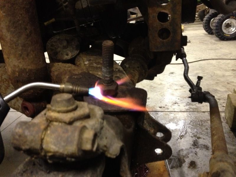

To remove the studs to separate the radius arms is warmed the studs with a small propane torch and then cooled them in water to loosen up the loctite and rust that has been building on them for 18 years. I used a 1 1/8" ratcheting combination wrench with a second wrench as a cheater. The deepwell socket I had would not clear the stud, so these came out but hand. I used the same setup to loosen the radius arm nuts as well. But I was able use an impact wrench once I broke them loose. :D
