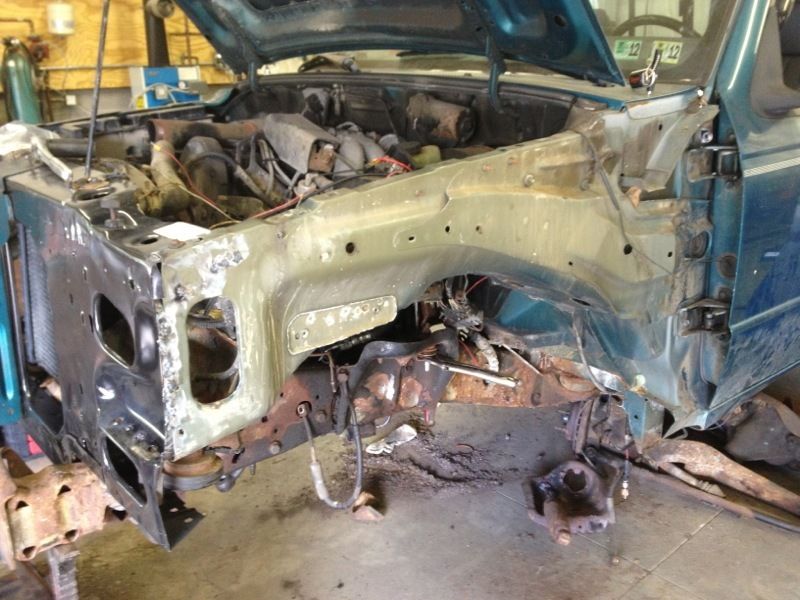

Joey's dad was on vacation and got bored... so he decided to swap my radiator core support and replace the other support bracket on the frame. He also got the quarter panel off that I couldn't get the bolt out of. It took in 3 hours... It would have taken me a week. I am so grateful! :icon_bounceblue:

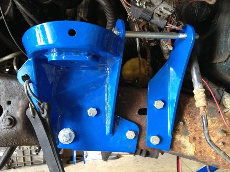

Old support and frame bracket:
Project Little Green Turd
I picked up some Chassis Saver for some major undercoating. I am going home one night this week to test fit the new parts and drill the new holes. I got the other factory coil bucket and transmission crossmember bracket off too. Once I get the new holes drilled, I will have to degrease the frame and begin painting and then I am finally ready for reassembly!!! :icon_thumby:

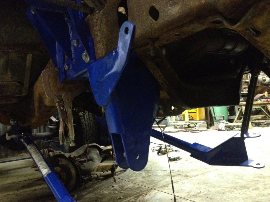

Got all but one bracket fitted last night!
Driver's Side
Passenger's Side
There are 6 new holes to drill and two rivet stubs I missed. Next trip (I think on Saturday) I have to remove all the brackets, clean up the frame, and begin painting. Also have to pick up some parts on 1badexplorer.

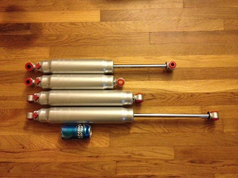

I also got a comparison shot of shocks. This is a 2.5" Lift Rancho 9000XL shock for my F250, Duff 70/30 3" Lift Shock for the Rear of the Ranger, and a 12oz Coors Light wide mouth can :beer:
The Rancho's are definitely for a heavy truck with their resistance on the softest setting. I have to give it JD though, their shocks have a better quality of build and feel. They are also super soft. I really look forward to getting to try them.

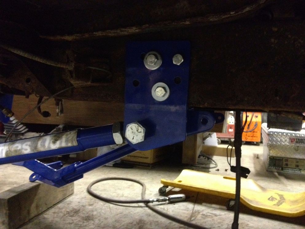

I got back to the garage for a full day of work. I got the rest of the suspension loosely assembled, minus front axle and one drop bracket. Everything fits good and snug.

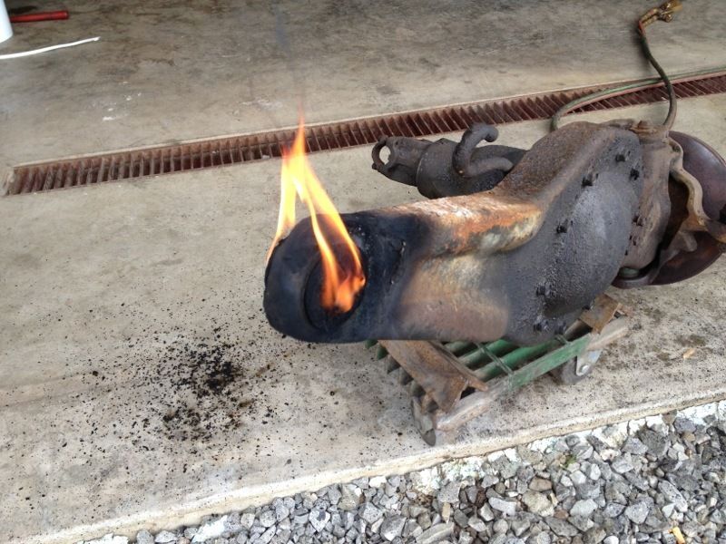

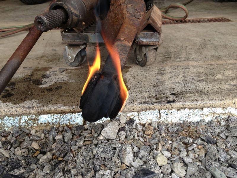

Started cleaning up the front axle for paint too. Seemed the only way to get the old bushings out of the axles was to take a beer break...
