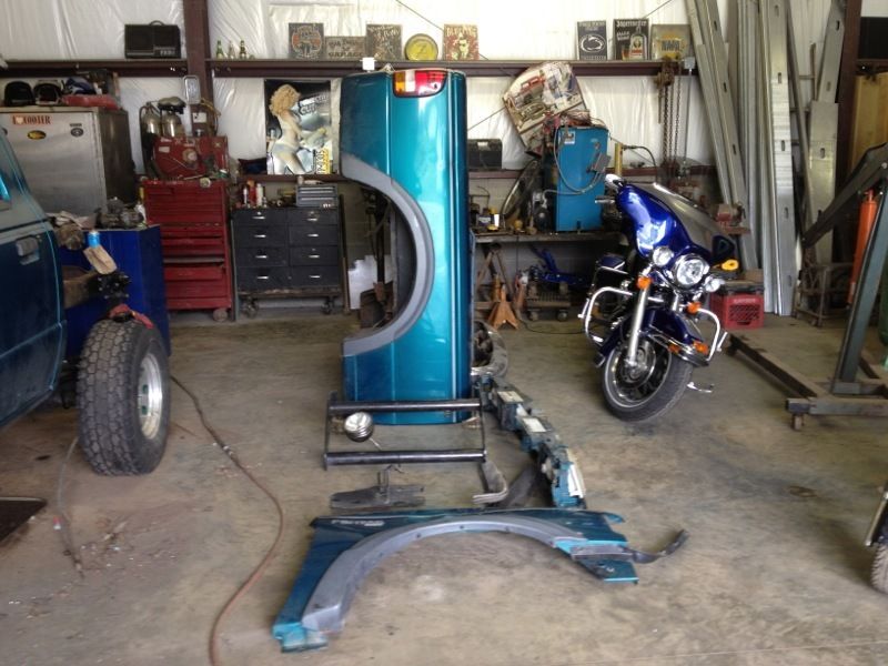

Behind the door, and under the truck are the only two that I can think of now that you have the fiberglass thingy off.
I got behind the door. I have have to look underneath. I got 6 bolts out of each side. Do I have to pull the fender flares off?
Sent from my iPhone
Nope. There is a bolt inside a plastic tub type thingy that is connected to the wheel well. You have to pull out the plastic push in clips and pull the tub down. That will give you access to the last bolt. Just brace yourself for lots of dirt, crap, and rust:icon_thumby:
I got back to get some more done today. Thanks to prerunner, I got the last quarter panel bolts out and got the fender wells out and began on the suspension. The driver side quarter is still on because the bolt in the door jam stripped. I am not sure what I am going to do about that yet... :annoyed:

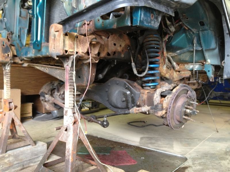

I got the sway bar off, and it well never be going back on. The shocks are disconnected from the radius arms. The steering is disconnected from pitman arm. I got some penetrating oil on all the front parts that are getting scrapped. Next trip will hopefully be removing all the suspension so I can clean up the frame and begin adding the new stuff.

Anyone got any tips for getting the spring retainer nut off? I did it once, but they are a pain in the ass!

Hey if you are still having trouble with the spring retainer bolts on the axle beam just use a long extension and go through the top of the bucket. thats how I put mine on the last time.
