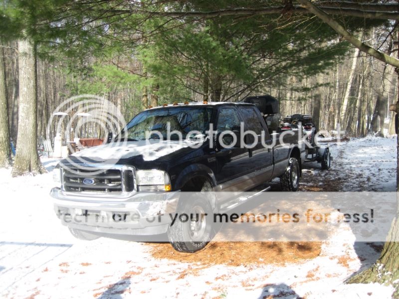

In the mean time, I have been DD the F250 and everytime I drive it, I think I love it a little more :icon_cheers:

So far I added the Class IV hitch to it and replaced the factory stereo with the Pioneer one I had in the garage from the old F250. She just passed inspection today which made me happy less cash out of my pocket :icon_cheers:
