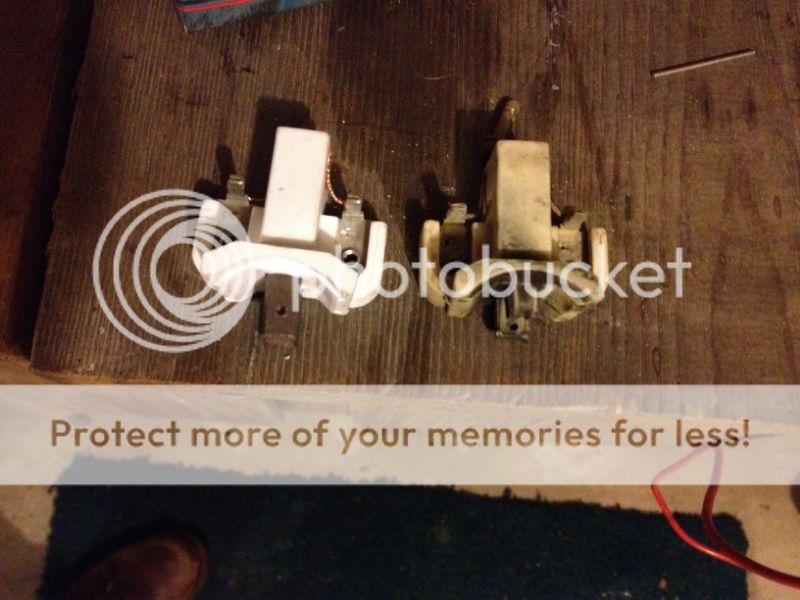

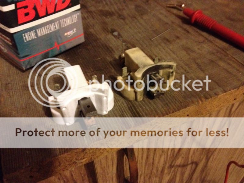

Pulled the alternator out and one of the brushes was shot. This eliminated the charge light when I first started the truck. After driving it for 5 minutes, the light faintly came on again. I picked up a new regulator at lunch today and I'll probably swap that in tonight. For the record, brushes are very cheap and easy to change. Way cheaper than buying a new alternator, I just wish it would've fixed my problem :annoyed:
The top brush on the old pair was worn down through the pin hole in the brushes, probably a 1/4" more than the bottom brush.

Regulator seemed to solve the problem... Lets see how long it lasts! Total cost for regulator and brushes with Advance Auto discounts was $40. Its a lot cheaper than a new alternator. And for the record, I have a 130 amp alternator on my truck and the brushes and regulator from a 95 amp seemed to work fine. The brushes were identical, I'd assume the regulator would be too.
