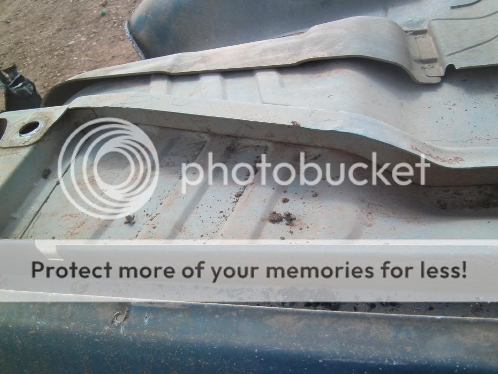

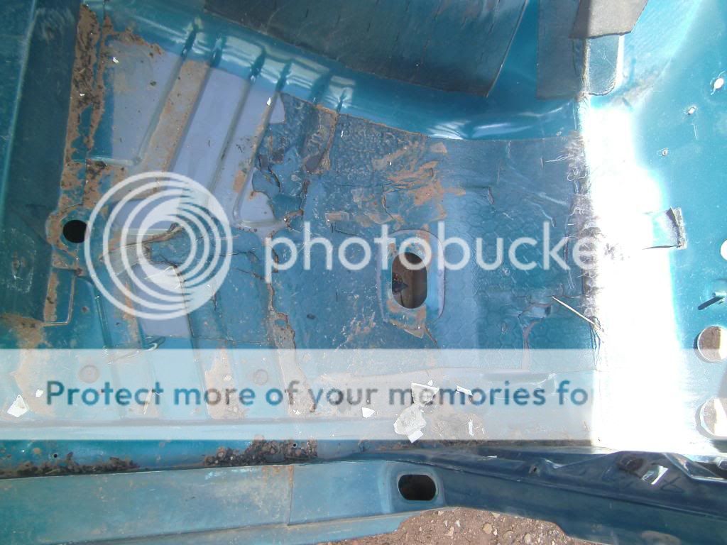

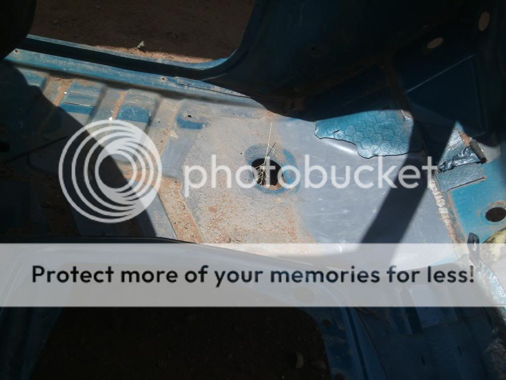

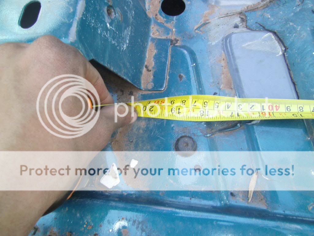

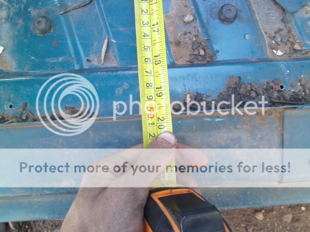

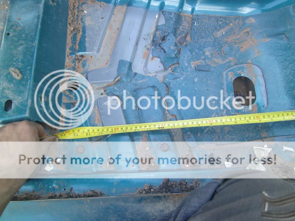

Here ya go man pics of the floor boards. Personally I would say the same. The measurements are rough so I am posting them but I wouldn't be sad if they are a bit off. Sorry the truck was stripped before I found out about your truck swap
Also can I get a close up pic of one of your doors trying to see what I have will work for the truck I am looking at.
