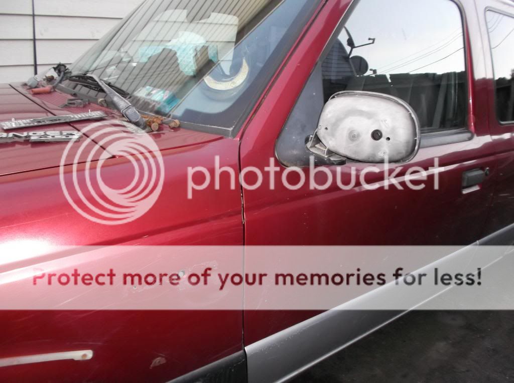

Yesterday and today at PicknPull and scored a right 08 taillight (when I get the left I'll update from the 03's I have on now), right 08 power mirror and 08 Ranger XLT fender emblems. I actually pulled the left mirror only to find the wiring had been pulled out of the motor inside so I passed on that. I'll find another somewhere.
I'm following member mjonesjr 07 mirror install but there are differences between his install and this. (http://www.therangerstation.com/Magazine/spring2009/2006+_mirror_mod.htm) I'll post pix once I get further on it. I'll pick up some 7/8 washers in the morning to finish mounting the mirror.

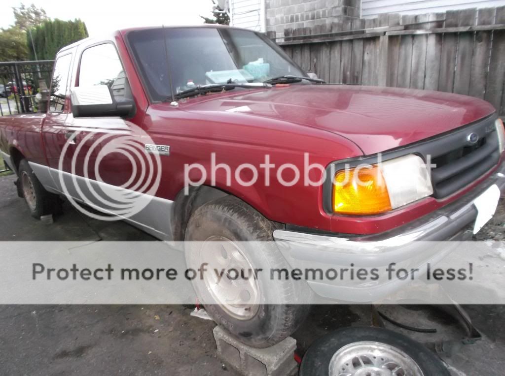

Current (tonight...) view of this project:

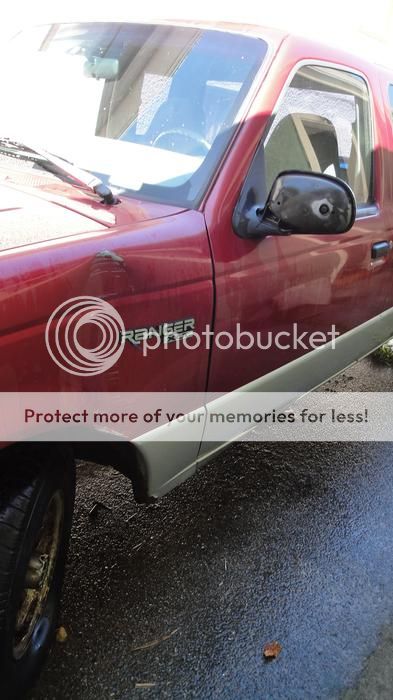

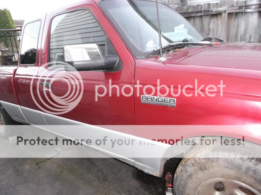

1993 2wd Ranger with 08 mirror and emblem on pass side. Looks a little goofy with the 4wd grille (plus its a total fraud! lol). :icon_confused:
For contrast, I haven't replaced the drivers side emblem and don't have the last style mirror for it yet. I did, however, replace the bent fender on this side.
