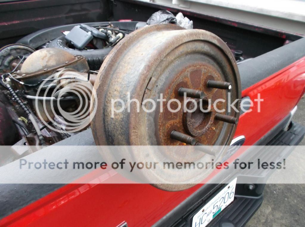

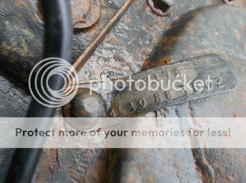

Well after posting on ranger_steve's 'The unnamed" 07 FX4 future SAS' page I learned my FX4 axle might not be as great as I hoped and after checking the library (http://www.therangerstation.com/tech_library/Ford-8_8-axle.shtml) I learned it isn't.
3" axle tubes and an axle tag that reads :4l10 as the ratio tells me its a 28 spline limited slip with 4.10 gears and thats all. But you know what? Its fine.
Sure the axle shafts are shared with the 7.5 axle and the 31 spline is heavier duty but for my needs bigger can wait.
Its got the bigger brakes, limited slip and 4.10's that Ford expected buyers to beat on some. Should be good to 33" tires or so.
I'm having a hard enough time piecing my junk together without getting hung up on not having the "sexiest" axle Ford put in a Ranger. Besides, it was $75.00. Hard to b!tch about that. Now to get it mounted below the box...
$75 for a axel with a ls and 4.10's is a hell of a deal in my book!
