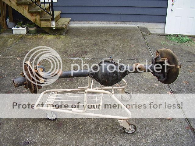

1973 U100 Bronco Dana 44. Outers are Chevy currently but need a Ford F150 rotor to convert it. Since the previous owner thoughtfully ground off the Ford mounts I'll continue with a leafspring conversion. This will be going into the Ranger after I pick up the things I need to finish rebuilding it, along with springs, shocks, Reid Racing knuckles and other miscellaneous swap crap. It has a 4.09 r & p in it (Dana Spicer gears, circa 1973) on an open carrier. Matches the 4.10 Torsen (2007 FX4) Ford 8.8 to go in around the same time.

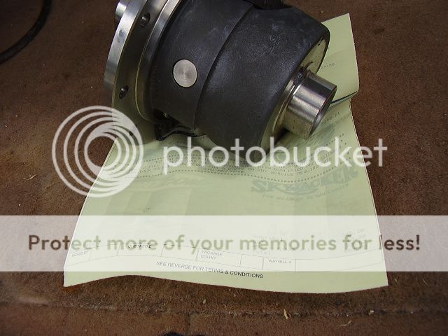

In time I'll swap the open center for an Auburn posi I bought for this and maybe 4.88 gears (also have now.)
