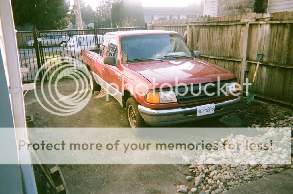

I get 22-26 mpg depending on where I'm at. Don't know about city cuz I spend very little time in one. If he ends up wanting it then that would be awesome. I need to fix a couple things I've broke before I will sell it though. When I was in Nebraska last month I drove through a harvested milo field when it was down to like 6 deg and I broke the splash guards in both front fender wells. And I had a air freshener in the center air vent then tried to adjust it. Apparently the left to right blade adjuster slides together so it came apart. Other than that it's dirty.
My ranger is coming along nicely. I haven't worked on it in a month and a half but I have to regear the rear end cuz I blew it up and adjust the angle of my coils then extend my radius arms and build belly armor for it. Then I will wheel it harder

Nice to be back after TRS was down for so long. Been having problems with the guinea pig this past week. I'm losing the clutch master cylinder in it. It barely shifts and has stranded me out of gear a few times. Parts places I've checked want a small fortune for it so with all the other things I'd have to buy to convert it to a 5 speed 4by, I'm scrapping that plan.

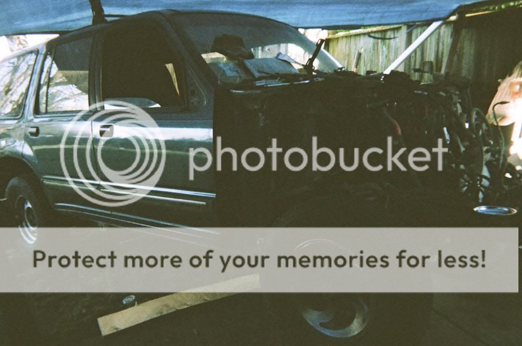

I've decided to swap the drivetrain from the parts Explorer into this. IIRC, the Electric T-case in the parts rig wasn't working or something, can't remember exactly what the seller told me, just that 4wd wasn't working. I have a 1354M I'll use instead. This unfortunately sucks several parts from the more hard-core project but I'll replace them in time.
Yesterday I bought the one piece driveshaft from a 99 Ranger 4 by as it was necessary at this point.
Still gathering parts and info for this change. Its still my dd so I gotta have everything ready to go before I swap. The Exploder ran and drove fairly well but was rusty.

Okay, I'm thinking I'd like to build a TTB version of an FX4. Fully update the front clip, driveline and as much as I can, interior. Don't get me wrong, I like my Ranger despite the grief it gives me sometimes, but I wouldn't mind it being a lot more like the newer top performance model.
This will get the newer clip, some lift, a front locker of some kind and a flexy suspension. Something that'll look good while getting the sh!t beat out of it.
First, I gotta just keep it alive... ;missingteeth;

The guinea pig is still coming apart and further apart than planned. Having spent a lot of time under this I've seen a ton of oil leak out of the engine, including a bunch found inside the bellhousing so I'm swapping it out too.
I dropped a 96 sploder 4 liter in the B-II and its relatively low mileage (200 k) so that should freshen things up under the guinea pig. The B-II will get the drivetrain out of the 92 sploder.

92 Sploder parts truck - fetching the driveline.
A couple hiccups have happened. One, I can't find the keys for the B-II. Important since I wanted the 1354m thats stored inside it as well as the plate off the trans hump for a manual T-case. Two, gf says no to re-insuring her car for some reason. (ok, I know why but still...) Three, we are having a cold snap here and I'm working outdoors.
So, hate to do this but it'll get the engine, trans and T-case outta the sploder instead. Its more expedient but not by much.
I'll go back to the 5 speed at some point, I hope.
Some good news (about damn time.) with this. Found the keys for the Bronco II today. Inside is the 1354m and floor plate for a manual transfer case. The linkage is underneath bolted to an auto trans. was NOT looking forward to putting an auto in this thing. Too much crap to go wrong.
Bent the hell outta the exhaust getting it out but I have another in the Bronco. Made a new floor plate for it from the one from the B II by tracing the 5 speed opening from the Ranger plate and tin snipping it out.
No, I'm not actually parting the Bronco into this. The Explorer driveline is going in there for a bit. Its just expedient to use parts from it. I need my dd back.
