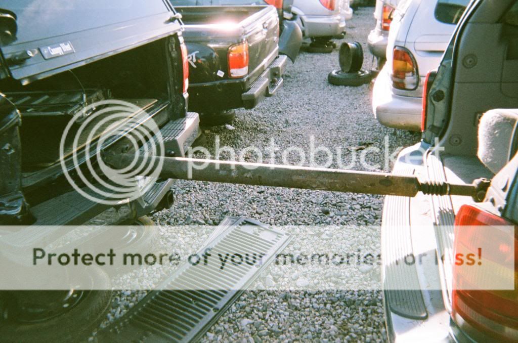

Old crap out, new crap laid out underneath. Took a while to gently angle grind then hammer the p!ss out of the crossmember that held the rubber bearing. Its getting a 1 piece shaft from a 99, so not needed.
One piece driveshaft (99 Ranger)

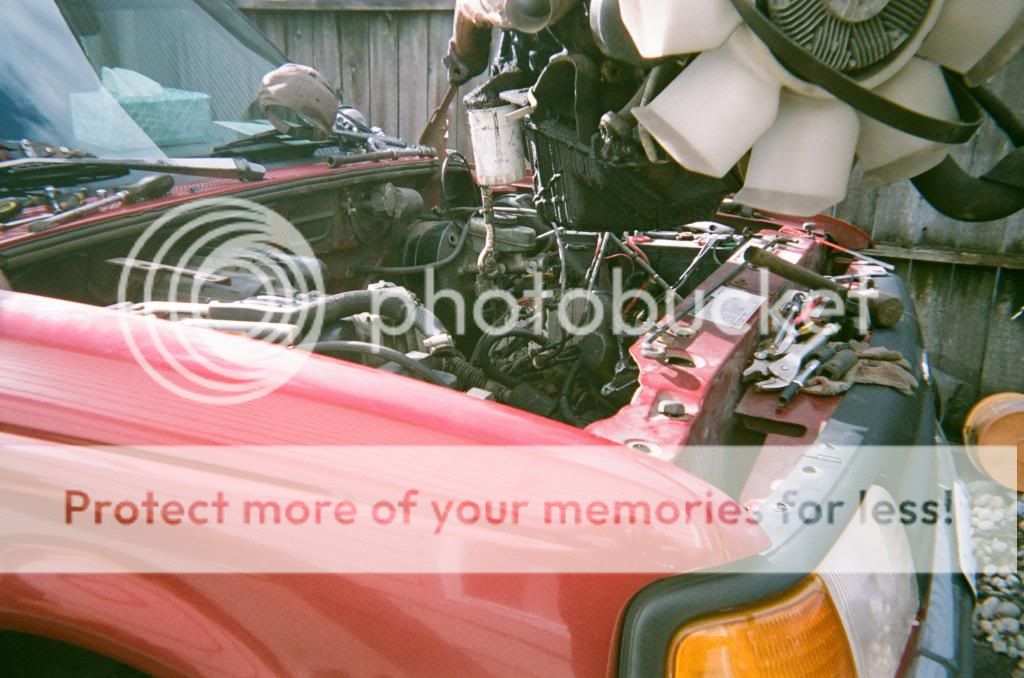

Tonight I got the 4.0 mostly ready to yank tomorrow from the Ranger. If the weather holds (supposed to be a few days window...) I hope to be pounding it back together within that time.

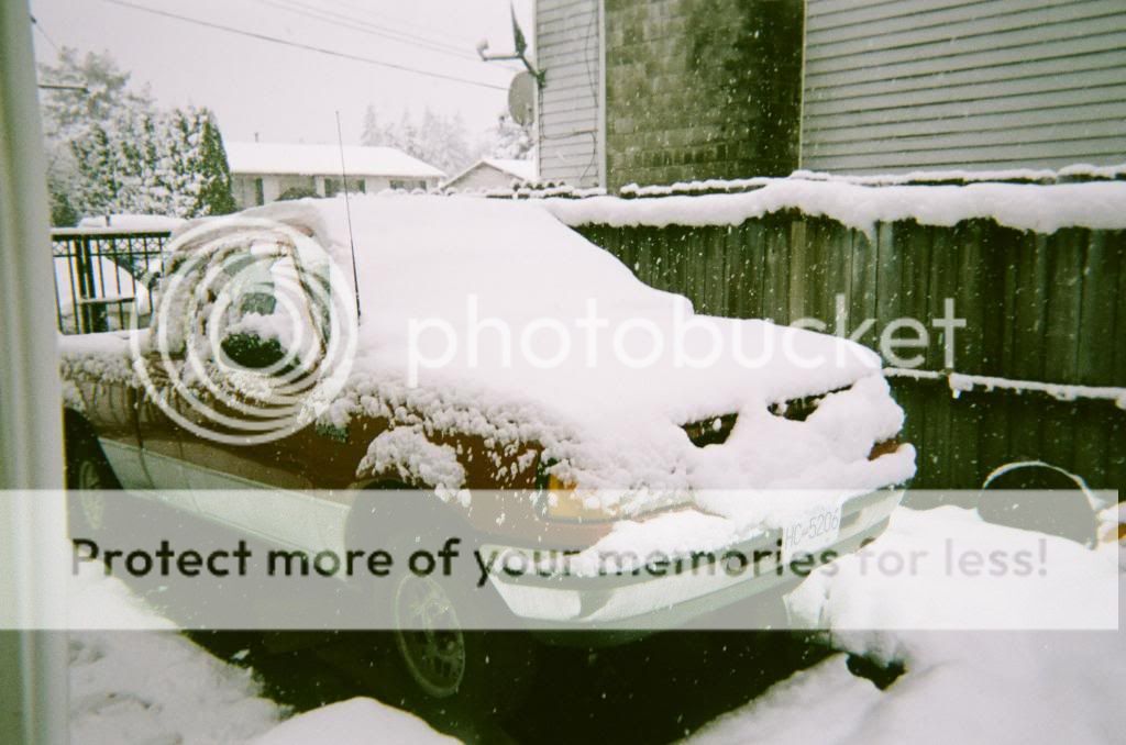

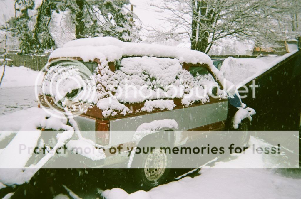

My tarp over the Explorer came down with the weight of the snow and ice on it this morning, its heavy stuff.
This also sucks.
Damn that blows!

Got the 4.0, A4LD, 1354E out of the Explorer over to the front of the Ranger. Was hoping to slam it in there tomorrow. Of course the Weather Network posts this:"Heavy rain to develop overnight and continue Saturday." (http://www.theweathernetwork.com/alerts/high-alert/canada/british-columbia/surrey Note: its metric. )
