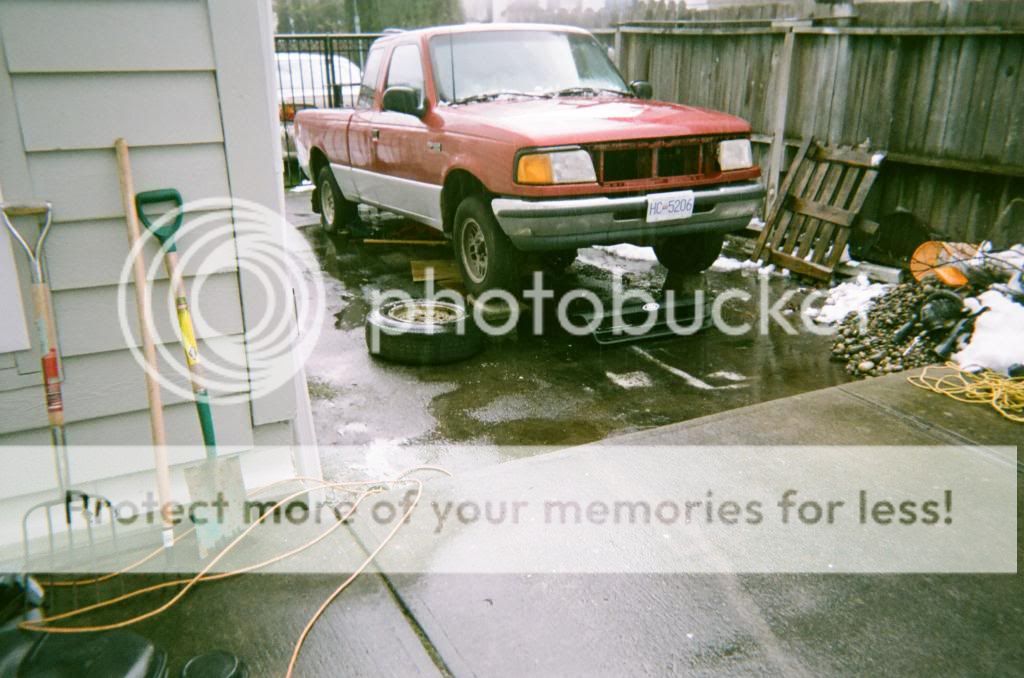

I ain't crawling under this:
Ok. Tonite its in the engine bay. Not quite in the right spot, has to move back 3" or so but I ran out of light. I tell ya what, I never thought much of body lifts before but I could see this thing getting one. What a pain in the @ss that was. Lift would have helped too, the 2wd is real close to the ground.
But. Its finally coming along. I'll have her screwed down and partly sorted out tomorrow. I think.

Can't post pix at the moment, sorry. My elderly camera won't download on this computer or any of the dept store ones. When I get a chance I'll develop some I took on a throw away camera.
Changed the wiring harness on the 4.0 today, not quite finished underhood but close enough I put the hood back on it. Still have some wires that I have to sort out yet. Next up: Put blocks back under it and sort out the change to an automatic.
