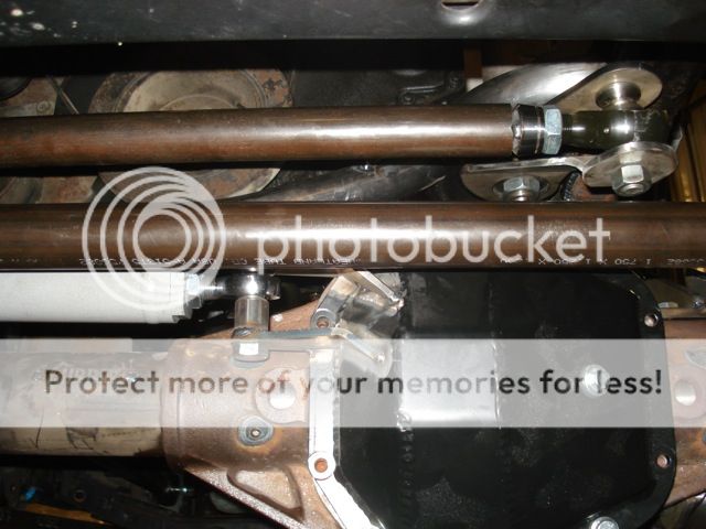

Back to original issue, many people mount the assist cylinders to a heavier fabbed cover because it works... With a smaller amount of axle space to work with it lets the cylinder sit more parallel to the tierod so there's less chance of bending it as well as having the cylinder attempt to rotate the tie rod which can be hard on TRE's/Heims etc.
Mine will be mounted to the tube.... cuz I don't have covers :thefinger:
