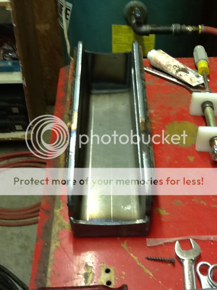

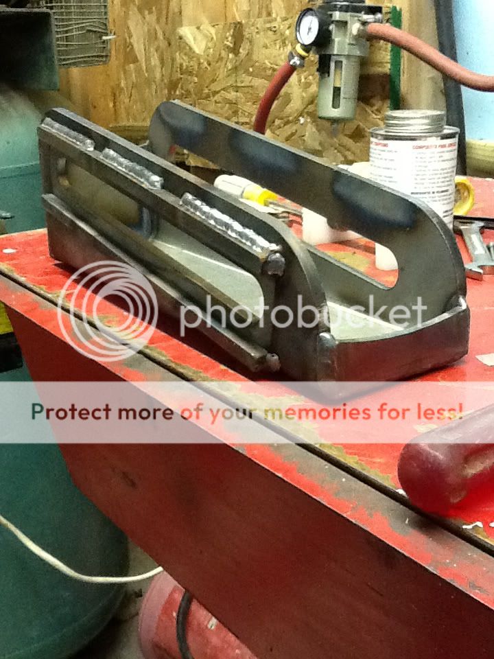

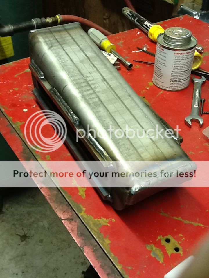

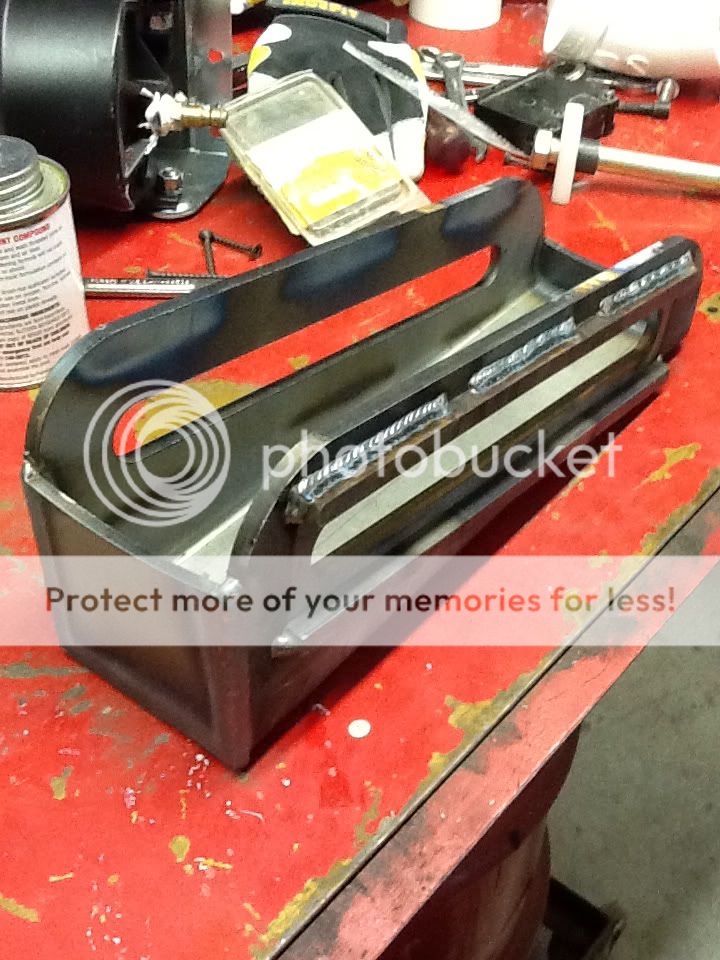

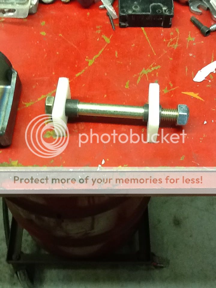

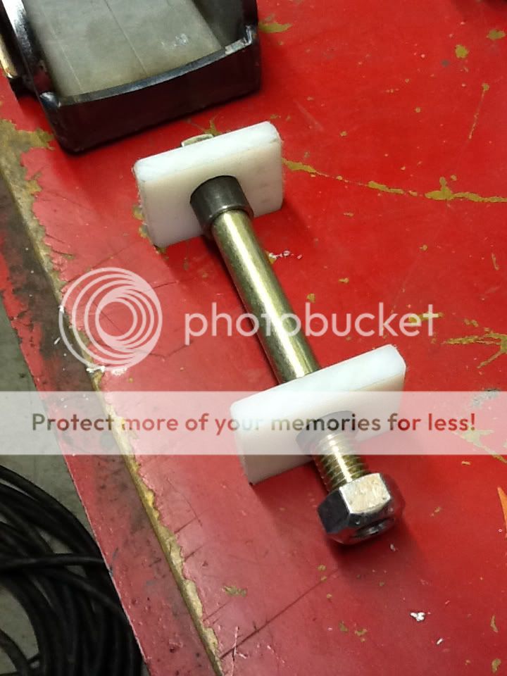

I'll go get some close ups of the sliders and the brackets.
They are beefy for sure, all 1/4 plate with good welds all around. The sliders are very simple so if I decided to play with some different materials it would be very easy to do so.

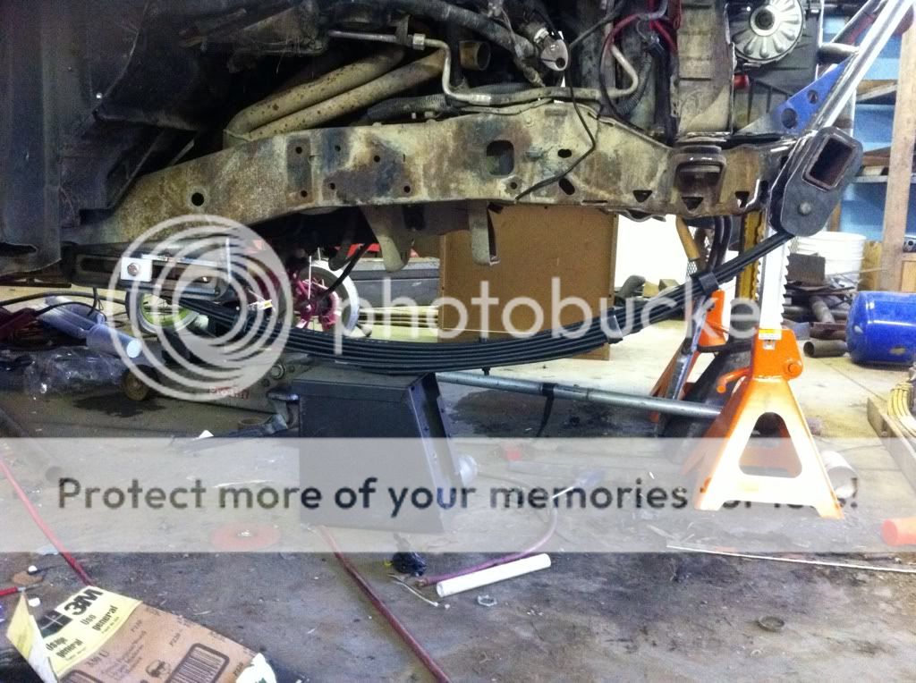

The springs look like the length is perfect, the let me bring the front eye back under the bumper where the don't stick out and still let me move the axle forward. I'm going to have to do a little massaging on the body above the body mount for clearance of the slider but it doesn't look to be any major problem.
i always thought leaf springs were supposed to be as level as possible? or am i just wrong
The slot will be angled down towards the front, the top of the bracket will be level. They are just sitting therein the pics not the actual location.
Uploading some pics now.
Those are really cool. I wander what kind of travel it could give on the rear?
It's supposed to be as good or better, a lot,ore stable and should have lot more down travel since it is not limited to the length of the shackle.
I'm hoping with these and the front mount drenched into the frame I will be able to squeeze 63's under it and stay low.
