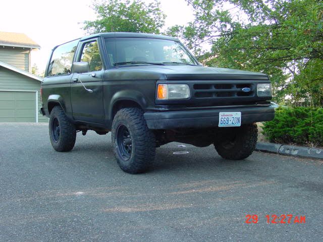

Ive been working out some of the bugs on the truck the last couple of weeks. Also finished spray painting it.
Project El Taco...1990 BII
Not a pro paint job by any sort, but its better than 5 shades of brown and a world map of chipped paint on the side. Plus I can bust out the can of black when I get a scratch!

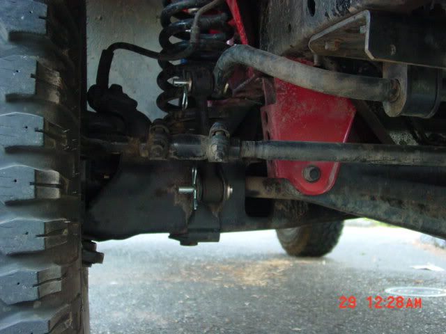

Also here is a pic of my homemade sway bar disconnect-
