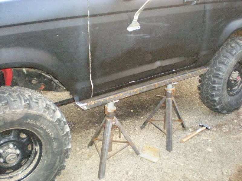

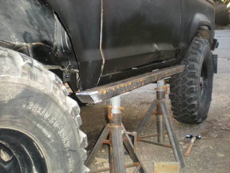

I decided it was time to get to building my sliders, so I started on them today... Ill get some more pics up after they are finished...

Ive definately been thinking I should cut the rockers and tuck the sliders, so thats probably what Ill do. Not gonna do the Boat sides thing though, I dont think its really necessary on this rig, sliders alone should do just fine... Hahns B2 sits just a tad bit lower than mine and his sliders seem to treat him well.
I dont think that boat sides are needed on a B2 either. I have been measuring for my sliders and my sliders will still be 4 inches above the bottom of the frame rails
man your sohc b2 does very well offroad by the looks of it pull the dent put the sliders on it an it be good to go again nice work man any vids of it on the ashphalt giving er
Its when you plate the underside of your sliders to the frame, so it glides across things like rocks and stumps...Think the side of a Boat hull...
Ok So where are you going to mount the rear mount to the frame?
I was measuring again tonight and
I can mount to my rancho radius arm mount for the front,- I will just create a plate to bolt to my mounts on the outside.
then to the frame in the center,
not sure where to mount the rear as the spring mount and the cab mount are in the way.
Im going to bolt a Large piece of angle iron onto the frame inbetween the radius arm mount and the body mount, then im going to run two pieces of tubing to the slider as wide as I can run them and Ill see what it looks like, if there just isnt enough support, Ill run a couple of stringers to the body mounts. My sliders are 54" long, and im bolting a ~2ft piece of angle onto the frame... Im sure I wont get too much action on the front and back parts of the sliders, so I might be fine with the tubing at a 30" separation. Either way, I dont see it being any weaker than bolting them right to the body mounts...
