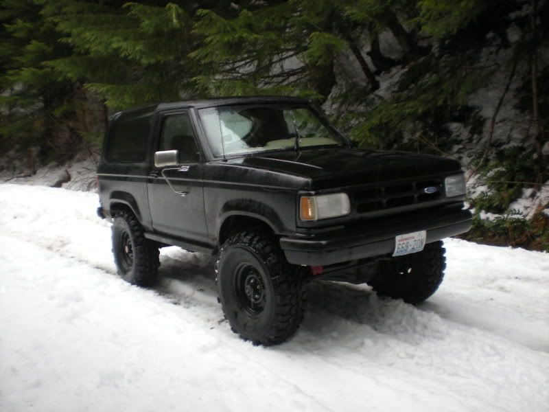

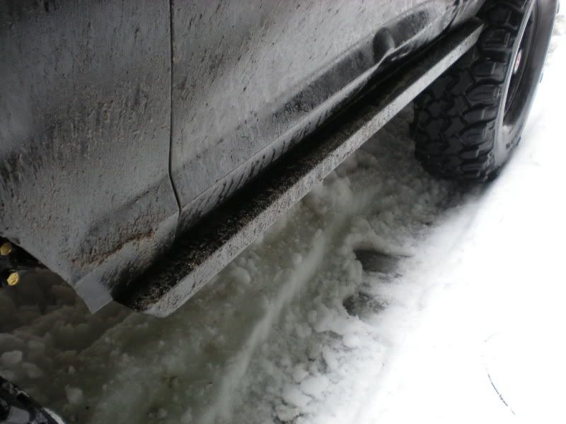

Got my sliders done. Also went and had a little fun in the snow up near the mountain today... It was raining and the snow was slick! Anyway, here is a few pics...
The first pics in the series were before I pulled them off, finish welded them, and painted them. They are pretty sturdy for what they are, and I think they look great.
those things look good man. and yeah, they aint going anywhere
there now you should be able to bounce off trees all you want now lol
Thats for Damn sure... I had to buy another door that will be getting put on soon... and I aint buyin another...
Those look awesome dude, they put mine to shame :icon_thumby:
