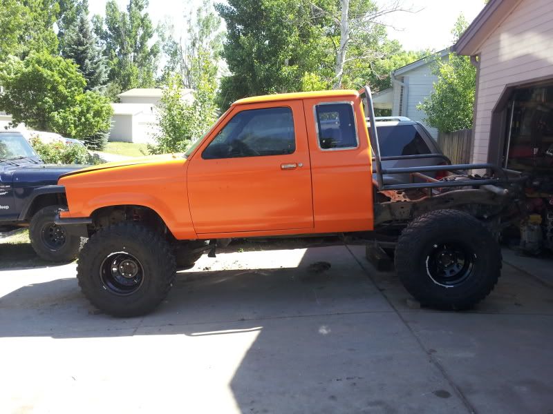

How much did the flatbed cost you overall? I have an 84 ranger 4x4 auto with the 2.8 and I use it for my DD but I still wanna have some fun with it... and that flatbed just looks awesome.
Thanks man took my bumper design on the Merc and used it to inspire my flatbed design. Right now with the lights and steel only at $180 bucks. But I still need some C channel and wood to finish it off. Probably be about $300 total. I sold the stock bed for $250. So I will only have about $50 bucks in the new bed. LOL :icon_thumby:
That's not a bad deal at all.... Cheaper than a new bed up here in Maine.. if you can find one with no rust. I bought this truck about a month ago and it seems all solid except the bed which was backed into :/ So now it's 99.9% bondo and 100% shitty looking... plus the idiot bondo's terrible and it's rusted through LOL. I may find an idion to buy it but I'll just do a flatbed :P :icon_welder:

Got the fuel lines hooked up last night. Picking up the rest of the steel for the flatbed and exo today.
So I got the truck running with the new tank this morning. I hooked it up just like the Ranger was hooked up only it wouldn't start. So I thought maybe the BII is plumbed backwards of the Ranger. So I went to pull Ranger return line off the tank and got a face full of gas. LOL Yeah they are backwards. Once I reversed them truck fired up and purred like a kitten. I will take pic later and to show which side is pressure and which is return.
Got the meats mounted up and almost done with the wood part of the flatbed.

Have to take out the end boards and rip them down. Got all measurements just ran out of time.
