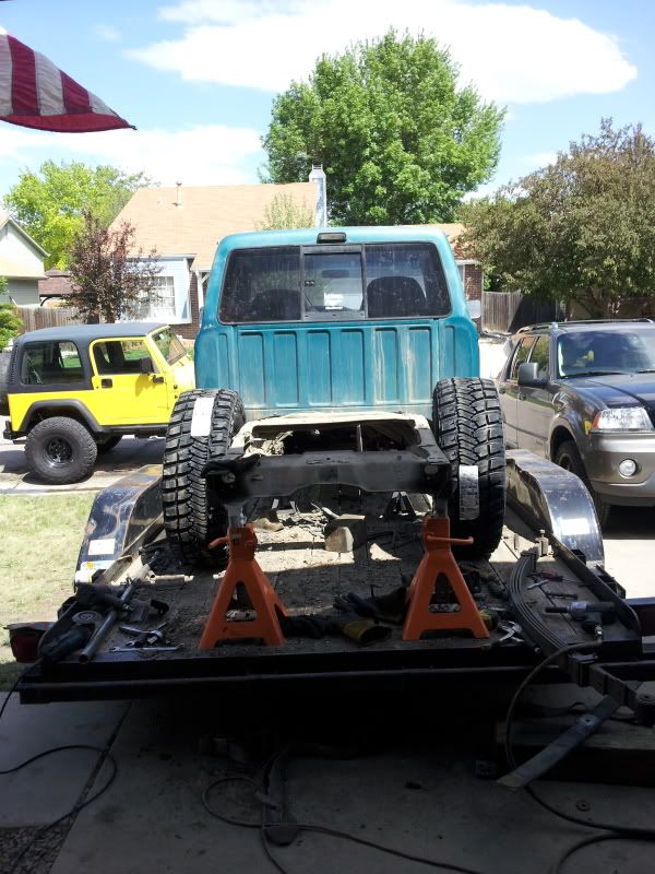

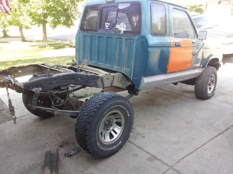

Finally had some time to start on the truck this afternoon.

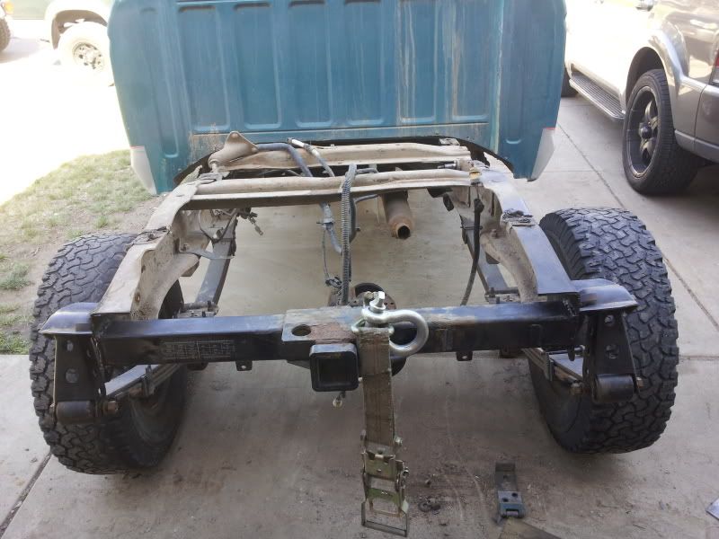

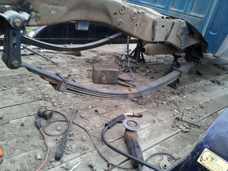

Leaf brackets plasma cut off.

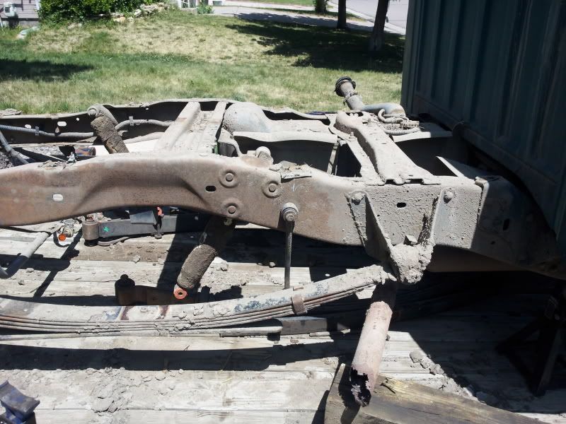

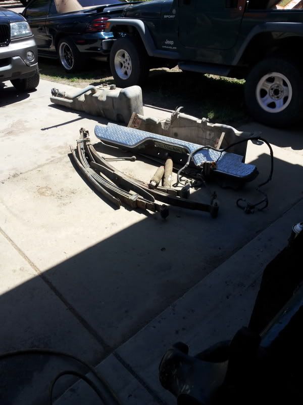

Removed the overload from the Chevy leafs.

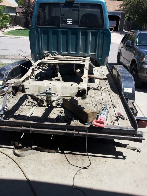

This is the new wheel base.

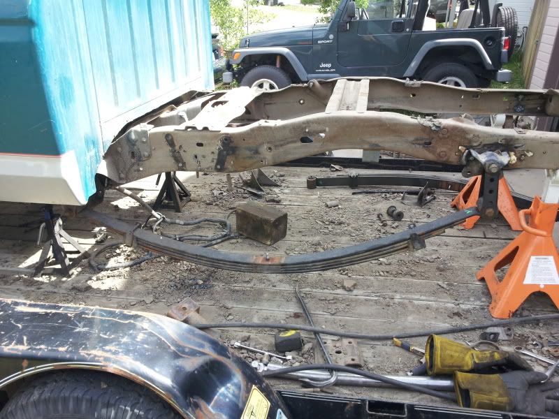

One leaf set.

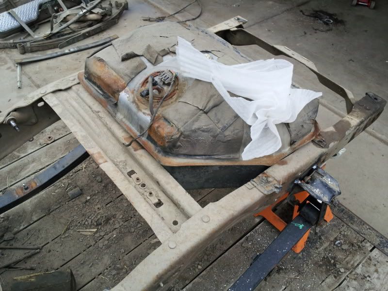

Bronco II tank fits like a glove.

Looking good man. Id add a lil plate to your rear shackle hangers since you have them hanging off the frame. You'd be amazed on how much force is on those things

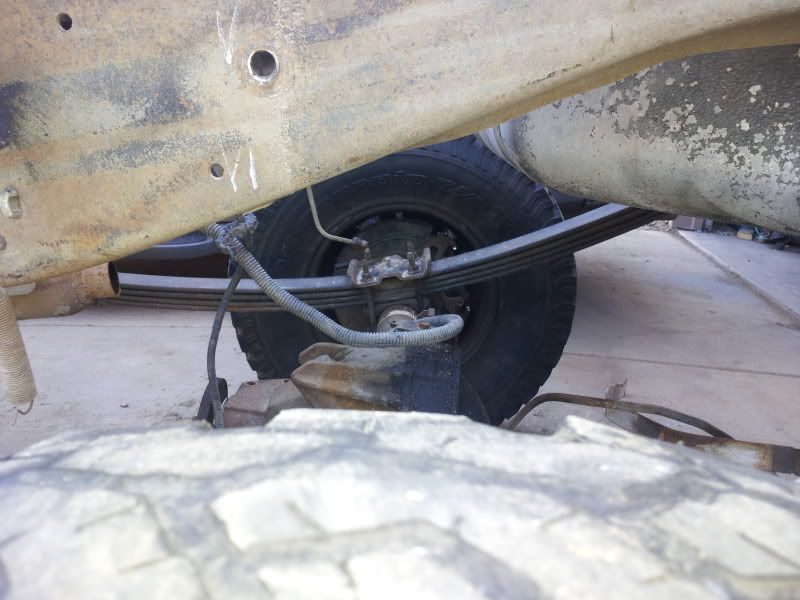

i may have missed this....is that an explorer 8.8 in the back?
Thanks boss!:icon_cheers: Yeah I haven't decided how I wanna brace those rear shackle mounts I was thinking I might land the exo cage on the hanger some how so I am holding off on that until I start the flatbed. I need to order the DOM for the cage might do that tomorrow.

Oh yeah that is an Exploder 8.8 with discs in the rear. I plan on leaving the lower perches they work good as a U bolt skids. Going to build some anti-wrap perches to the top. Normally I add some lift to the perches by making them taller but not sure if I want to this time. Cause the front has a 3 inch lift on it now and the rear is already 5" taller as it sits. Hoping the weight of all the other parts will make the rear settle down some. Plus parking the truck on level ground should help too I hope. I think I will winch it off the flatbed today and see how she sits. Plus working on the flatbed is real PITA! :D

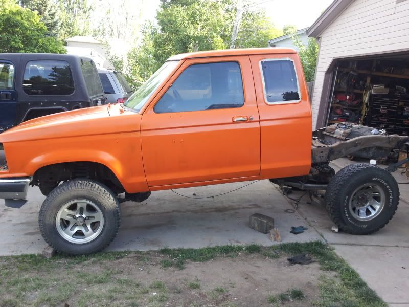

Had a friend and my son help me work on the roll on paint job today. Two coats down 4 more to go.

Actually it is Safety Orange from Team Rustoleum. :icon_thumby:
