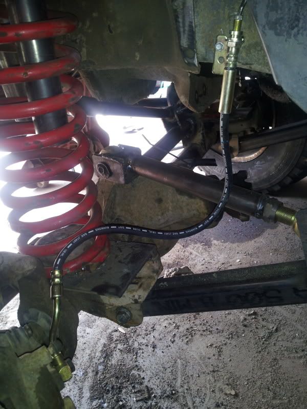

Got my brakes plumbed on the front and rear.

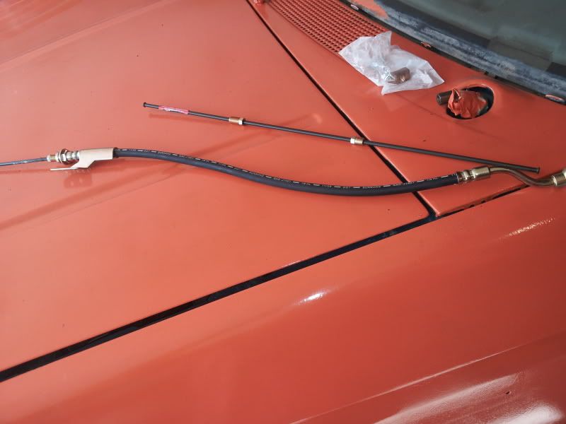

Fronts I used Chevy truck lines they cost about 15 bucks each. You can see all the part #s on the bag.
Project Double R...
You will need a 16-20" line for the drivers side and about the same pass since you have more the lines to back side of the coil bucket. Drivers side you will need 3/16" T and Pass side you just need coupling.
Project Double R...
And BAM! Less then 50 bucks later we are in business. These Chevy lines work great cause they are longer then most stainless and will stretch some if needed. Plus you can't beat the price.
Project Double R...
Rear I just used the stock Explorer lines so nothing fancy to see there. :D
Rolled it outside brakes work good.

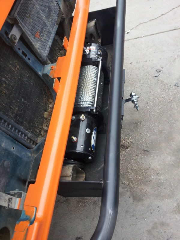

New winch...

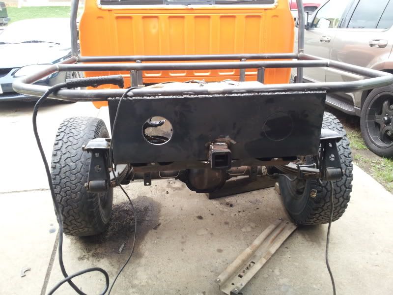

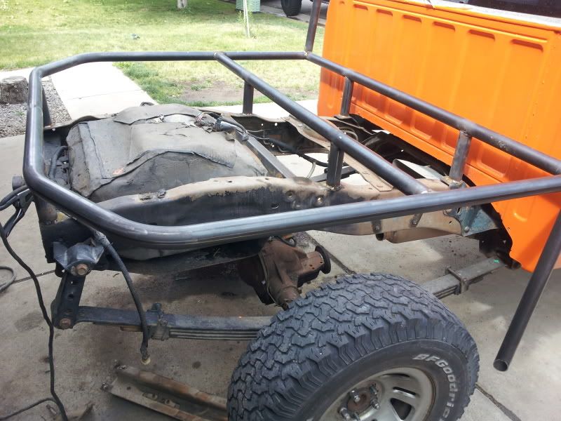

Picked up the tube for the flatbed, sliders, and should have enough for the front bumper. The exo cage steel should be here Tues had to order it.
Project Double R...
It's lookin pretty good man! Keep it up.

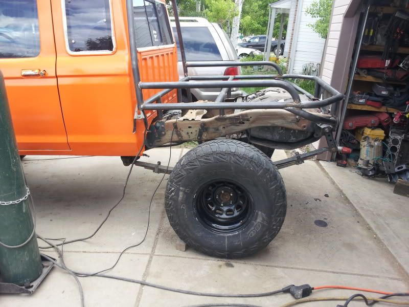

Thanks boss! Last night I got all the measurements figured to keep the flatbed level with the truck. Since I cut off the rear bed supports I had pull a string line off the bottom of the cab and measure to a straight edge across the end of the frame.
Flatbed pics! It rained most of the day so it slowed me down a lot.

Now I need to build the sliders. Going to tie the flatbed roll bar into the sliders. The cab exo will land on the sliders too. Then I need to get the front bumper built so I can tie the front exo into the cab part. I can't wait to get it done. Going to be sweet!

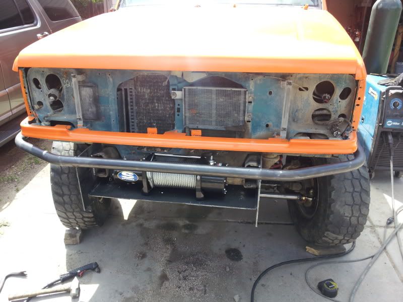

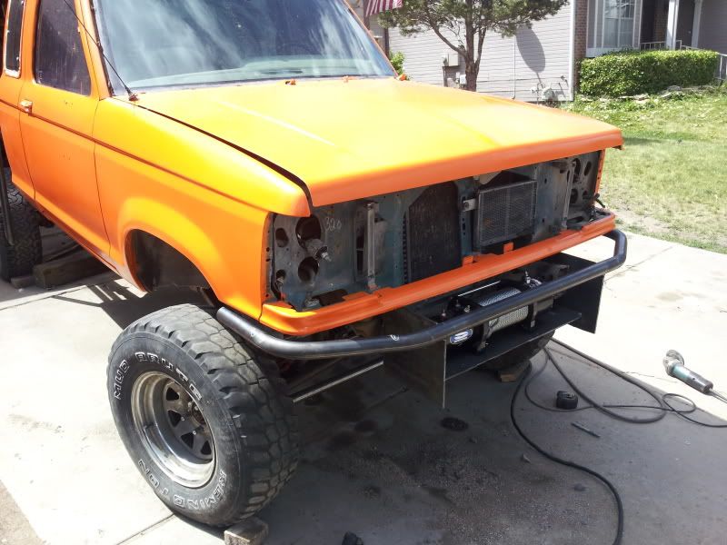

Got some bumper work done on the front!

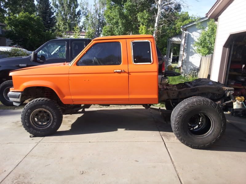

More pics and a couple with 35s on there rear. I need to get the new meats mounted up!
