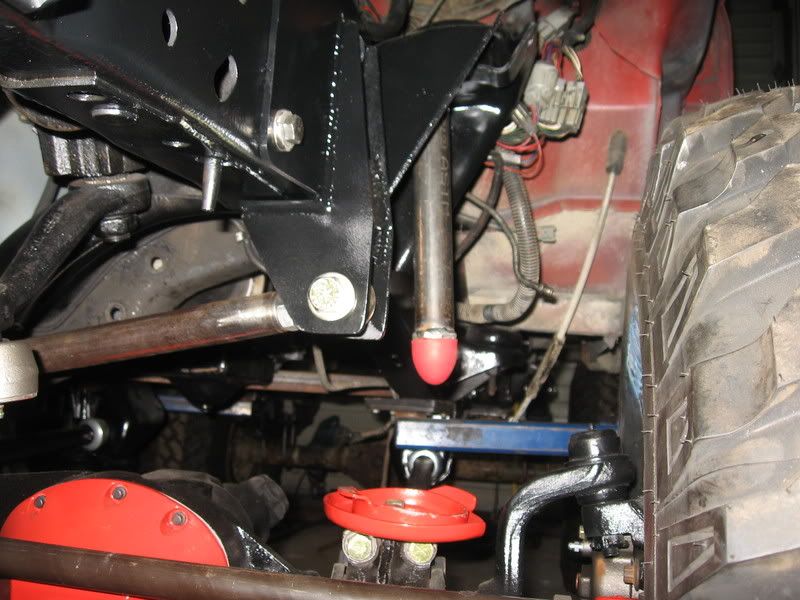

The coils will both be angled in a little bit, thats just the way it turned out. The lower springs buckets are as far apart as I could get them on the axle. Had I been able to spread them apart another 1" or so there probably wouldnt be any angle to them. Im not worried about a little angle anyhow. I've seen other rigs with more angle than im running and they work just fine. In the pic the passenger side is way angled in because the suspension is for the most part unloaded and the axle is shifted to the driverside. Once its down at ride height it wont be near as bad, and the steering and trac-bar angles wont be as severe. Im sure I also have some adjusting to do my trac-bar.
Ahh ok, I kinda noticed there wasn't much room on the knuckle side of the coils. But if it works, it works. Looking good, I like it. :icon_thumby:

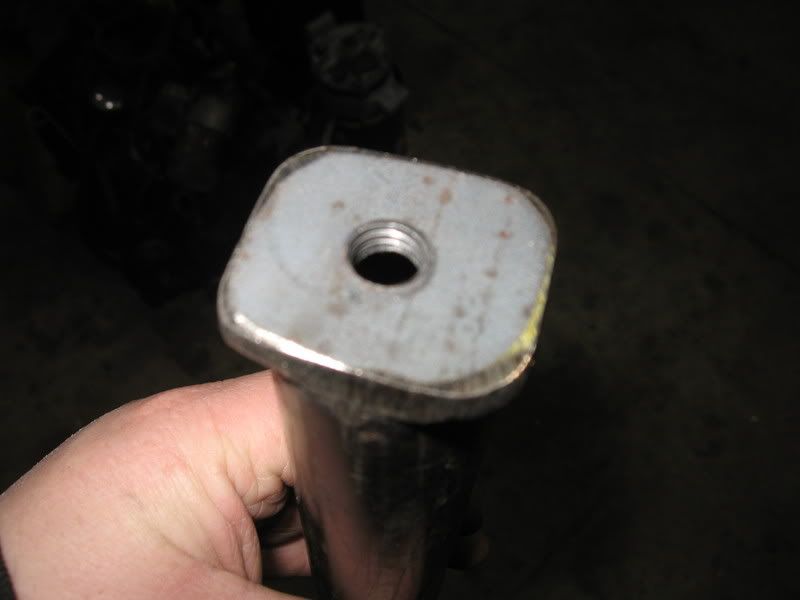

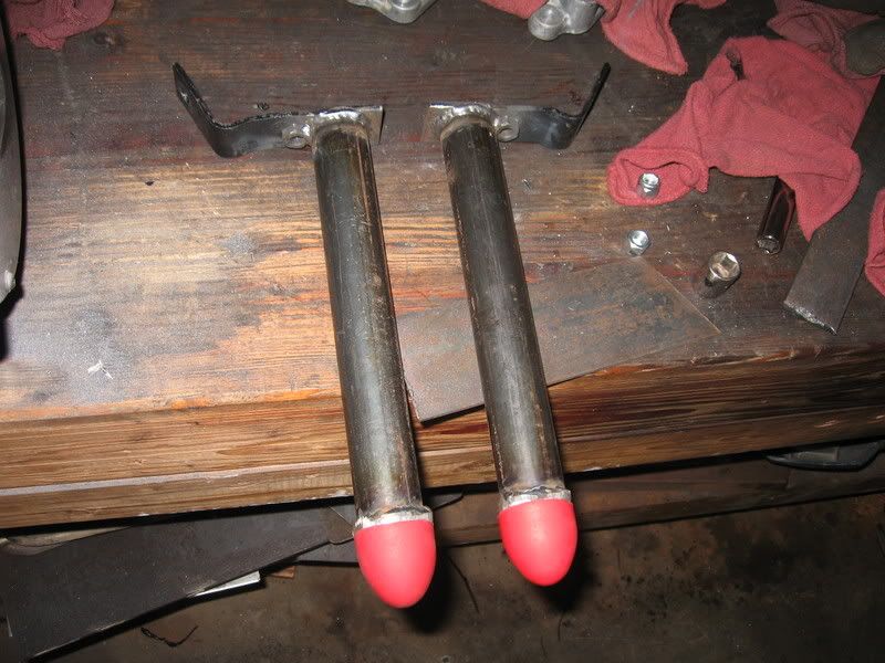

Built my bumpstops. I used studded universal polyurethane bumpstops from energy suspension and some one inch schedule 40 pipe. Capped off one end and drilled/tapped a whole for the stud. Attached them to my stock coil spring retainers. Worked out pretty well, now I have about 3/4" before any metal to metal contact with it resting on the bumpstops.

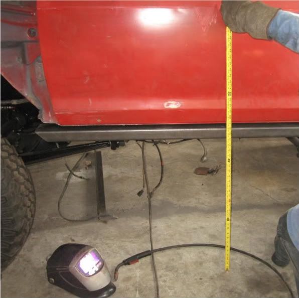

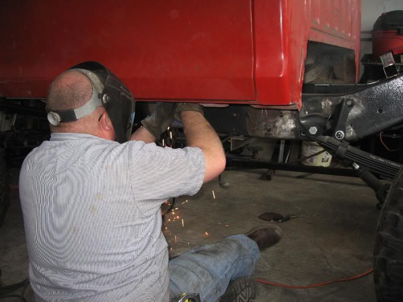

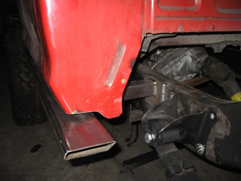

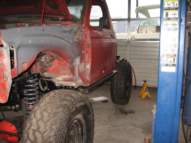

Had a friend stop by today and help with some stuff. Started building my sliders, which eventually will tie into the cage.
First order of business was chopping the rocker panels:
Project B2R

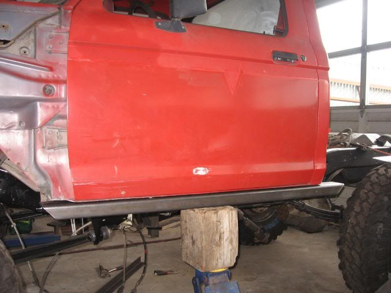

Mocking up:
Project B2R
Installation:
Project B2R
Project B2R
Project B2R
Project B2R
Project B2R
Project B2R
Project B2R

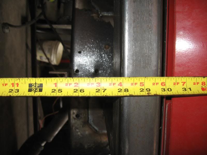

I plan on throwing some gussets on there but just didnt get around to it today. I plated the frame with 1/4", the 2X2 is 3/16" and the 2X4 is 1/8". I'm going to plate the bottom of the 2X4 with 1/8"x4" flat bar. That way I'll have a good solid piece of steel to slide on without the weight of 1/4" wall 2X4.
