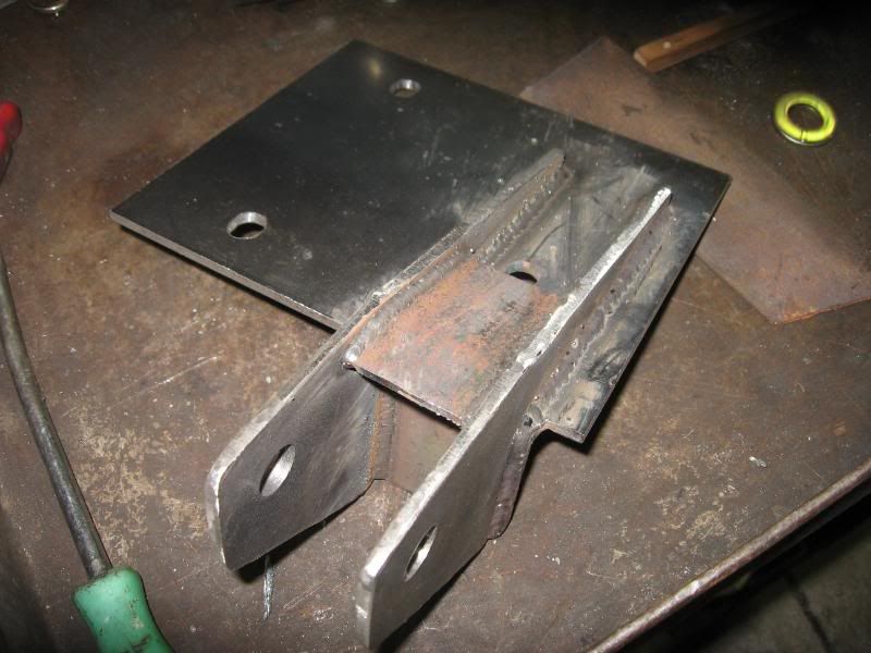

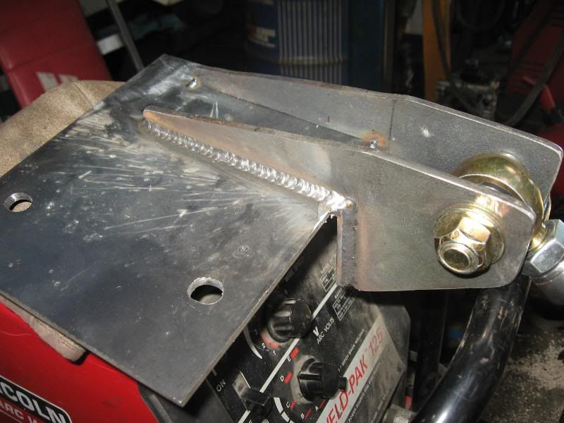

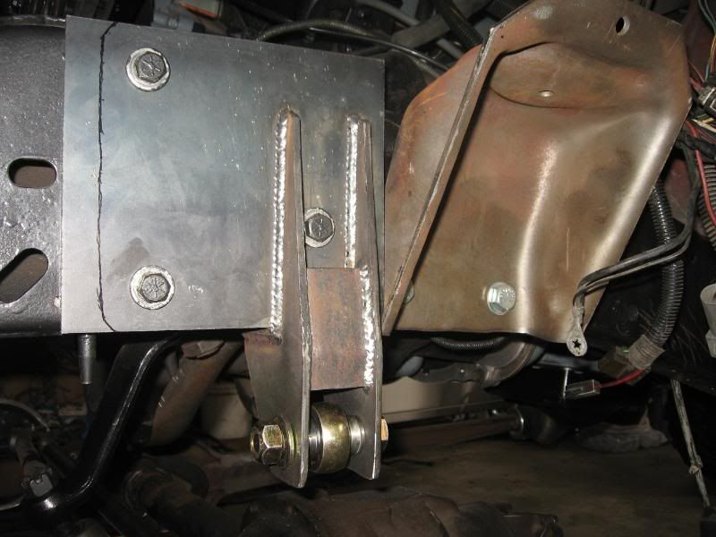

Updating because I haven't in a while, but I'm actually working on it now. Here is the frame end trac-bar bracket I fabbed last weekend. It uses the steering box bolts to mount. I'll probably run another brace off it to the engine cross member. Haven't decided for sure yet though, it's pretty stout as it is.
For the trac-bar itself, I'm using a 3/4 heim joint on the frame end and a Ballistic bushing on the housing end. A chunk of DOM tubing fill the gap between them.

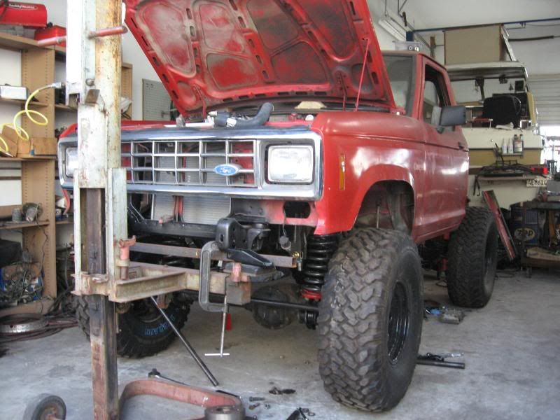

I plan on getting the axle end trac-bar braket fabbed this weekend. After that, I'll pull the D30 back out, wire wheel it, paint it, install the Aussie locker, new diff cover and throw it back in. I did take a pic of it supporting its own weight the other day (the bumper jack is being held up by the C-clamps :thefinger:).

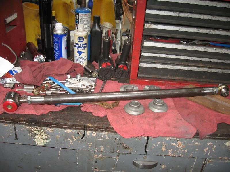

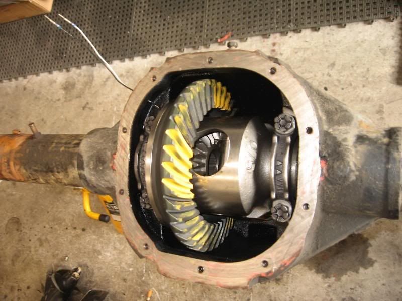

Got a few things done on saturday. Pulled the carrier on the D30, installed the Aussie locker and then re-installed the carrier. My trac-bar is cut to length, welded up and finished. I fabbed up the lower trac-bar mount and tacked it on the axle. I'll probably finish burning it on after I pull the front end to paint it. I ended up reaming out my stock pitman arm and replacing the 4" drop I had on there because I wouldn't have been able to to get my trac-bar angle to match it with out a bunch of extra work.
Finished trac-bar.

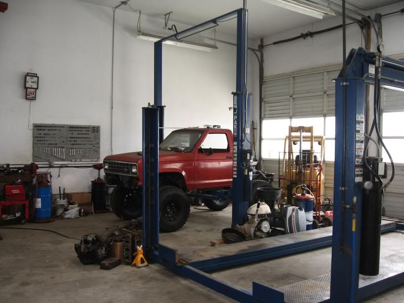

This past week I've been waiting for parts to show up so I did some cleaning and removed the big fawkin' boat behind my truck. Not only did I gain a bunch of room to work but I was also able to roll my truck back and put it on the lift.

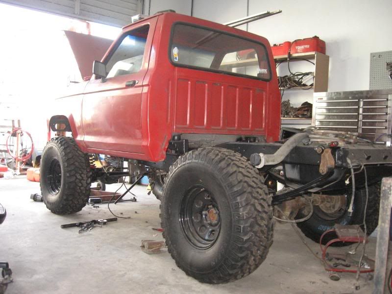

All torn apart again! Getting everything painted up and waiting on some u-bolts for the rear.
I hate looking at it like this, but it's the last time it will be apart (until I break or upgrade)

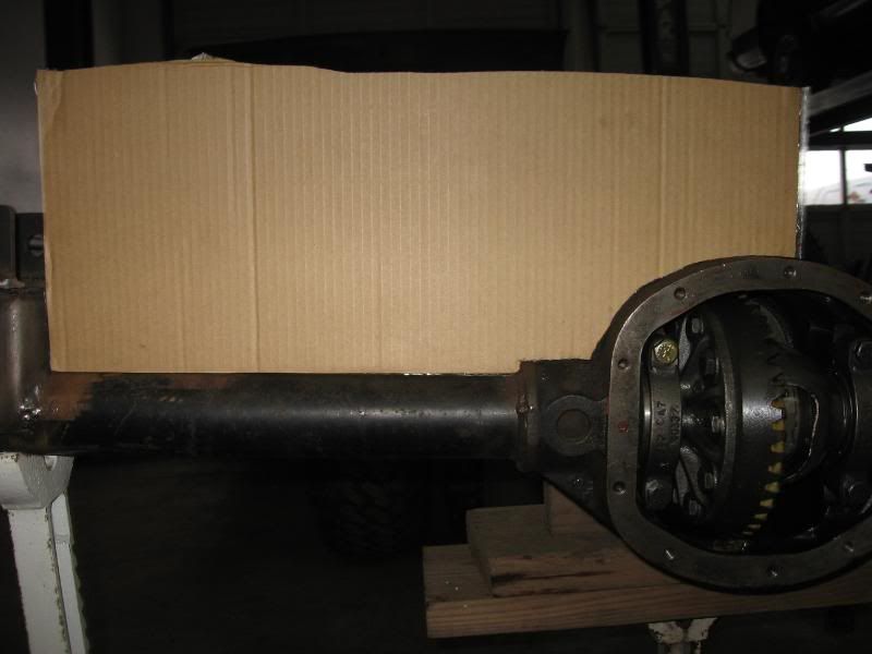

While the D30 was out I decided to add a truss. I had some 1/4"X5" flat bar laying around which worked out great. Making a template out of cardboard:
After a little work with the plasma, grinder, and welder I ended up with this:
