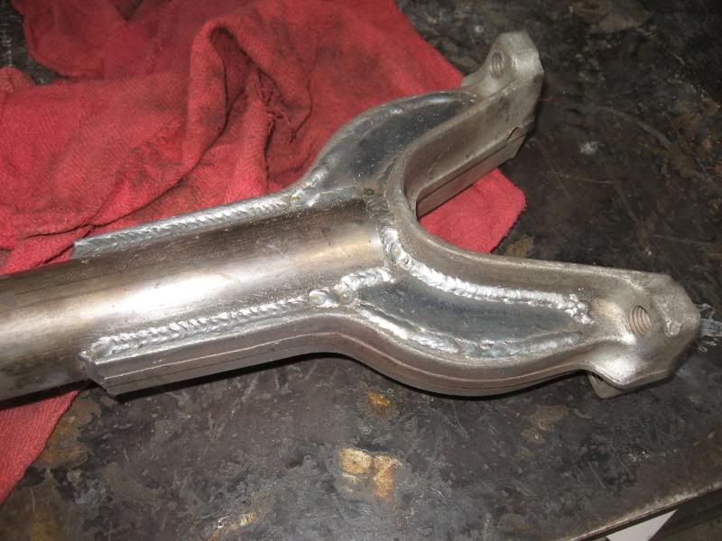

New arms (2"x0.250" DOM) welded up and boxed in
