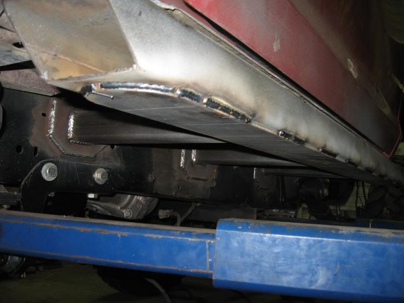

Good work on the sliders. I was gonna say you're gonna dent the hell outta the 1/8" stock but then I read you're gonna plate the bottom - good idea. Excellent craftsmanship, keep it up.

Ended up plating the bottom side of the sliders with 3/16"x3.5" flatbar. I think I'll have to work pretty hard to dent them now.

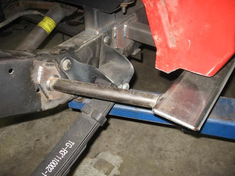

I also ran another brace into the frame on the rear of the sliders. It stiffened the sliders up tremendously, I'm going to do the same of the front of the sliders.

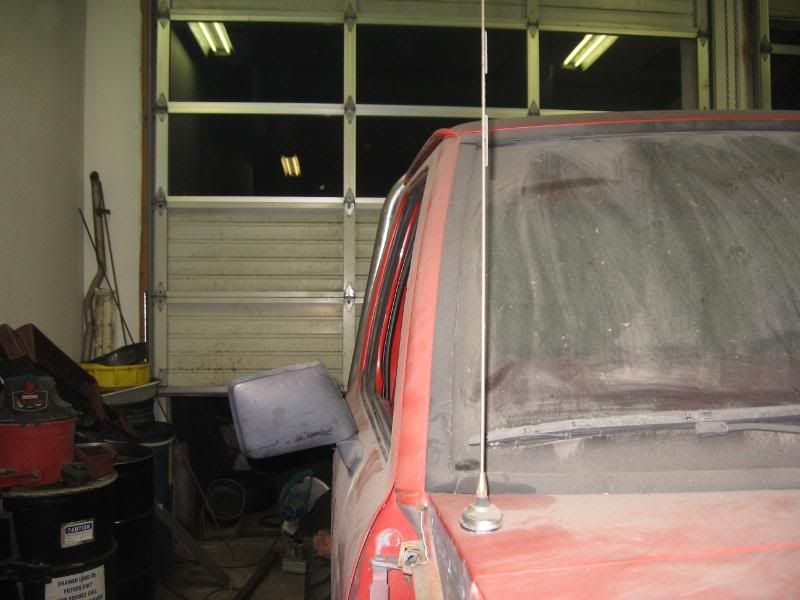

On a side note I picked up this pile for free today. Going to gut it and send it to crusher this weekend. It's got some of the odds and ends I need to finish this thing up. I'll also be keeping the doors, hood, fenders, tranny, and t-case for spares.
