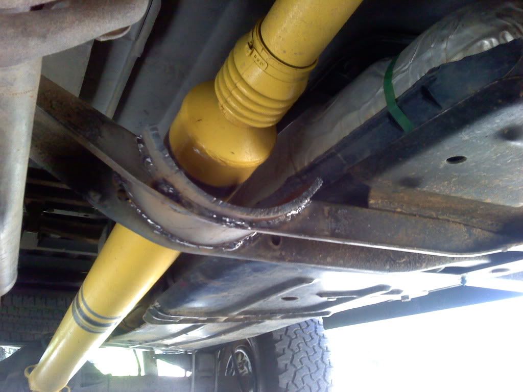

After installing the new leaves I find that my one piece driveline rubs on the middle most crossmember so that will need to be addressed, but for now about 200lbs of scrap steel in the bed allows it to be driveable.

Oh, and I forgot to mention, you had said something about your driveshaft contacting your mid cross member? If its the one that the carrier bearing used to be on, just remove it. I cut mine out when I did my 1 piece drive shaft swap. Its not needed.

Well there is an article in the tech library about the 1 pc driveshaft swap and it says to not remove that cross member as its a structural part of the frame...but to me it seems like the truck could live with out it as it has an additional crossmemeber in front and behind of that one. It just says to re-locate it farther forwards I think. Not sure what to do about it.

haha yea, the bilsteins are great. Ive got front and rear hitches, and not to mention all the other cross members on the frame. Myself and few of my friends have removed it. I beat the living crap out of my truck, and theres nothing affected by removing it.
just axe the carrier bearing crossmember, like you said there are enough on the frame already and its just in the way. I did the 1pc driveline swap like 4 years ago and i've been running without it since then. there are no cracks in the frame and it doesn't have any more frame flex then it had before the swap from what i've noticed.

Here is an excerpt from the article:
"If you have a suspension lift taller than 4" installed, you will also need to either move the entire crossmember forward some (drill new holes, reattach with bolts), or notch the center of it for clearance. This is so the shaft doesn't contact it (and possibly get dented) when the rear suspension is fully extended.
Complete removal is not recommended (it is a structural frame component)."
But if you guys have done it, it would be a whole heckavu lot easier just to sawzall that sucker out of there and call it a day.

Today my dad had a genius idea about what to do with the crossmember that was rubbing on my driveline. Instead of cutting it out, we torched a circular cross section out of it just below the driveline, and welded in 1/3 of a piece of 6" pipe. I'll post pictures soon as a picture is worth a thousand words...
So here is how I fixed my driveline rub:

Still needs some work, but for now the load bearing abilities are back to what it was (or better maybe?). The welds were hard to do but got plenty of penetration. Strength-wise its fine. Need to still clean it up a bit with a wire wheel/grinder and take it to work and put a nice MIG cover bead over all the seams, and paint.
