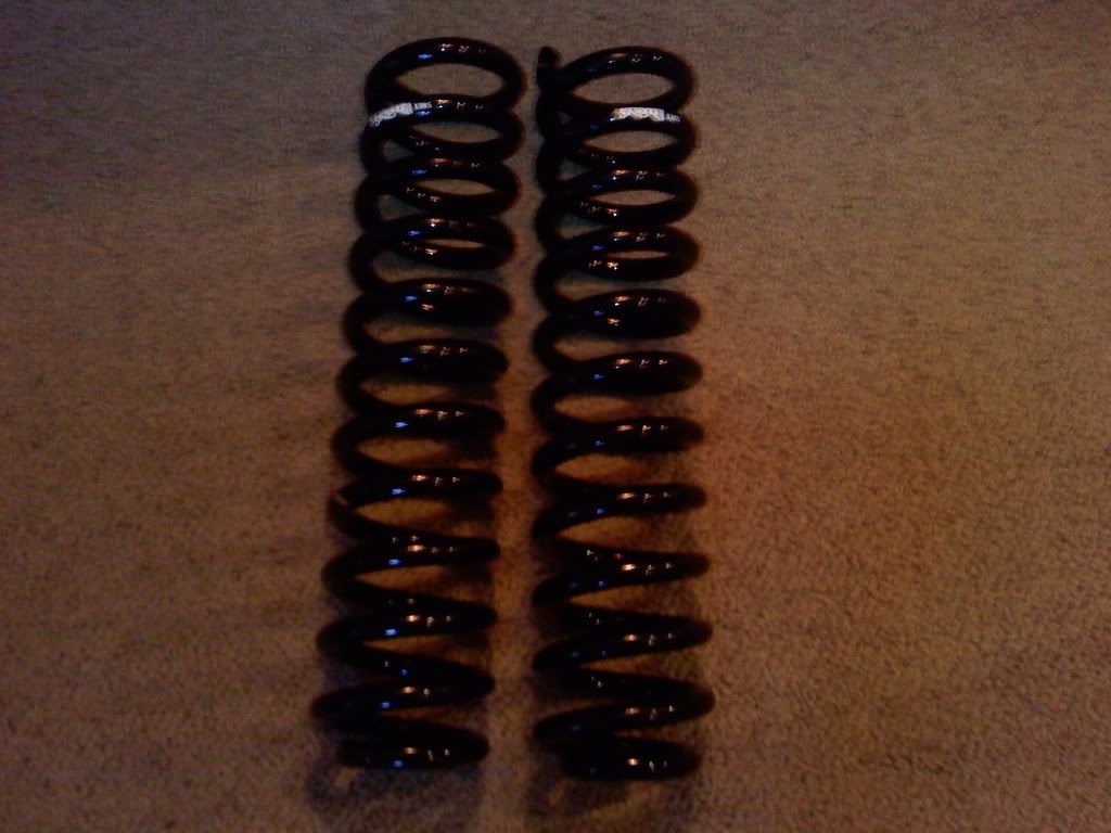

And here is a informational tid bit, my current Tuff Country coils have 11-12 windings depending on where you start to count them, and these new SJ coils also have 11-12 windings. Interesting.

The skyjacker 8" coils are by far flexier than any other RBV coil. Plus they provide a true 6" of lift on a supercab.

It won't be a 8" of lift compared to stock (more like 6-6.5" with my trucks heavy nose). And yes the SJ 8" coils are the softest of what skykjacker offers for RBV.

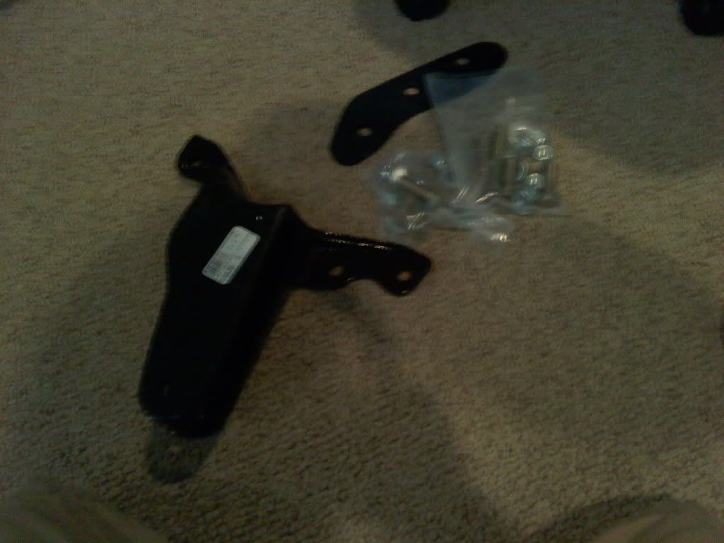

MMmmmmm Beefy. They even sent me the little third pc that goes on the engine cross member as extra plating to spread out the forces, even though I only paid for the Class I pair. How nice of Skyjacker:

Skyjacker gets the award for beefy brackets....all the hype I've heard here on the forums is very, very true. The bracket for the drivers side beam makes my Tuff Country bracket look like some-one made it in their garage...:icon_rofl:
Came with hardware, and a "Skyjacker" Decal too :icon_thumby:
