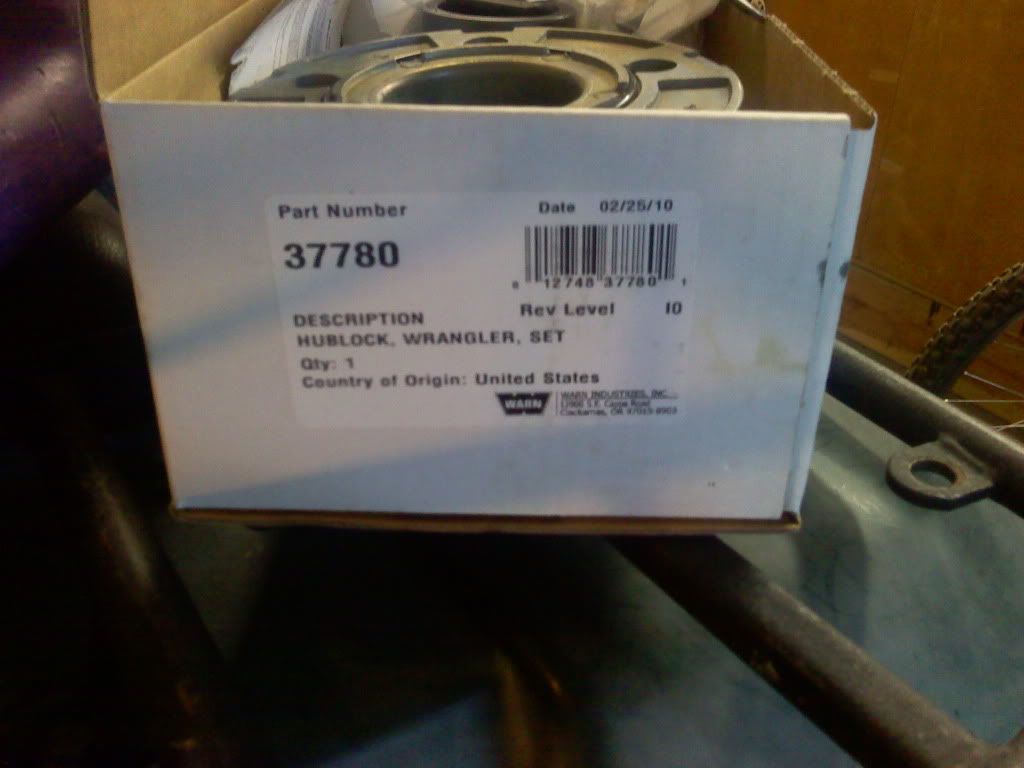

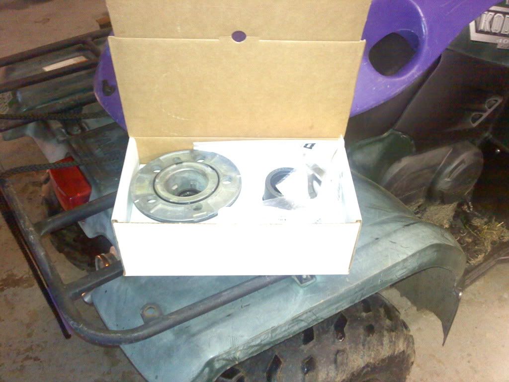

Jeep heavy duty upgrade manual hubs ordered and on the way. Will post pics of install within the next 2 weeks or less.

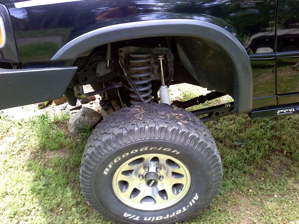

I may do tires and regear this summer if my work stays steady. But for the short term future I want to cut up my coil buckets and add in f250 shock towers and bilstein 5100's. As well as Skyjacker 6" lift coils. Im hoping to pull somewhere in the realm of 10-12" of reliable, usable travel.

What do you guys do to extend the front bumpstops or what bumpstops do you buy that are longer???
F250 shock towers, 6" skyjacker springs and stock front bump stops, never had a problem.
Then maybe I won't bother with bumpstops....Those pro comp air bumpstops on trsfab are pretty cool though :icon_thumby:
Picked up a set of 4" Skyjacker leaf springs to replace my AAL, 2" and stock leaves. Installed past weekend, and they ride fairly nice, though not shockingly better (which was what I was hoping for). Sits about 1" taller than before, though some weight in the bed fixed that real quick....Shocks are on the short side, so I'll be ordering some longer Bilstein 5100's hopefully within a month.
