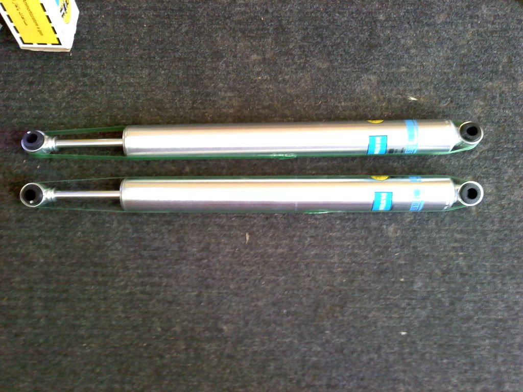

Look what came in the mail today:
Install pics and opinion on how they ride coming soon.

Those the 5100's or 5125's?
They look purdy. I have a set of 5100's headed my way.
5125's.
$151 shipped to my door from the "shockwarehouse.com"
That's where mine were ordered from. Good place for shocks.....
Yes they are, I'm gonna order my next batch from them for sure.

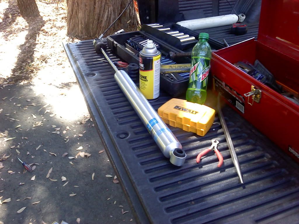

Ok went for a day trip today and clocked 300mi on the new Bilstein 5125's and they are by far the best shocks I've ever owned. They ride exceedingly good over all type's of pavement (no dirt testing sorry). Best money ever spent on shocks and a welcome change from my old Rancho's. :icon_thumby::icon_thumby::icon_thumby:
Together with the skyjacker softride leaf pack my truck now rides comfortably without jarring my teeth and rattling my brains, while still maintaining a firm, controlled feel.
Definitely going to run them over the front axle when I get the chance.
Looks good man. Are those the 12" or the 14" ? I have the 14" 5150's on the rear of mine. Good job.
The 14" travel ones, which are a little on the long side but if my measurements are correct they'll be fine.
