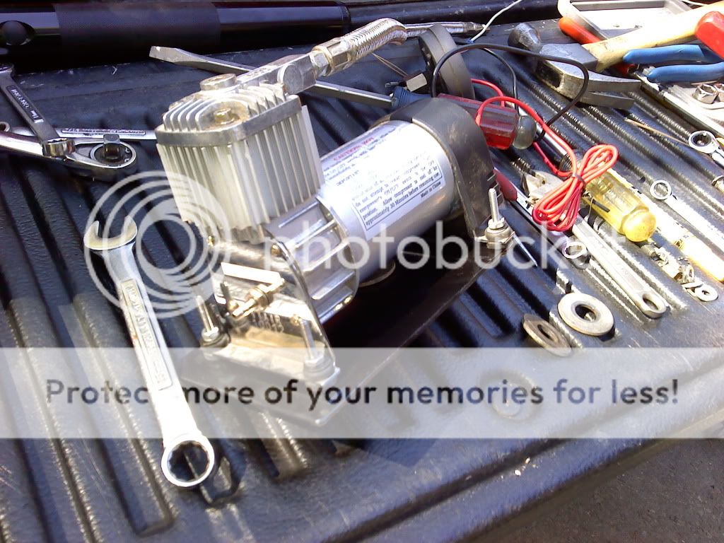

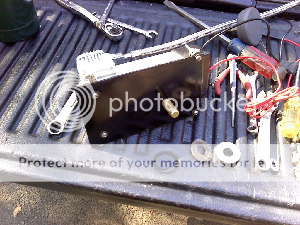

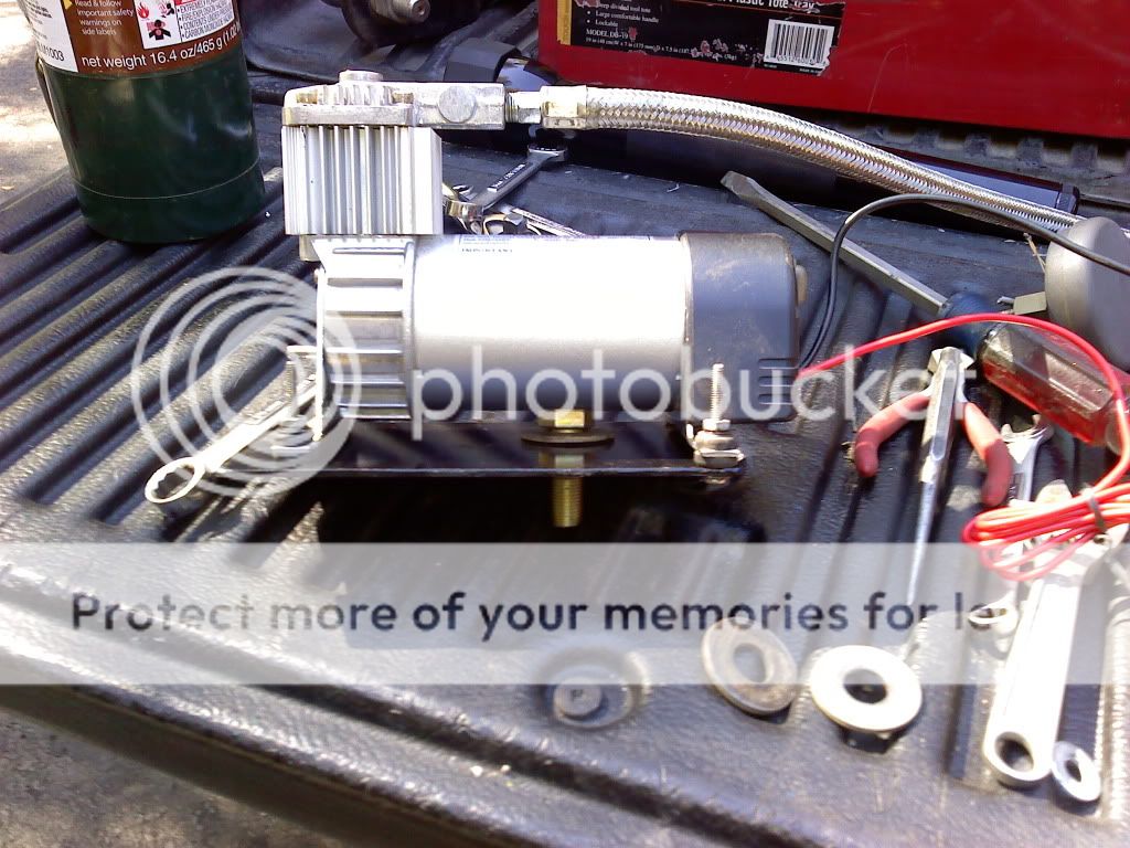

Here are 3 pics of how I mounted the commpressor to the inside of the passenger's frame rail.
Project 4x4 Commuter Mazda

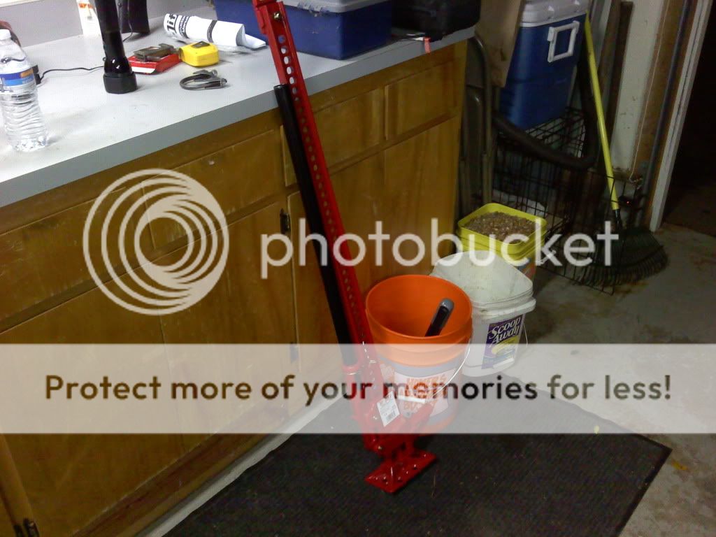

Not really a mod, but I bought a high lift. Where should I put it?
I have four options:
1) On roof bars (don't know if I can park in the garage at school with it)
2) On top bar of front bumper (reducing visibility, common spot tho)
3) Bottom bar of front bumper, below lights (also easy an easy mount)
4) In the bed (least favorite)

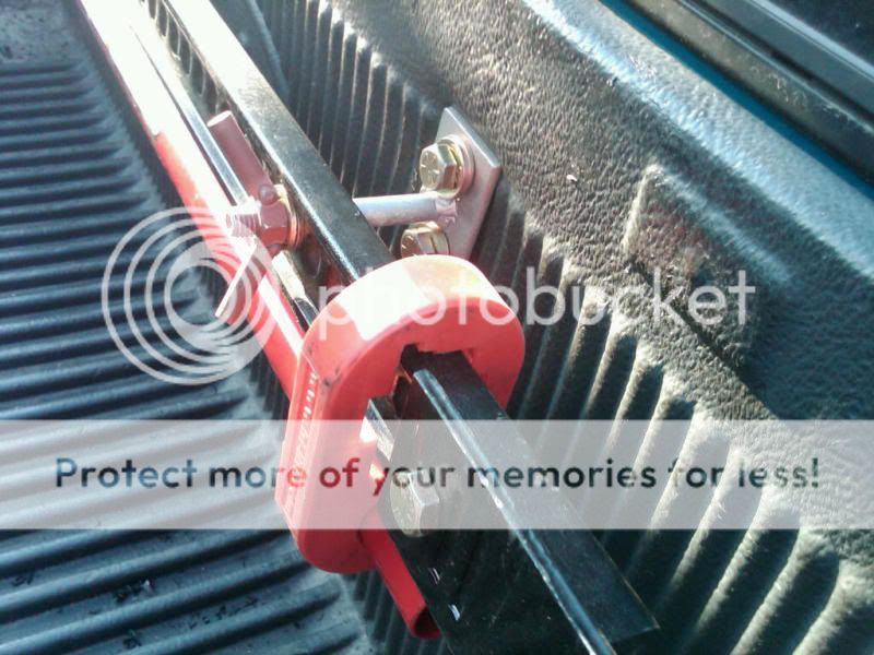

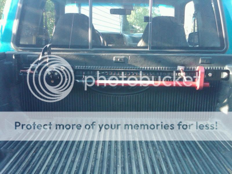

make a mount like I did, it works awesome here, and gives me a place to tie down dirtbikes and different things.
yeah thats a good place actually. have any pics of the mounts themselves?
i wouldn't mount it on the lower part of the bumper...
on top of the bumper would work....
in the bed where it is away from mud and rocks is where it belongs....
l8r, John
hey the brackets are just pieces of 1x2 quarter inch plate with a hole top and bottom, with a bolt welded to it. I welded a washer on the bolt to stop teh jack from sliding back further. I made wingnuts by welding some round bar to the half inch nuts. I made plates for the back side of the bed, to distribute the load, and just bolted it through.
its sturdy enough that i can stand on it, and Im 230 lbs.
