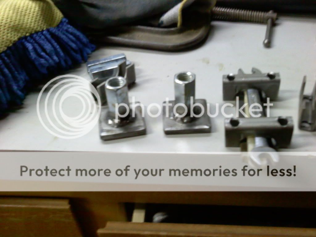

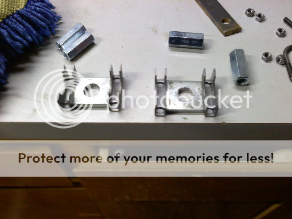

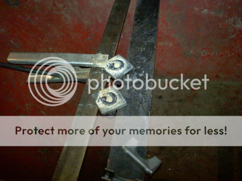

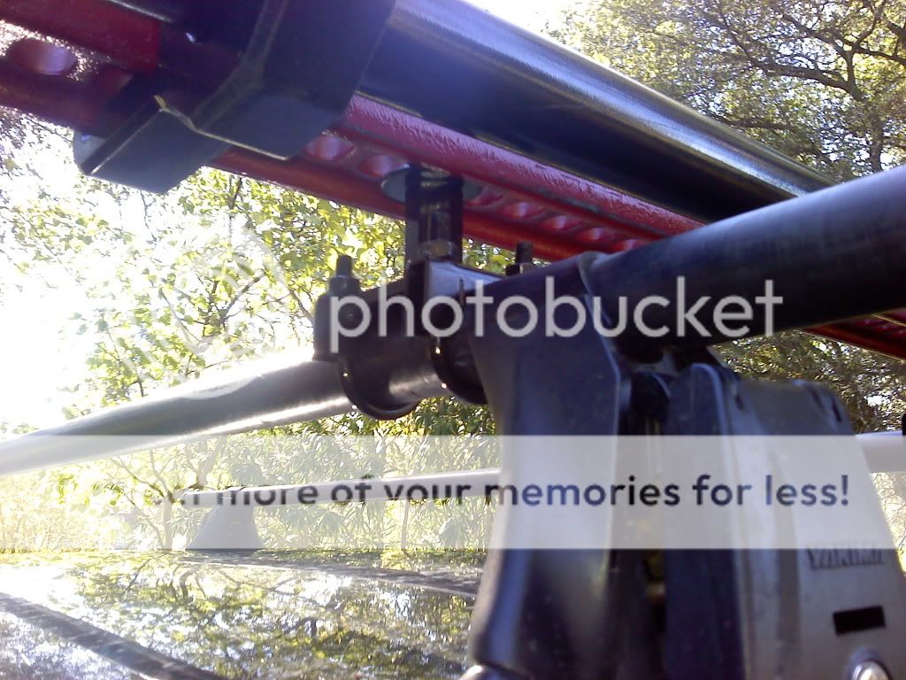

K I decided to put it on the roof, stopped by the hardware store and bought some rod couplings and 1" mini exhaust clamps. :icon_welder:
Alright its mounted [the high lift]. I'll post pics tomorrow. Its below freezing and dark so I'm callin' it quits for tonight.

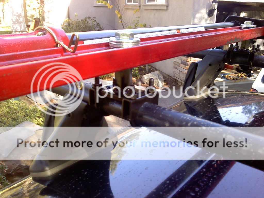

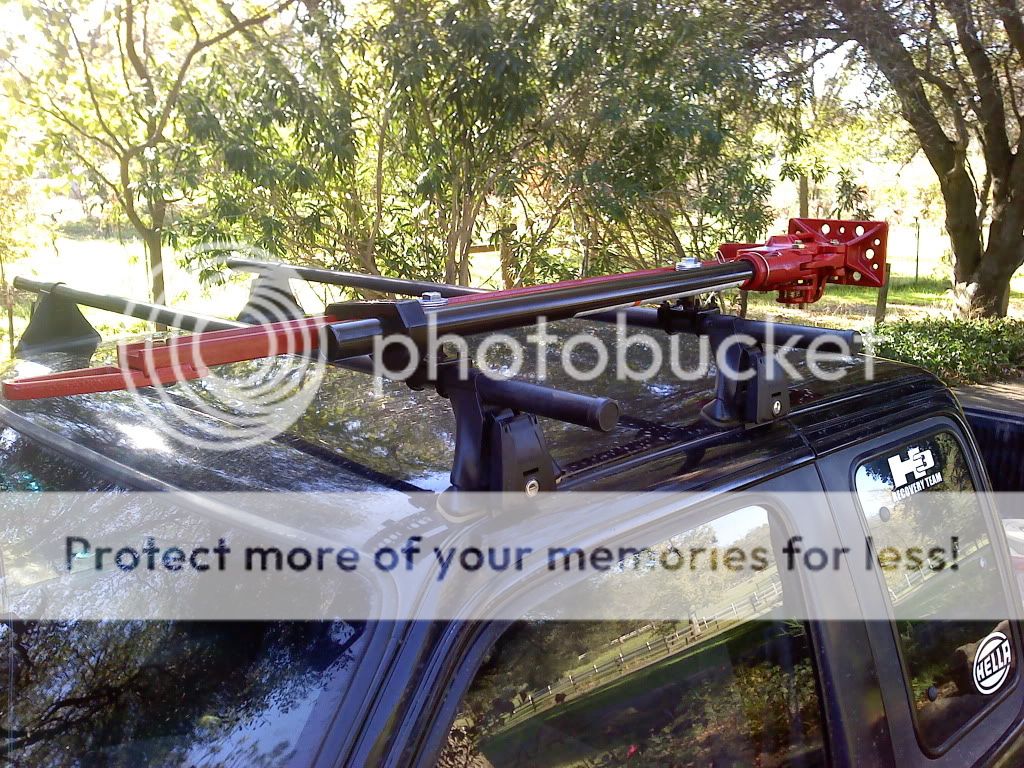

Here is the finished product. Still need to buy some kid of flexible lock to ward off thefties. And later down the road I'm gonna exchange the bolt for a piece of all thread that I will weld into the rod coupling, and use a big homemade wing nut instead.
Its extremely sturdy, just in case anyone was wondering :D

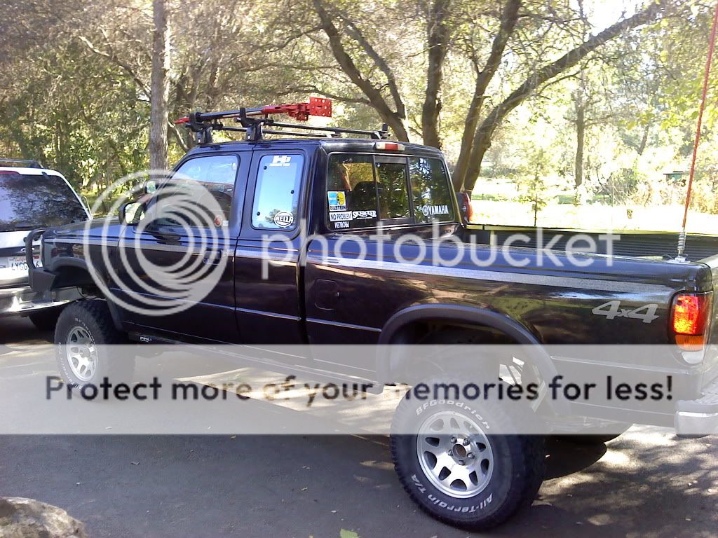

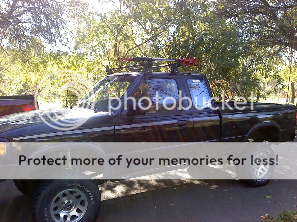

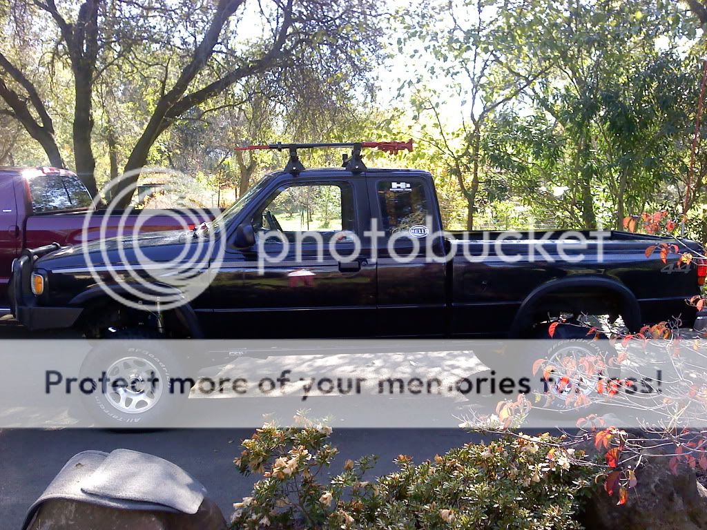

looks good, pics from afar?
Pics from afar-ish:
Truck sits at 6'-9.25".....parking garage is 7' or a tadge less sometimes (my radio antenna hits). I have about 2.75" room for error lol.
not after you get bigger tires
jack mount looks good, nice work
Yeah I know...I'll have to park in the flat lander parking spots.....a mile from class lol. Maybe I'll take my bike so I don't have to walk.
So my 31's measure 29.5" right now, and according to BFG their 33's stand at 32.8" meaning overall height will increase by 1.65"....putting me at just under 7'. No room for error their.
could you mount the jack on the bottom side of the bars?? i think it'd look better.
