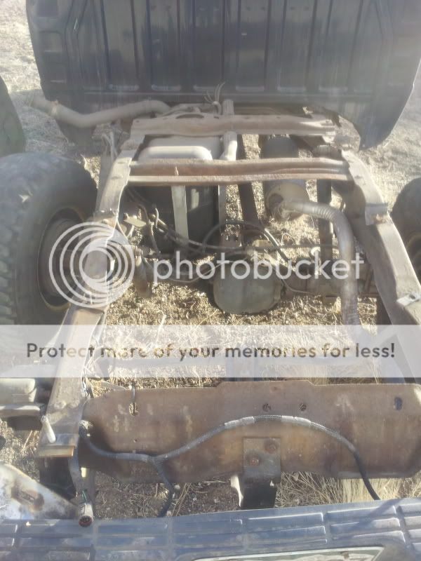

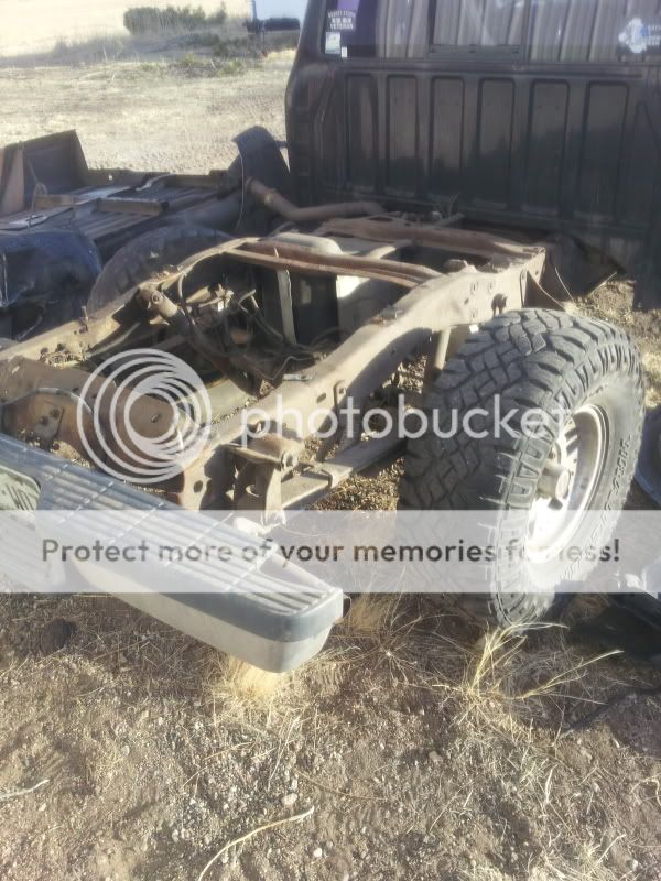

Double R 2.0 picked it up today. Double looked lonely so I picked up a friend today. 2.0 will be getting built a little different then his Orange friend. Still flatbed though. LOL Truck is 93 Super Cab 4.0 5 speed 4x4 electric shift.

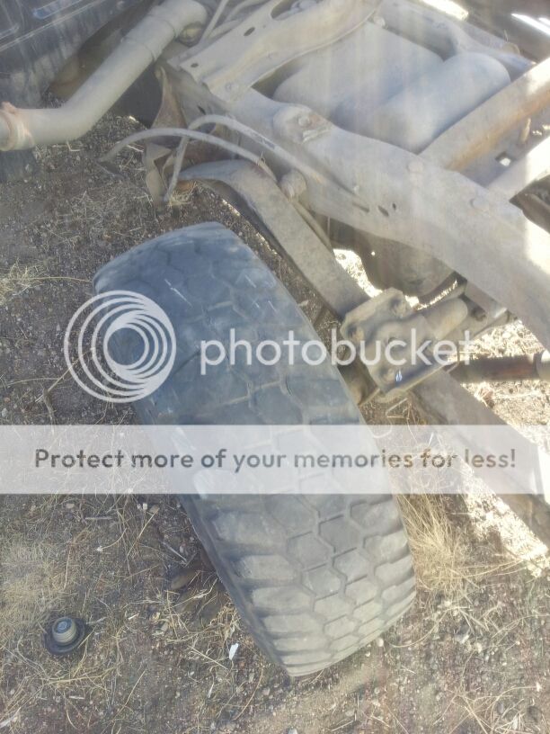

She needs some love. I barely got it on the trailer since the rear axle was so tweaked...

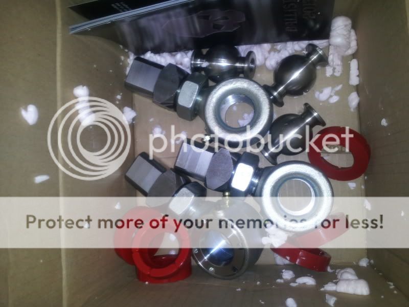

I got my Ballistic Joints few days ago.

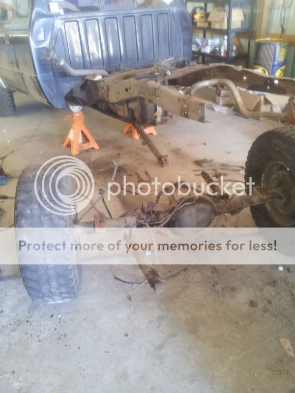

Got the bed off frame looks good. Axle, leaf springs, and front mount on the other hand not so much. LOL

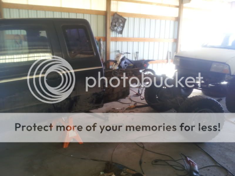

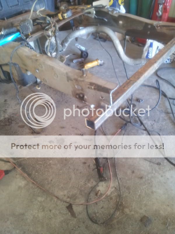

Had a couple hours after lunch so I got a little bit done on the rear. I need to go search for some leaf spring here soon.
This bar will be for the rear shackle mounts and also have hitch built in.
