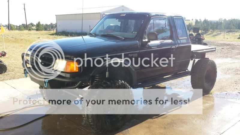

2.0 all dolled up ready to find it's new owner.

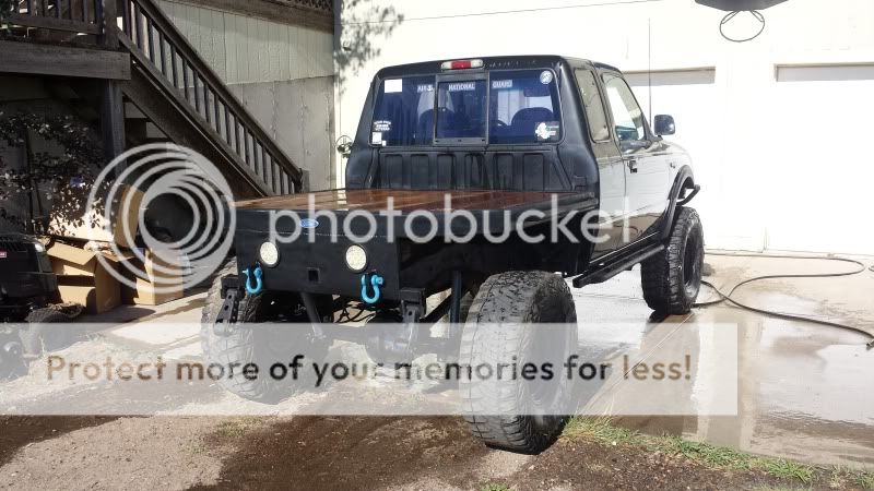

Once again man good finished product. What size metal rod you use for the flatbed?
Flatbed frame is 2x4 .120 wall rect tube. The sliders on the bed are 1.5 .120 wall round. I used angle iron inside to support the wood. And the cross bar center support for the wood bed is round tube. Just what I had laying around. Thanks truck turned out great.

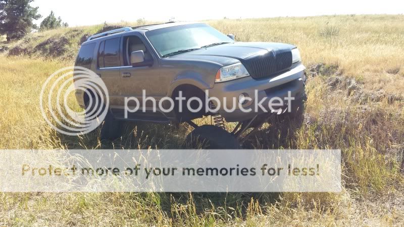

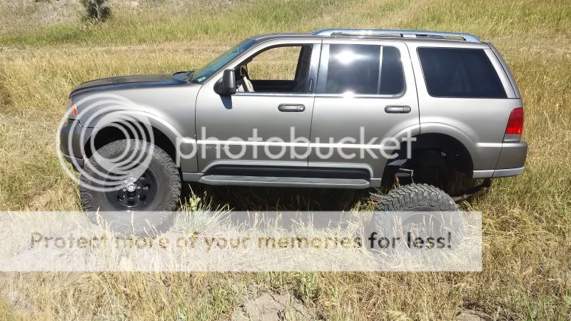

Almost have Lazyboy ready to roll also. 37s fit perfect on it.
