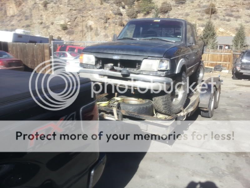

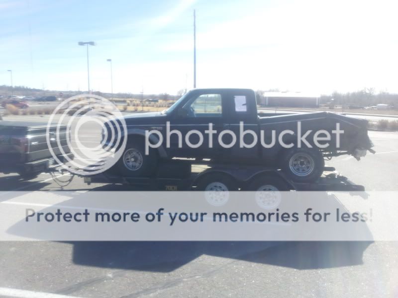

Double R 2.0 picked it up today. Double looked lonely so I picked up a friend today. 2.0 will be getting built a little different then his Orange friend. Still flatbed though. LOL Truck is 93 Super Cab 4.0 5 speed 4x4 electric shift.
She needs some love. I barely got it on the trailer since the rear axle was so tweaked...

Got the bed off frame looks good. Axle, leaf springs, and front mount on the other hand not so much. LOL
Meh itll be good. Just tell people you have rear steer
