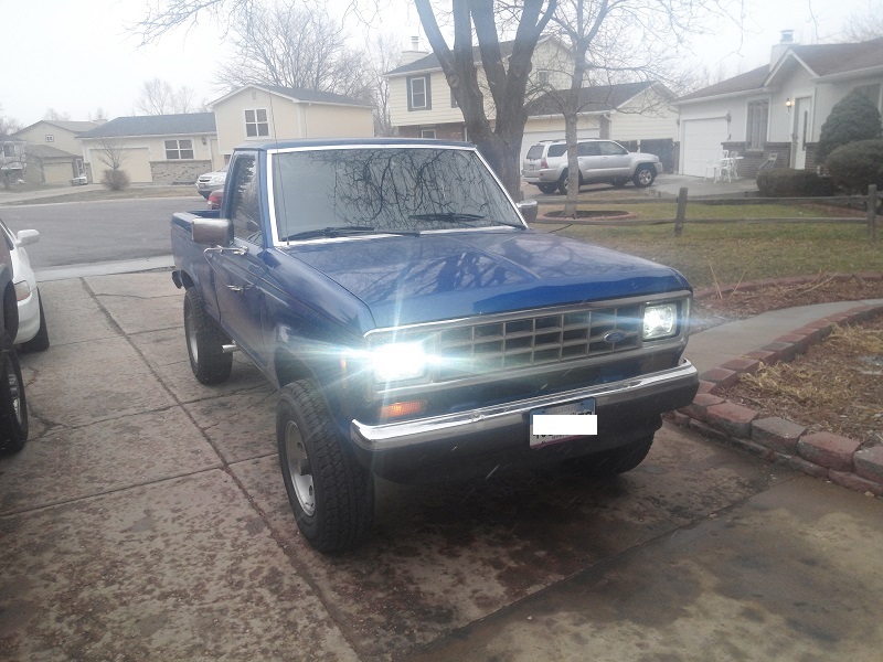

2.9L V6 to 2.3L I4. I've gone above and beyond the "necessary" modifications to make this conversion, but it's a blast to drive. Very curious to see what the dyno has to say tomorrow regarding HP and torque. Currently at about 16psi.
