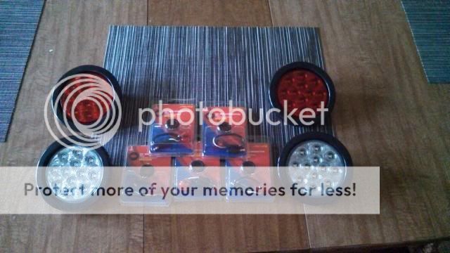

LED tails and clearance lights.

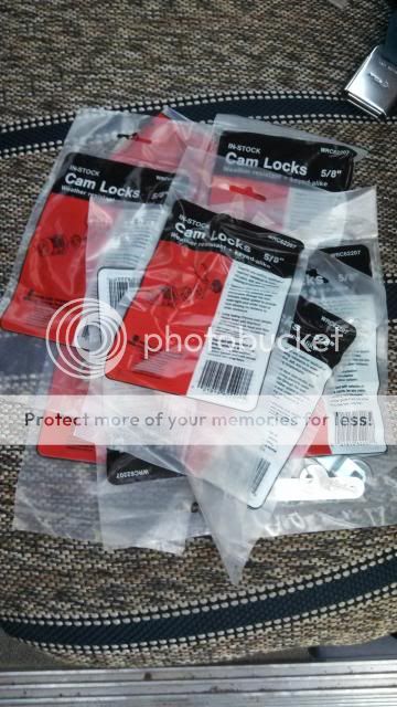

Full set of locks with matching keys.

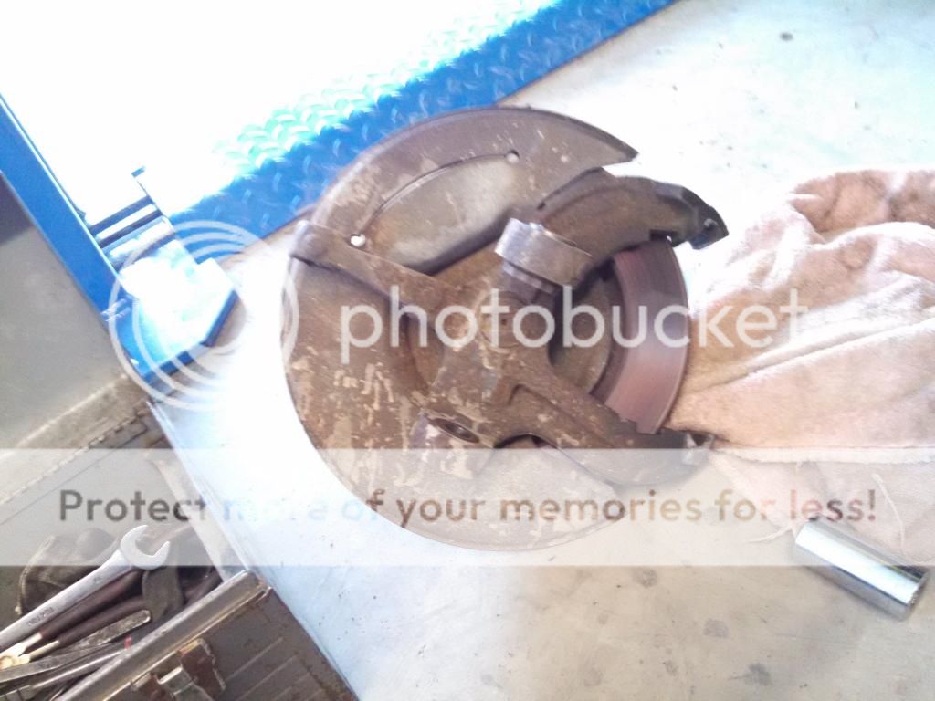

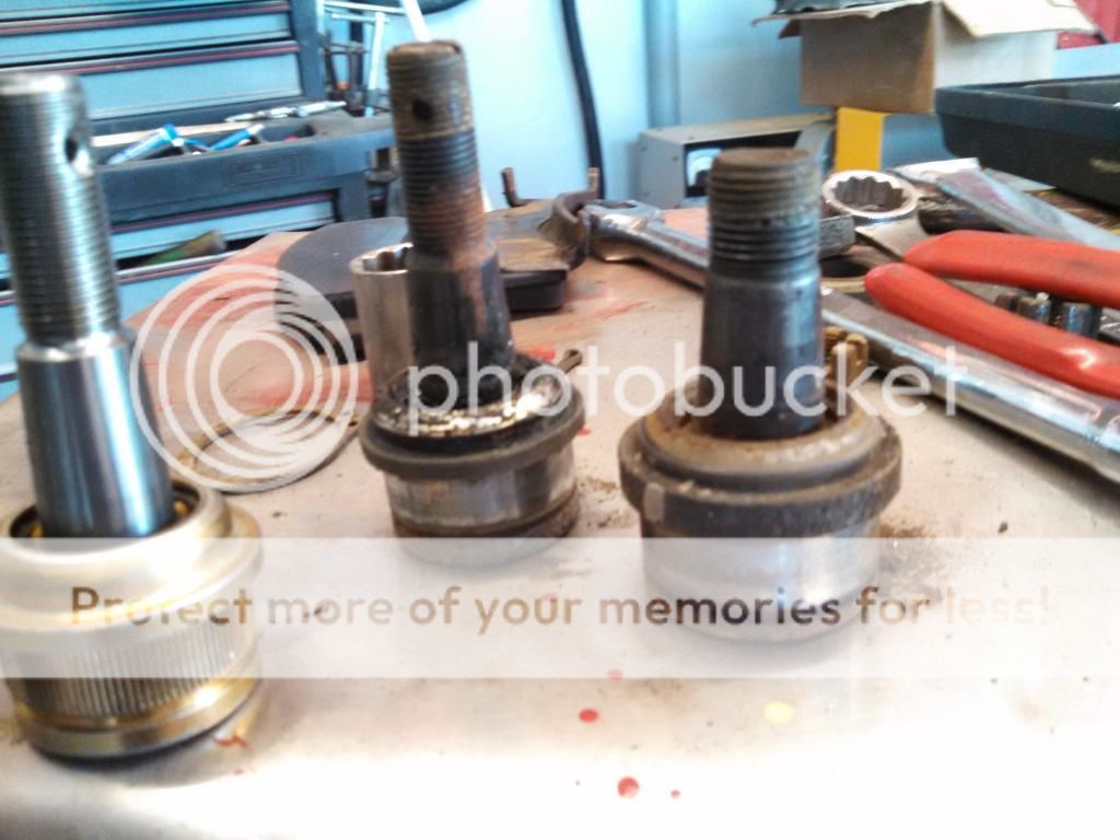

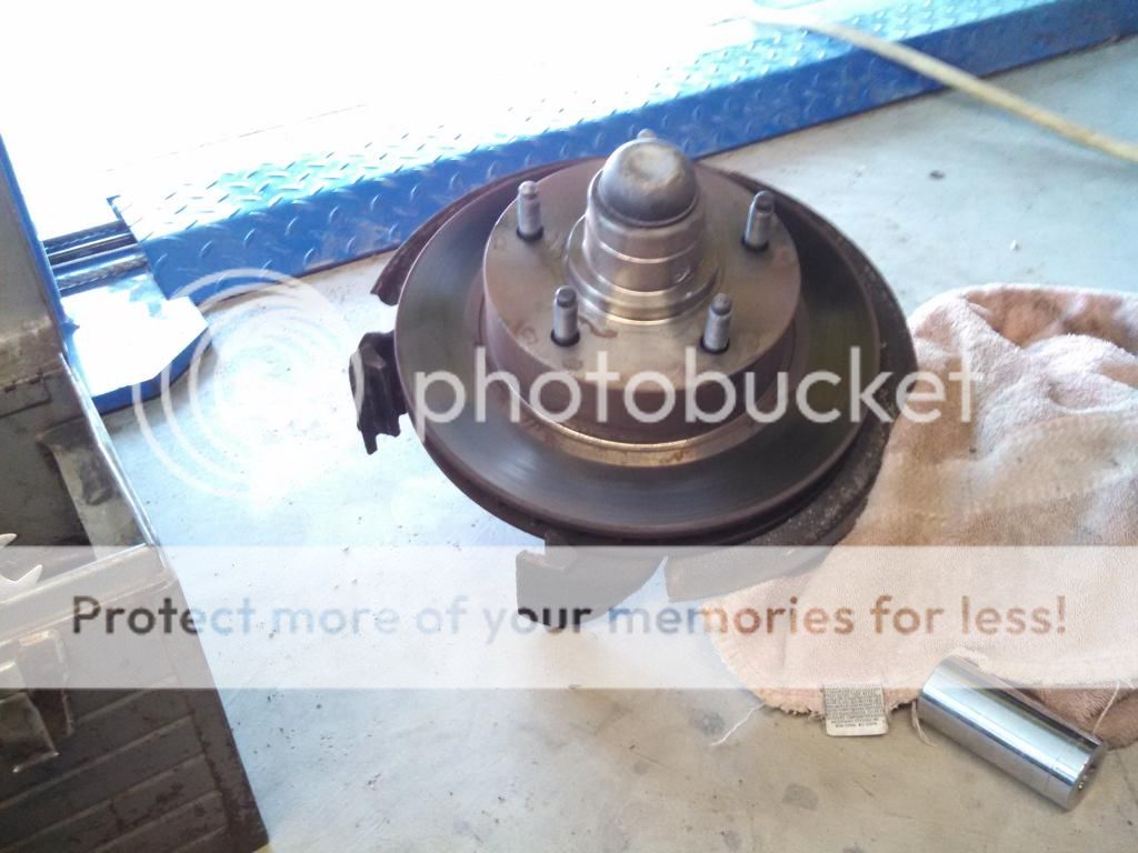

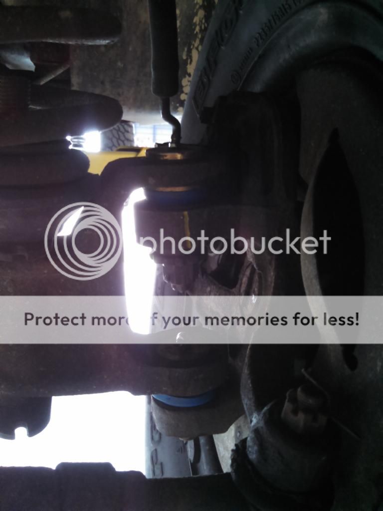

Found my lower ball joints were not soon hot. Silly Ford made these older 1/2 tons backwards....pressed into the beam and tapered on the knuckle/spindle. Still pretty easy with a c clamp type ball joint press.

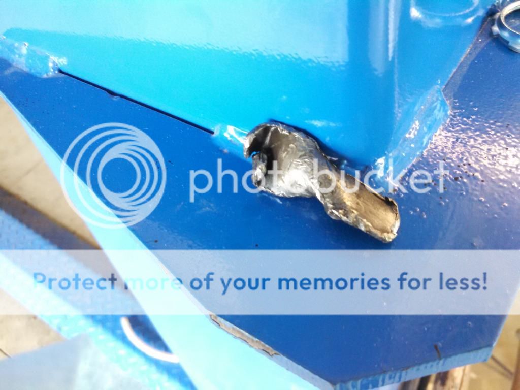

Heard noise coming from the bell housing the other day.......found this when I pulled the inspection cover... Looks like a tag or weight that was spot welded to the TC?
PlumCrazy's F-1Fiddy Build
Turns out I didn't have valve chatter at higher rpms....it was just shrapnel in my bell housing all along.
Between this and the random broken snap ring I found in the trans pan when I bought it. ...I have decided to put a ZF 5 in this pig ASAP.lol. Still shifts like a dream and acts perfect..... But makes me nervous on my 1K round trips to NY every month.
Hate to tell you, but they still do it that way.
Our 94 350 is the other way like the 4x4s and Rangers
