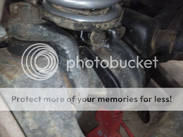

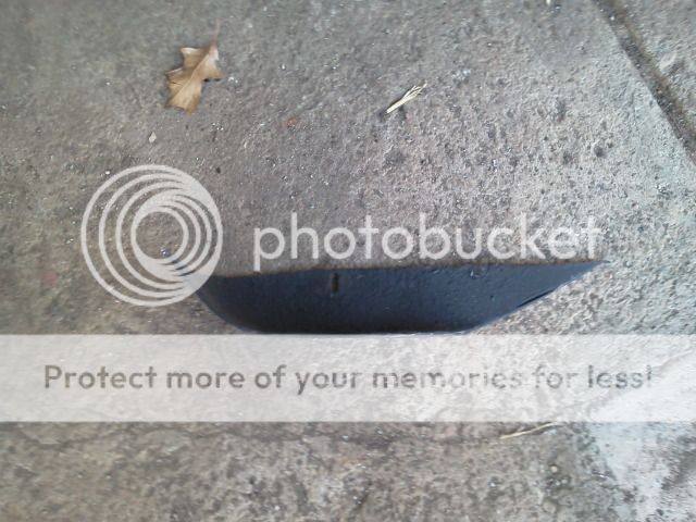

Looks really good. You will like the ride better with the softer springs, depending on what shocks your getting. And the bump stops look familiar.

I test drove it with my old short Rancho shocks and it wasnt too bad. The Tuff Country shocks I ordered are even stiffer, so it should ride like a dream.
I didn't see a patent on those bumps.lol. having bolt ons will make installing those isolators so easy.lol. I decided to go with stock XJ ones to keep my lift to a minimum.

That's ok on the bumps cause I stole it from someone else.

Lol. Its stupid simple and works so well.

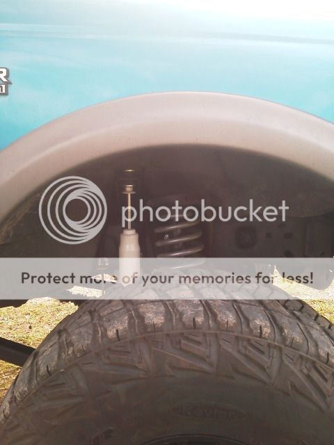

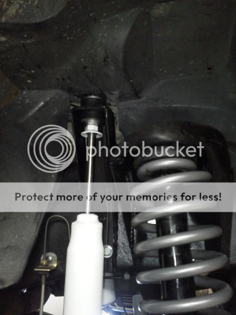

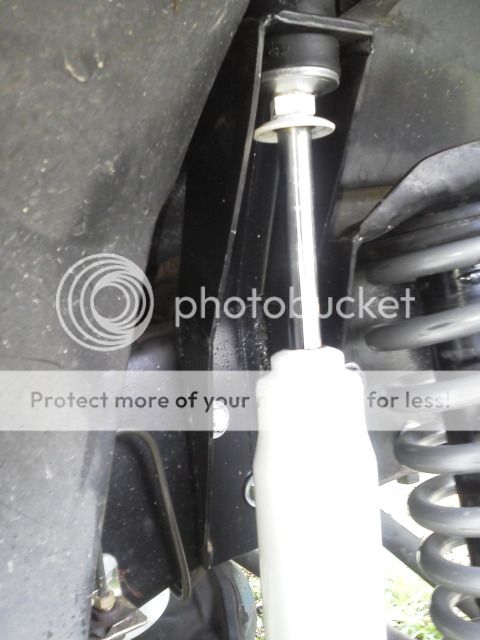

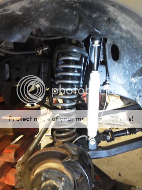

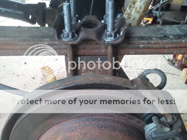

I pretty much finished up everything over the weekend

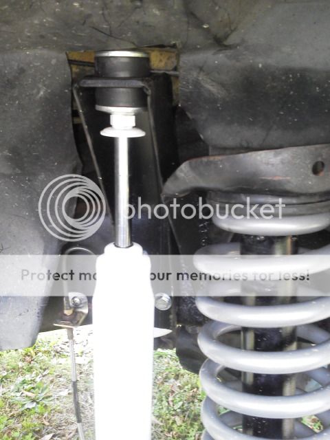

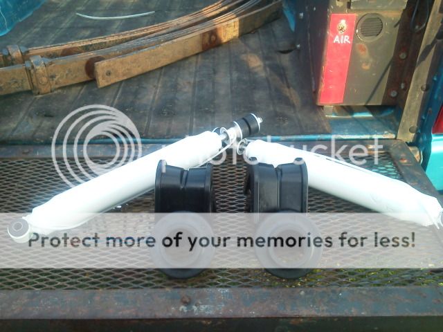

Coil insulators are in, turns out they slip over a 2" od tube, so the ones I made out of 2.25" were too big. So I made new ones.

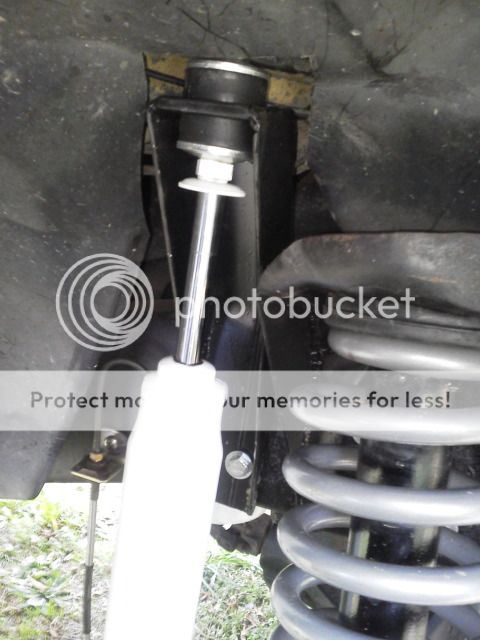

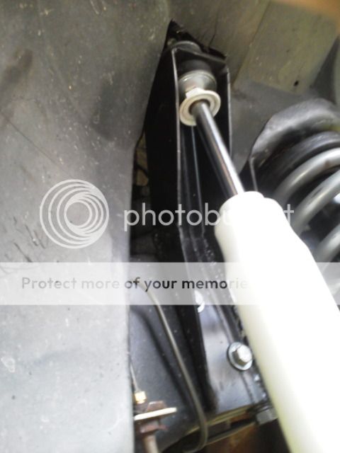

I also finished up my shock mounts and threw on the new shocks.
I swapped out the 7* wedge bushings for some 2* to fix my caster and pinion angle.

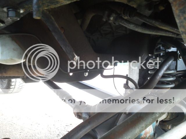

Trimmed the engine cross member a bit more to clear the trackbar.
Took out the stock 2.5" rear blocks and swapped them for some 3/4" blocks I made.
Final ride height is about 3" lower up front and 1.75" lower in the rear.
-PlumCrazy
All I have to do now is clearance the traction bar crossmember to keep it from destroying my rear driveshaft.

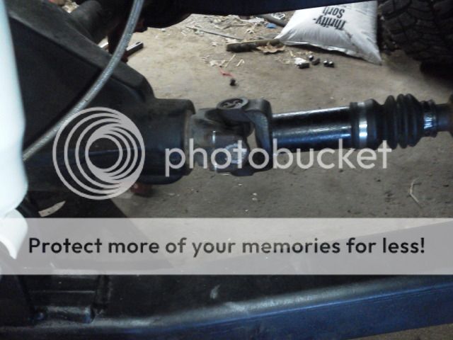

Next on the list is have my extra pass side front axle shaft shortened to EB width and throw the whole set of larger joint shafts in, so i can put that mini spool in.

The coil isolators I have are 2.25" id. I must have ones for a different jeep or something.
Sent from my HTC ONE S using Tapatalk 2
I got mine through Rustys. Said they fit XJ, Comanche, Waggy, and more. They are stock rubber with a steal core of some sort. No biggy. The only 2" tube I had on hand was a bit thinner walled, so I will buy different bushings that fit the 2.25" if I ever break one of these. Im not too worried about it. Thats what I get for trying to build things without having all my parts on hand.lol

I was kinda was hoping for it to be a hair lower than it ended up.
-PlumCrazy
Looks great. I think the height is perfect.
I think we sit at about the same height now.
