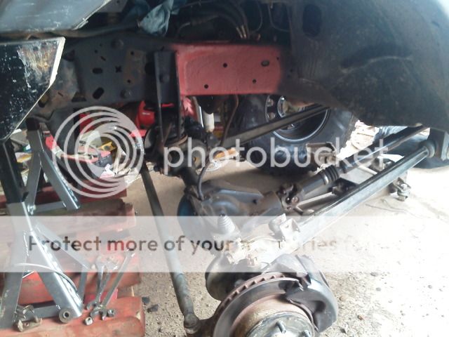

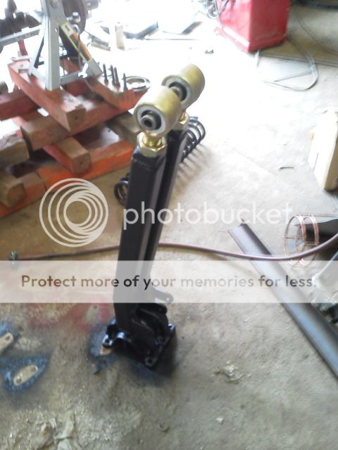

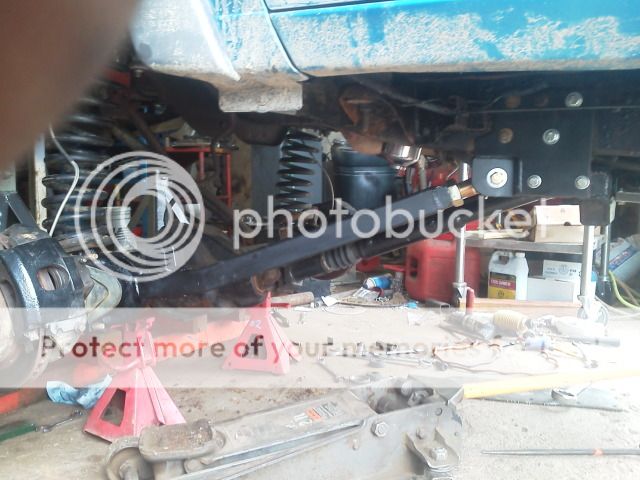

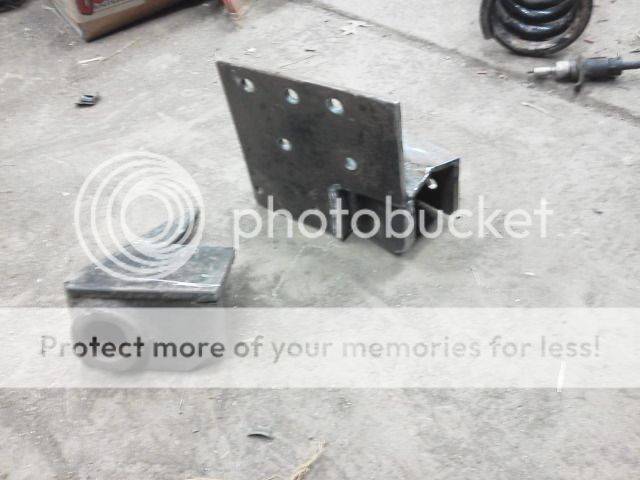

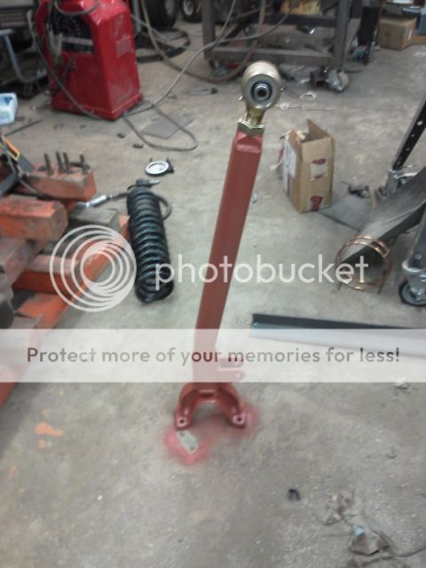

Built new radius arms that use Johnny Joints and have 10* caster built in.

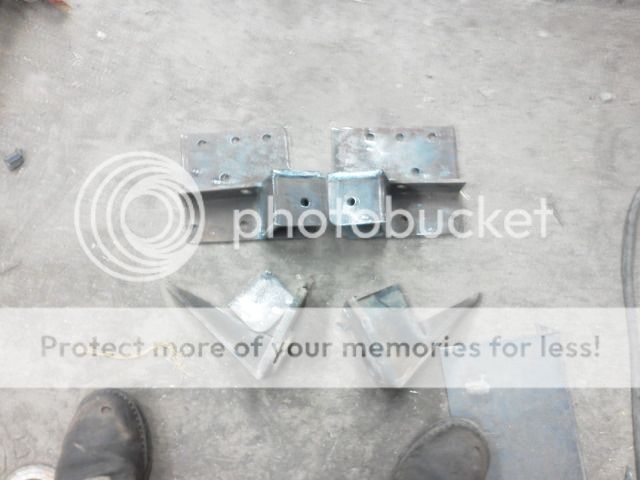

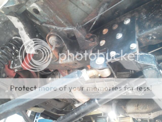

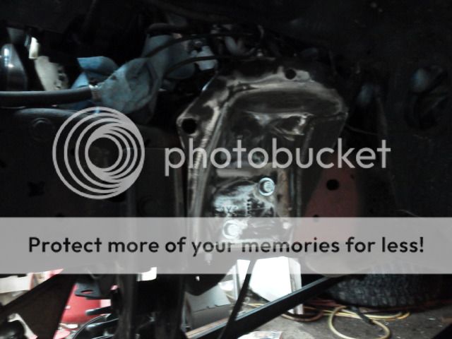

Modified the old brackets to accept the JJ.

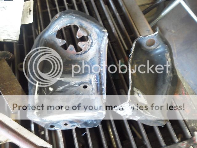

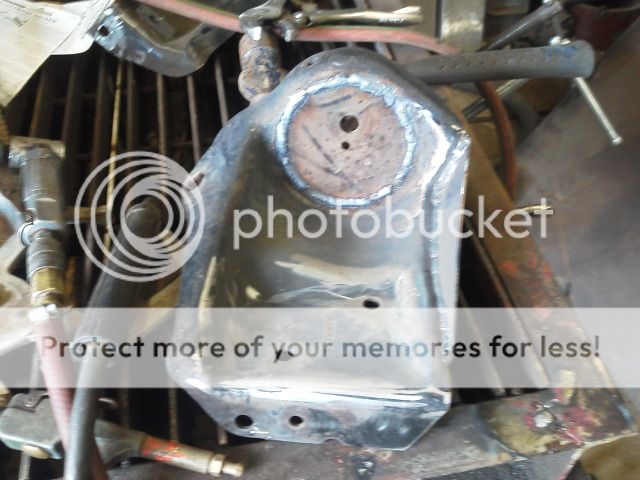

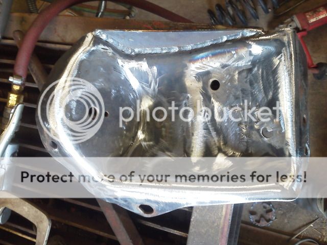

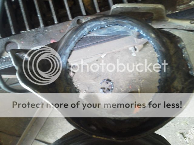

Started working on chopping down the coil buckets for new shock mounts and Heep coils.

Now I need to swap my 7* bushings for some 4* to get a better pinion angle.
