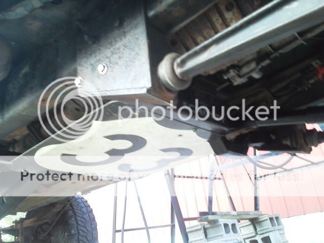

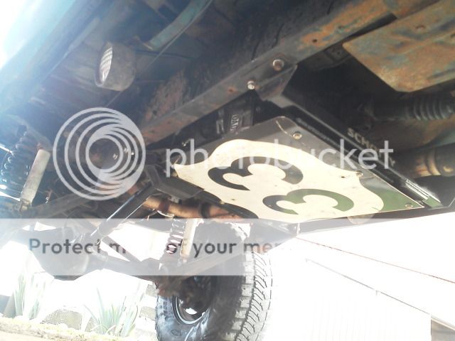

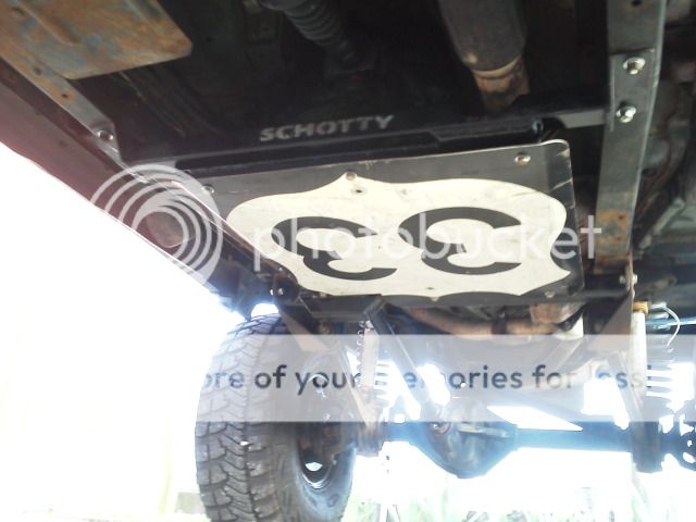

Finally made a t case skid

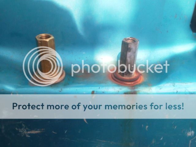

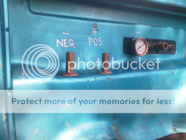

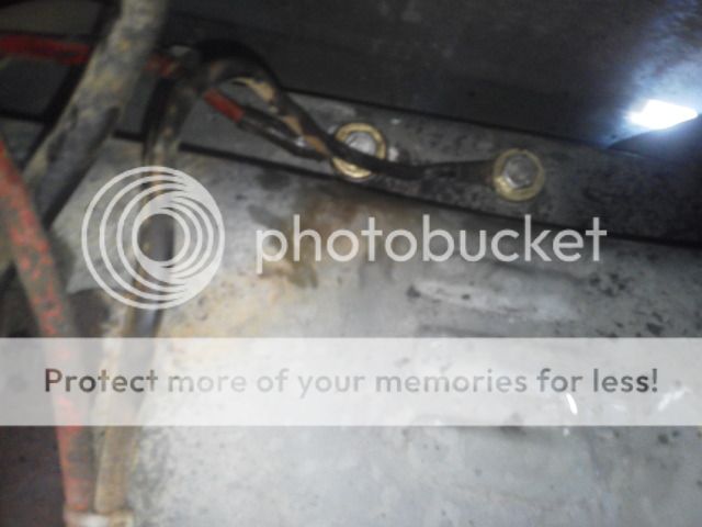

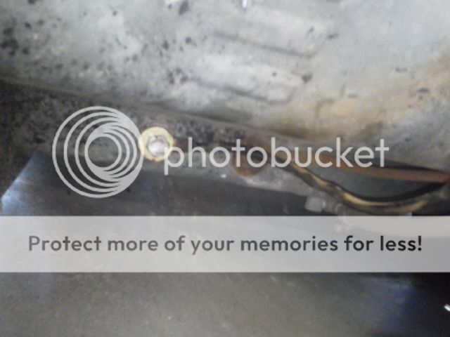

I was using my remote terminals and noticed they were getting rather warm after a short while. Turns out the connections were in pretty bad shape underneath.

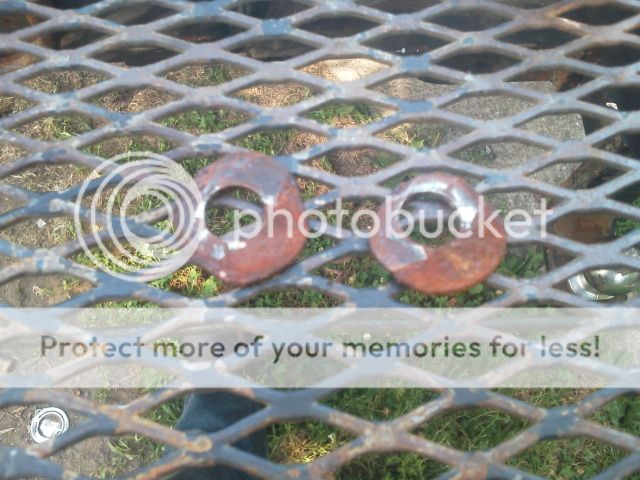

When I made them I just used zinc coated hardware I already had laying around, but after a few years the positive terminal connection underneath was rusted up pretty bad. The 1/2" washers were almost gone
New vs old
I replaced the bolts with stainless and the coupling nuts and washers with brass. I also applied liberal amounts of dielectric grease.

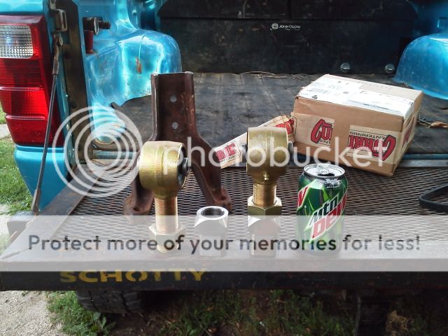

And these showed up finally.

Now that, my friend is an update! Skidplate looks amazing btw. I've never really had a problem w/ the OEM skidplate (knock on wood). I was lucky enough to find one in a JY one day and they gave it to me for free.
Ya know, it's pics like this that make me laugh at Zimmerman's first attempt at extended arms. I believe he used 3/4" Heims..... :icon_confused:
I almost went 7/8", but no one makes tube adapters for 2" box. The stock arms on RBV TTB and Ford wedge style arms only use 3/4" stubs on the bushing end.
I needed a new skid because the the doubler moved the tcase back and down. I always wanted something to cover the whole belly anyway. Im not worried about it being heavy enough to support the trucks weight, I just want it to prevent something like a rock or log from actually snagging on the case.

Good looking skid. Those JJ's should help your front end flex with the new arms.
I hope so. Im not extending them much though. I want to just modify my current mounts, so Ill only add 2" tops. I am going to see if the new arms alone gain me enough articulation to keep my current EB coils. If its still stiff then Ill break down and buy some 180 PPI Heep coils. I plan to build some caster into the new arms and swap out my 7* poly wedge bushings for some softer OEM rubber ones too. Im trying to get around buying coils if I can.lol I know Ill end up needing longer shocks too, but there is no way around that. I should have bought longer ones my first time around, but I was too lazy to make taller mounts.lol
