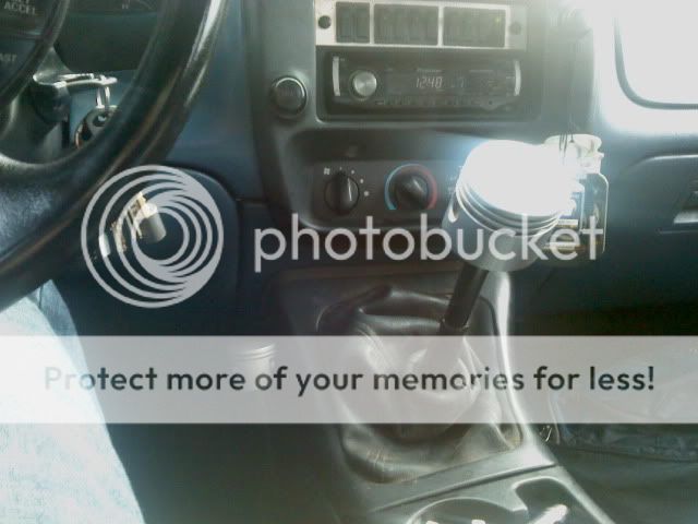

Put the new boot on the short throw and pulled it out for some crappy pics

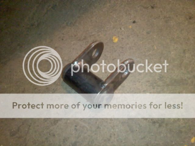

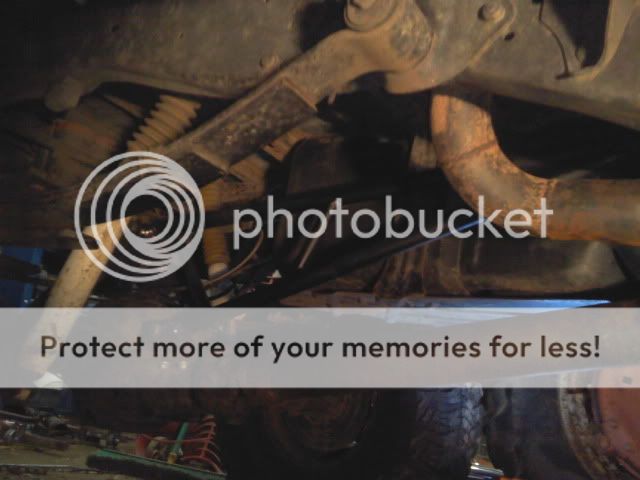

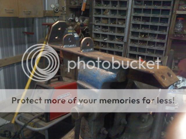

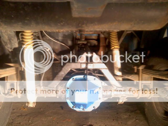

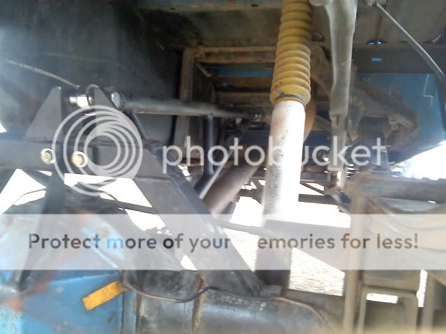

Finally finished the traction bar
I used 3/4" Rod Ends and used some modified sway bar link bushings for the shackle.

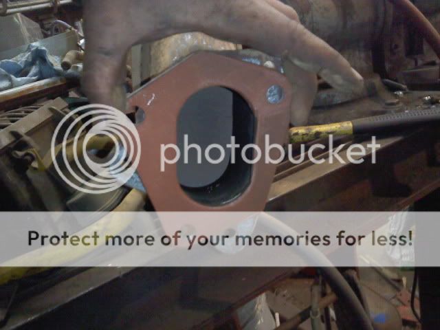

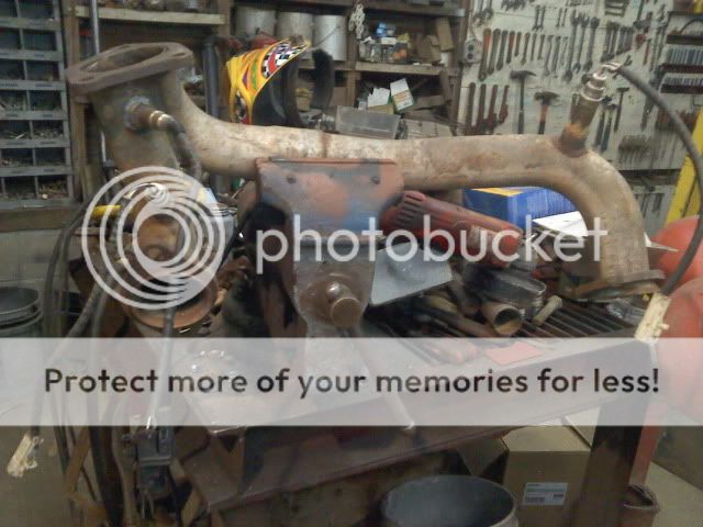

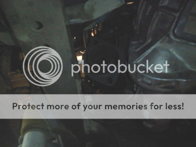

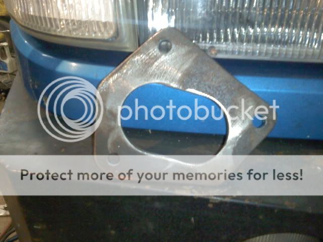

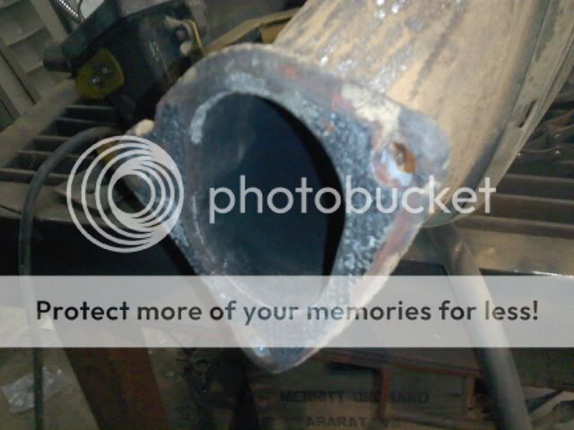

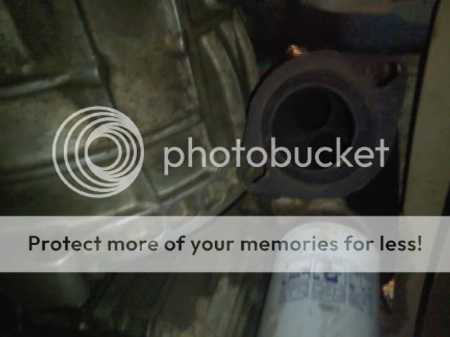

I had to make a new flange on the cat since they changed from 94 to 95. My old flange wasnt too pretty either
I added my bung for the wideband.

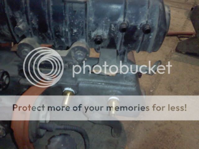

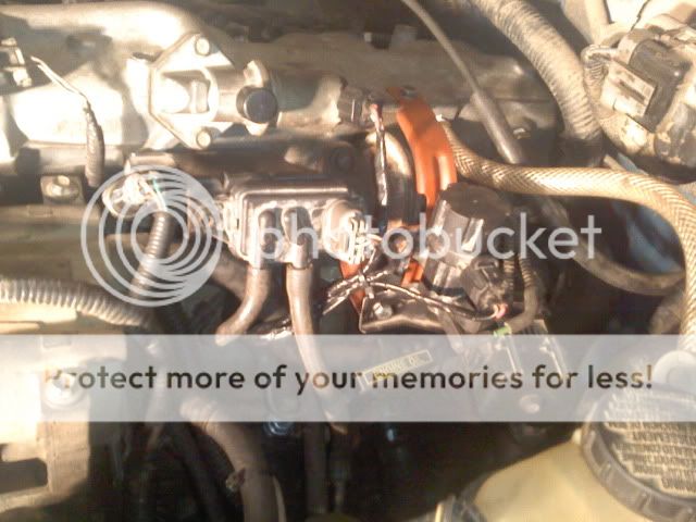

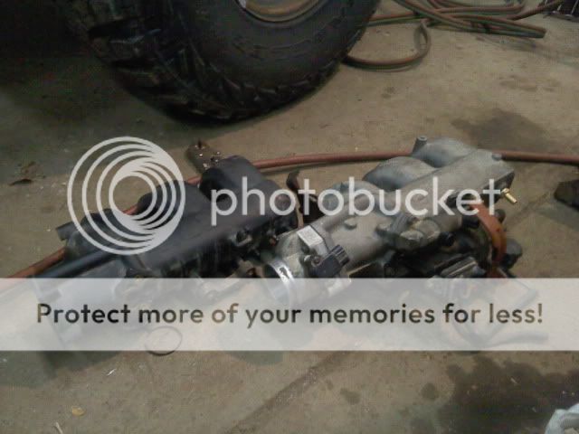

I put some brass nipples where the old IAT and vacuum tree were so I could reuse the vacuum lines from the 95.

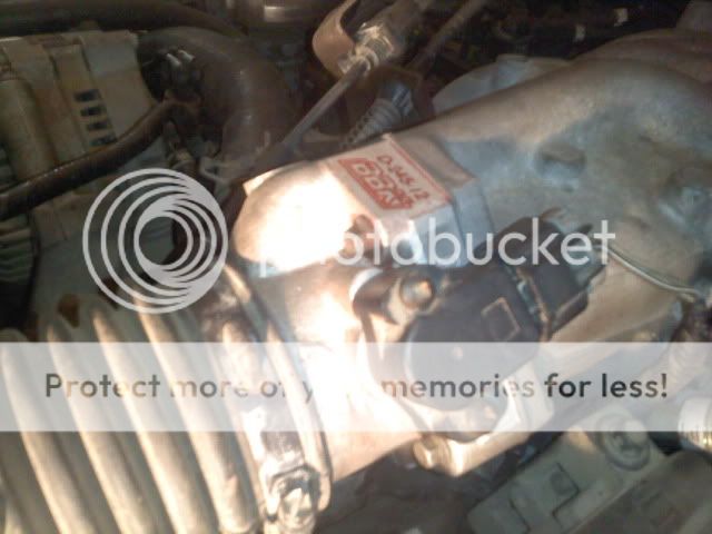

I had to relocate the EGR solenoid to clear the engine harness plug on the OBDII motor. I also had to extend the plugs for the IAC, DEPF, and EGR Solenoid.

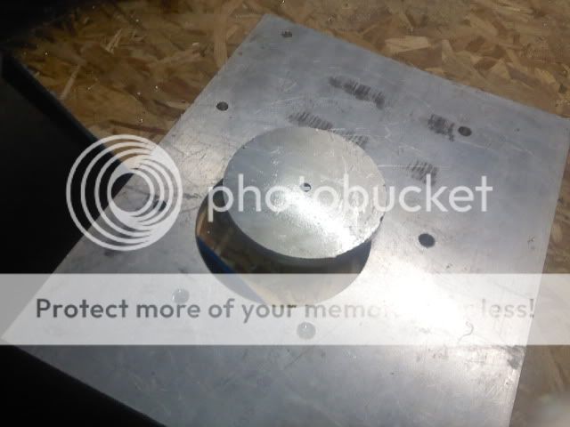

BBK TB is on. painted the letters on the TB just because I could.

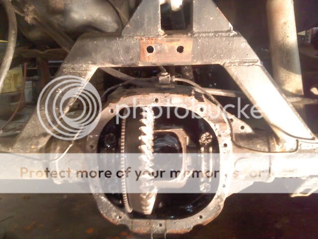

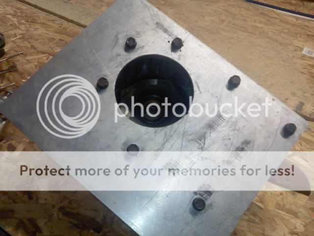

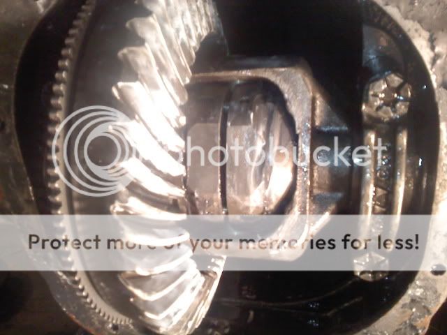

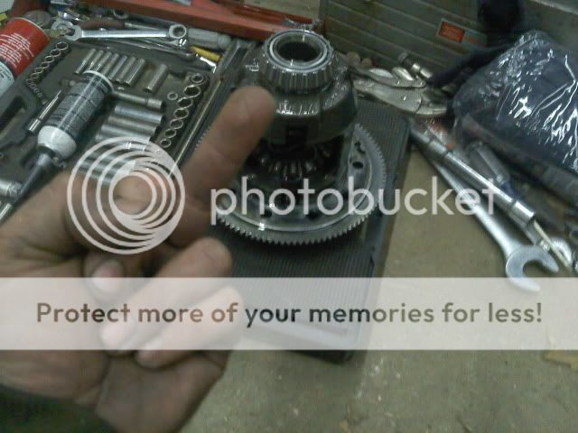

The locker is finally in.
Trac-Lok can blow me
Open carrier
"Full" carrier.lol

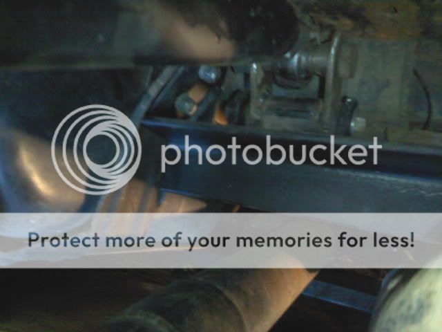

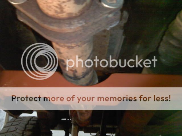

The new y-pipe aimed the cat a little differently so it didnt quite line up with my notch in the crossmember. So I made it a little bigger. Its not centered because I had to remove the old notch and make it big enough to clear the pipe still. I reinforced it with a chunk of 1/2" bar and boxed it back in.

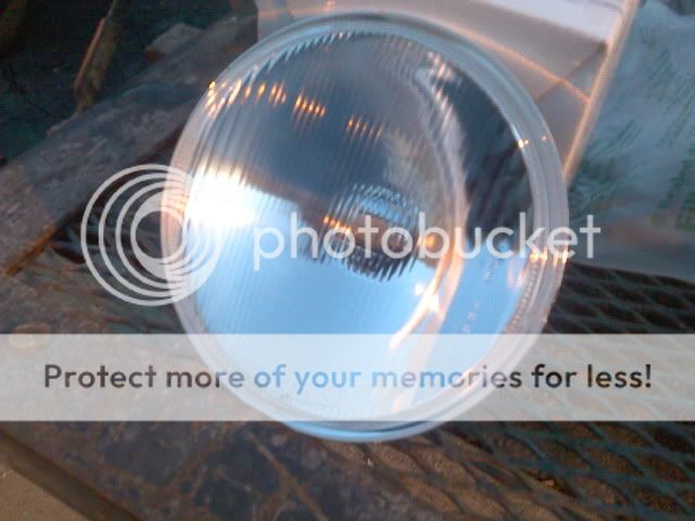

New reflector/lenses for my outter roof lights to convert them to a wider driving pattern. The old spot light pattern was worthless for what I use them for.
I also got 130W bulbs to put in the new 6x9 lights when they show up. You can only buy the the lights in the 100W flavor, so I wanted to spice them up a bit.

Your truck is looking really good. How do you like the traction bar, would you change anything? Also like the gas filter idea.
Richard
Richard
Traction bar works just as is should. A longer shackle would be ideal, but I dont really have room. Axle wrap is gone, but now I have a little wheel hop on dry hard surfaces. I am pleased with the results. I hope to tackle the filter this weekend, but I also need to get my VW back on the road too.lol

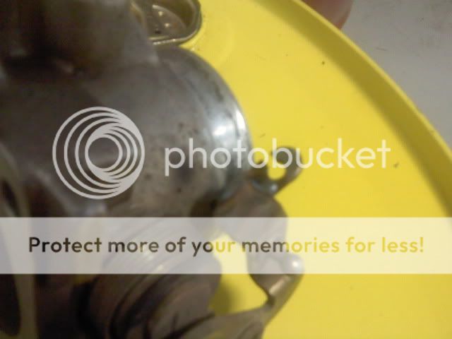

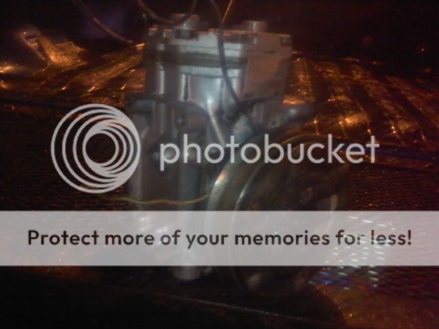

Picked up a York for 20 bucks. I pulled the plug and it still has clean oil in it, but the car it came from had no refrigerant so I have no idea it works yet.
if it was still sealed up with all the hoses, then it should be OK. just because one leaks down when it has set for a very long time, doesn't really mean any thing, the front seal on the compressor need the oil and ref. splashed up on for it to make a good seal.
Robert
Robert
Its a R209R. That means Rotolok Seals (Which i still have the fittings w/ barbs) and 9 CI/rev
which means it should be around 5 CFM @ 1000rpm, 10 @ 2000rpm, 15 @ 3000 21 @ 4000, and 26 @ 5000
I am going to run it with a 1hp 12V motor and replace my oiless Lincoln compressors

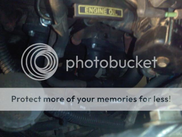

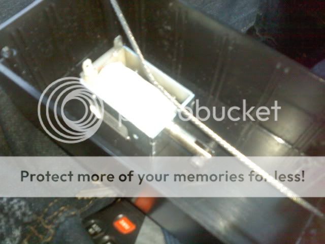

I have been having battery troubles with my Rabbit, so the truck has been used to jump start the old diesel a few times. I have been wanting to add a "high" idle to the truck for a while for things like warming up, jump starts, and sitting with the lights on.

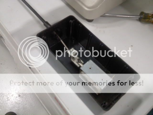

I started piecing together some things to rig it up. I started with a linear actuator from McMaster -Carr. It is 12V and develops 2lbs of pull with a 1/2" travel.

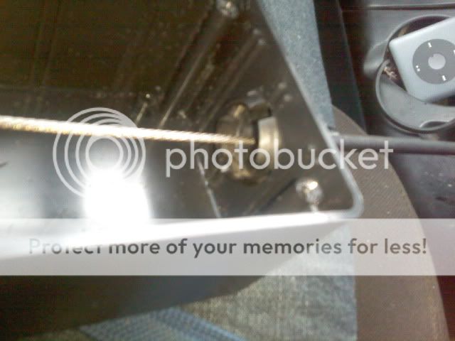

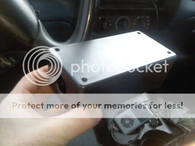

I put it in little hobby project enclosure from Radio Shack, and used a cruise control cable from a late 90's Nissan something.lol

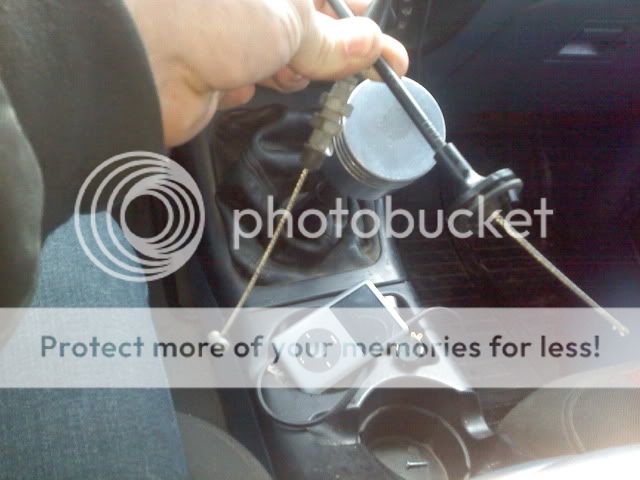

The cable was the perfect length to mount the box by the master cylinder, it mounts in a 1" hole in the box and has a two jam nuts for adjustment on the other end.

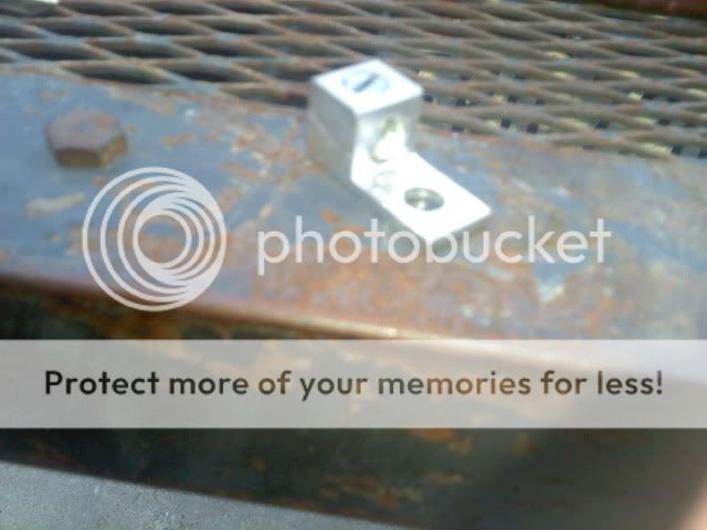

I used a ground lug with a set screw to attach the cable to the clevis and allow for more adjustment if needed.

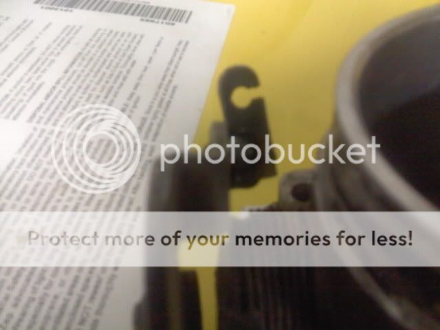

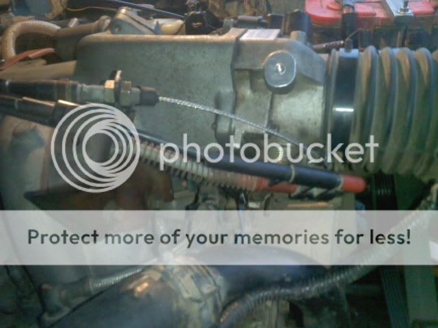

I added a tab to the throttle cable bracket and another tab with a slotted hole on the TB
Once the cable is in the hole I crimped the slot closed to capture it.
I havnt finished running wires, but it should work nicely when its complete. I had to add a spring to assist the solenoid because it wasnt quite strong enough to overcome the friction of the cable once it was curved.
Lookin good. How you liking the locker? Get much rattleing in your rear end from it I'm debating gettin one for my truck.
