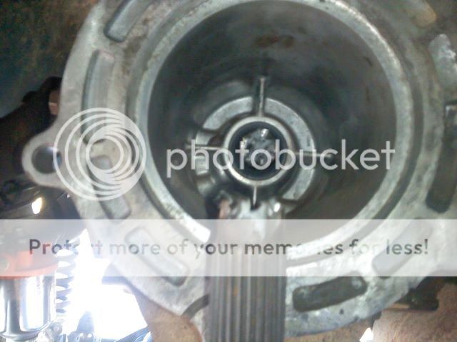

Well... it turns out the M5OD-R1HD shaft isnt HD enough for a hard launch.
PlumCrazy's Build
I snapped the output shaft. The splines actually twisted a bit before it broke though.

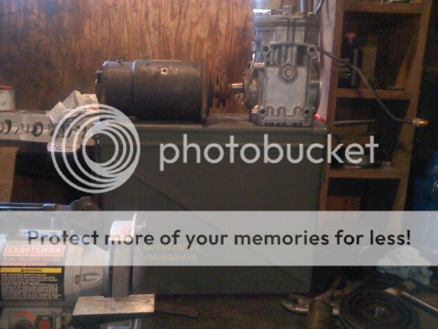

On another note. I did get around to testing out the York I picked up while back. Here is a terrible video of my test bench.lol I clamped an old 12V starter/generator from a Cub Cadet to my tailgate. then used a peice of scrap steel with two holes to bolt the York down to the gate. I then used an old belt from my V dub to connect the two. I used some jumper cables to run power to the motor, then some alligator clips to get power to the clutch.
PlumCrazy's Build
I hooked it up to my OBA tank (not in the vid) and it fills it up from 0 psi in no time which tells me once its all wired up with the pressure control switch I have now it should be able to run small impact.
I plan to mount it all in the Ammo box if I can. I need to get a smalled pulley for the compressor to spin it a little faster. With the setup I have now, it only spins like 1000 rpm which is like 5 CFM. If I can get it colser to 2500 RPM I would be happy.

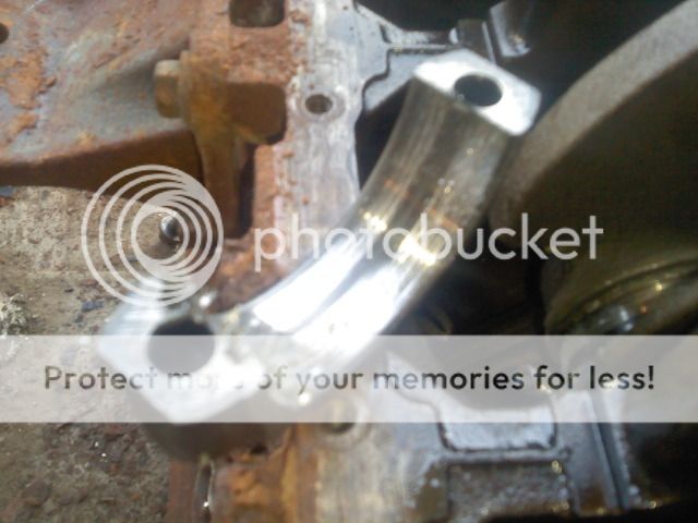

Turns out the tranny is fine, but the motor is locked up. It will turn like 180 before it binds up. Its not a hard stop and it does it with the plugs out, so I am assuming the timing chain let loose and a piston is hitting a bent valve now.
Tore the green truck down. Turns out the tranny is probably fine, but the motor was locked up.
The gear stripped off the cam synchro and the oil pump quit pumping. the rod bearing on cyl 4 was welded to the crank.
