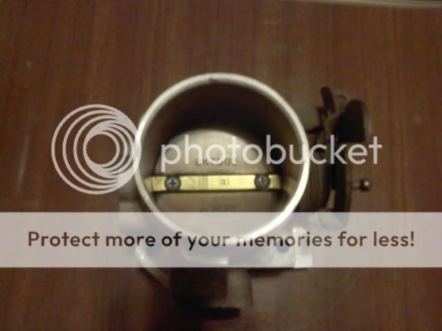

BBK 66mm TB

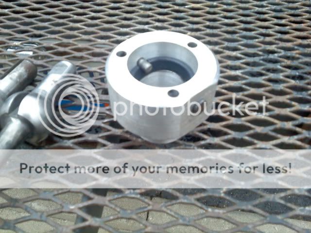

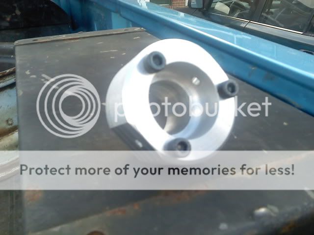

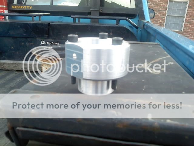

I have been wanting a Hurst short throw for a while, but I cant justify the price tag on a new one, so I did some work with a chunk of aluminum on the lathe and made a spacer to move the shifter bushing location up about 1.25" from stock. It looks very similar to the hurst, but utilizes stock bushings. Ill post up pics tonight.

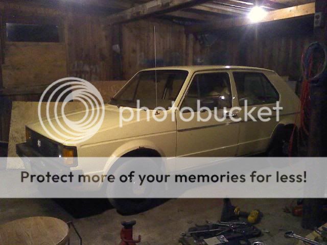

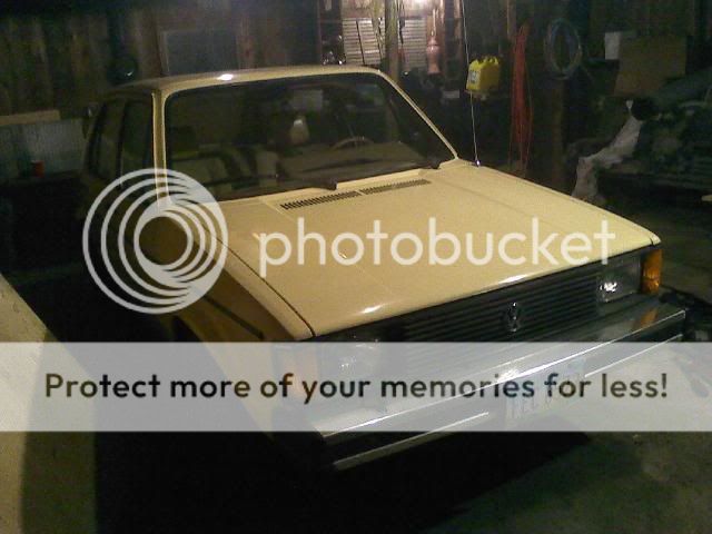

I ended up getting a an 84 VW Rabbit Diesel. Its a Mint condition 4 door with less than 150K. I got enough spare parts with it to almost build another car.lol
Here is the shifter housing I made.

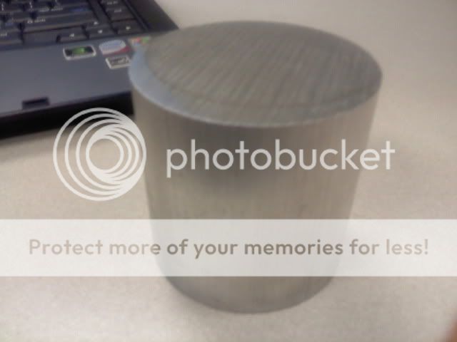

Started with this...3" diameter 3" tall chunk of aluminum
And I ended with this
I still have to get an extra shifter to extend, but the hard part is done. It uses stock bushings, and the stock dowels. The smaller diameter part slips down where the original bushings were. Then original top plate and some longer bolts hold it all together. I will get some pics of it bolted to a tranny tonight maybe.
I saved all the measurements, so I can make few more if it works out ok.

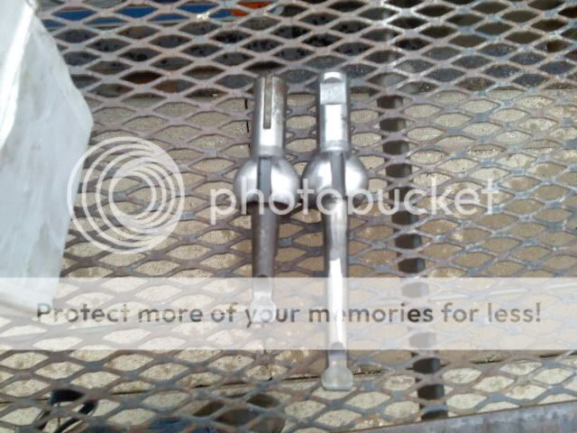

I finished up the short throw and installed it.
I ended up shorting the throw by around 32%. Which is roughly 2.5" shorter throw from 3 to 4.
I added 1.25" to the bottom of the shifter, which changed the ratio from 6.09:1 to 4.19:1
I cut the bottom portion of an older shifter off as close to ball as I could. I then marked out where I would need to cut my existing shifter off to make it 1.25" longer that it was originally by adding the portion I cut off the other one.
The stock shifter is 2.875" from the center of the pivot ball to the lower tip and the new shifter is 4.175".
Here is the housing with the lower bushing in and the original pins pressed in.
I ordered a new top retaining plate/boot, so when it comes in I will take pics of everything bolted together since it was dark when I got it in today

I already have the intake mani and EGR tube, header bolts, gaskets, and I got a new gasket for the 66mm TB. I do need to open up the inlet to the intake mani though

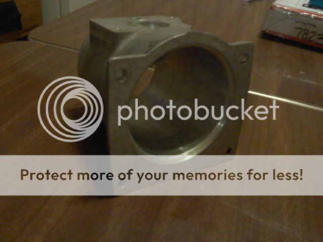

The TB is on, but the MAF housing wont work. It is actually smaller than my stock housing and wont seal up in the air box. it would be a nice upgrade for a 2.3 or 3.0 though.
well i will keep a look out on your thread to see when u done. that sucks about the maf i wouldn't have figured that but ylu do have a newer gen 4.0. but glad the throttle bod worked out for ya.
