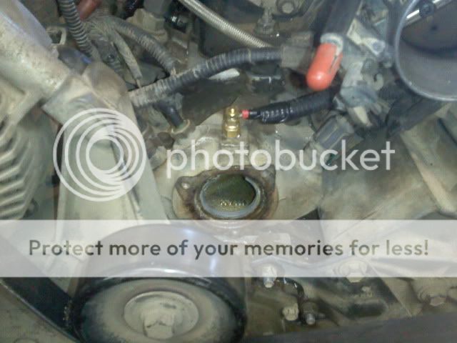

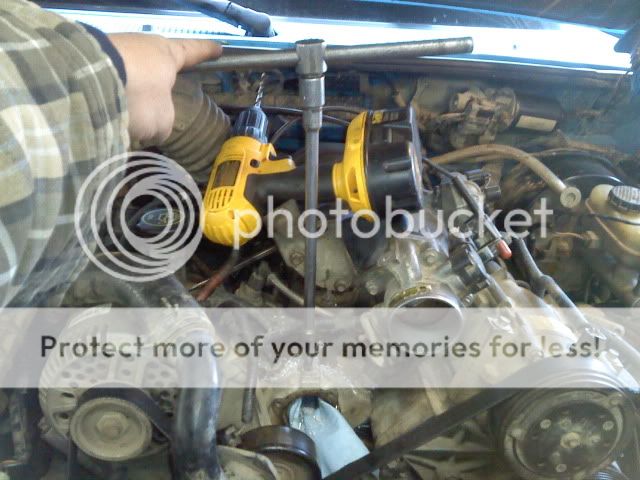

Temp gauge is in
I was going to put a "T" in where the stock sensor was, but I figured it would be more accurate and look cleaner to drill and tap the intake. I was able to catch all the debris with a wet towel and a shop vac.
I used a 3/8" 8 point socket and a long extension to turn the tap so I could get the handle up above the intake.

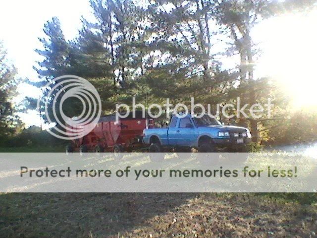

Harvest season. Truck gets worked

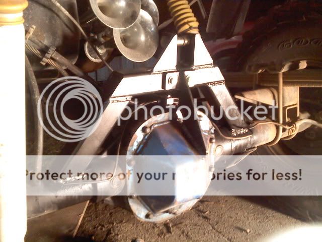

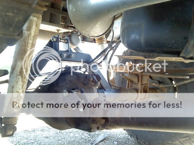

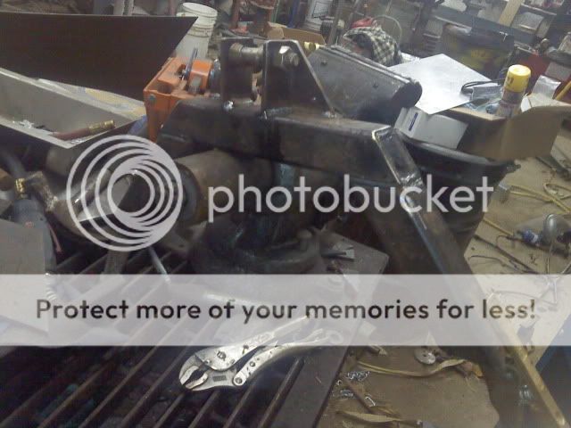

I finally got around to building my much needed traction bar.
I was originally going to mount it to the axle like MetalMacguyver did, but I didnt want 90% of my welds to be on the center section of the diff.
So I made an axle truss to mount the upper link to, then made a bracket to attach the lower link to the diff via the mounting holes for the vibration damper/shock used on the Exploder axle.
I welded in the tubes while I was screwing around under there too.
I also braced the truss by adding a gusset between it and the diff cover. The gusset is welded to the cover, but bolted the truss with grade 8 bolts so the cover can still be removed.lol

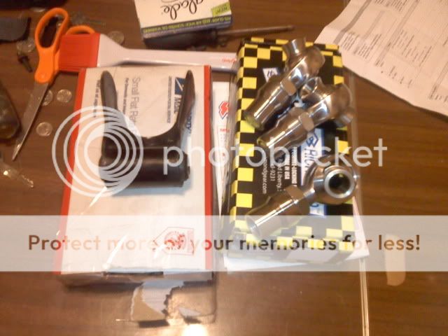

I will be using 3/4" Rodends for the ends, and a small shackle in tension for the frame mount. Put my order in at RuffStuff today, and I plan on picking up some DOM tubing soon for the actual bar.
Locker ordered. I bought a Lock Right for an open diff, so I need to pick up an open carrier. I couldn't justify spending an extra 200 bucks for a locker just so I could keep my L/S case.

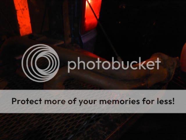

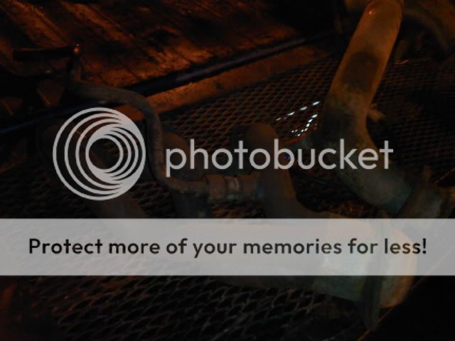

Picked these up last night.
They are from a 94 Exploder, so the EGR tube comes out of the front of the manifold where as mine comes out of the back. So I picked up an aluminum intake from an Exploder with the EGR mounted directly to it. I picked up the tube and all the brackets for mounting the EGR stuff.
And the locker and rod ends for the traction bar

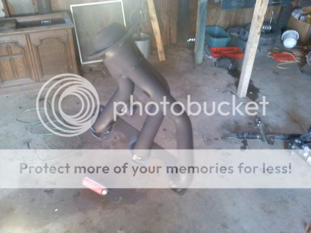

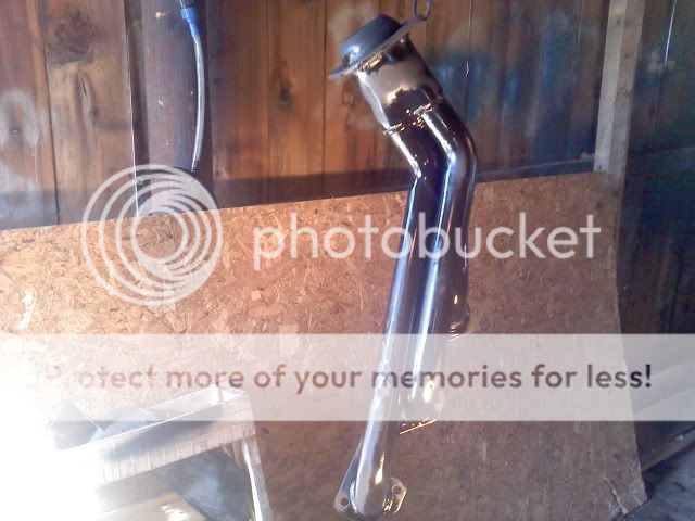

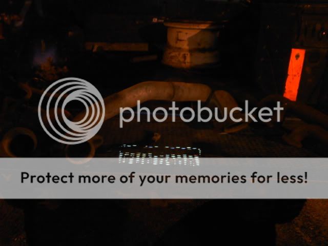

I cleaned up the headers and painted them with some 2000 Degree Black Ceramic paint. I also picked up all the gaskets and what not for them,

Pics of the headers.
I still have to get a set of manifold studs and weld a new bung in the Y-pipe for the wideband.
