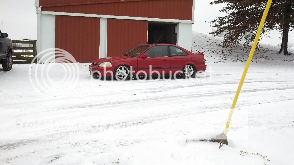

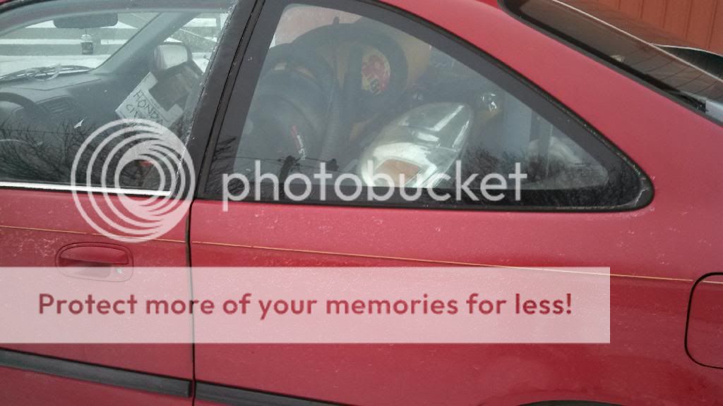

Both...normally it has good bit of rake, but that load leveled it out.lol The front appears to be higher than normal actually.
Forgot to share this... hauled some more junk home from the old shop this past weekend...its like a truck, but gets 30+mpg

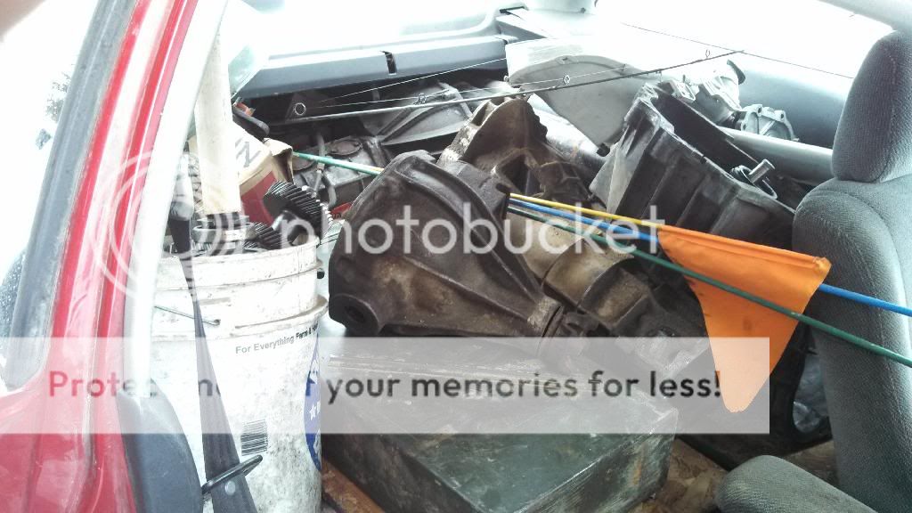

I loaded more on top too, but the bulk of the load was transmissions, diffs, drill press, axles, etc.lol
I see the TK5 in there.:D

Yup. I havent done a thing with it yet besides trip over it for a year.lol

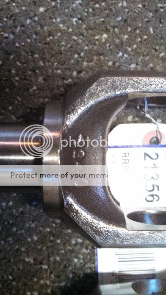

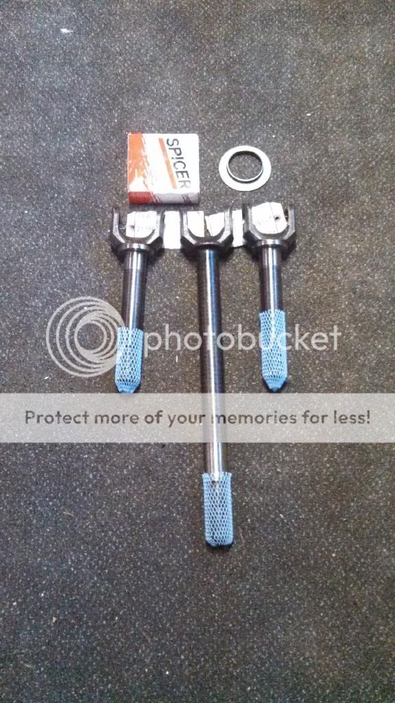

Those new shafts are pretty!
I just asked my wife if she wanted to see your new shafts. I got that look
