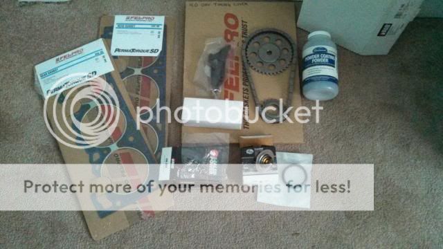

Few more goodies showed up over the past week.
PlumCrazy's Build
-Timing set and cover gasket
-Severe Duty head gaskets
-valve keepers
-thermo stat and gasket
-some more Battleship Grey powder
Still some more stuff on a UPS truck somewhere stuck in the snow.lol

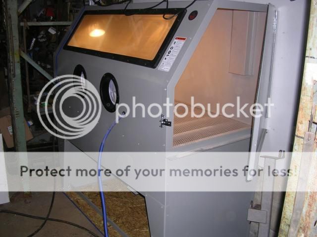

Played with the new toy a little today...

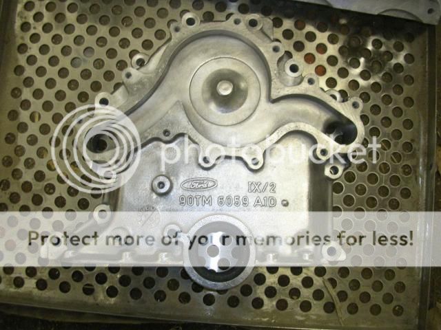

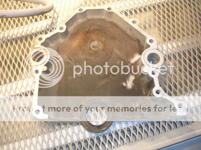

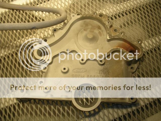

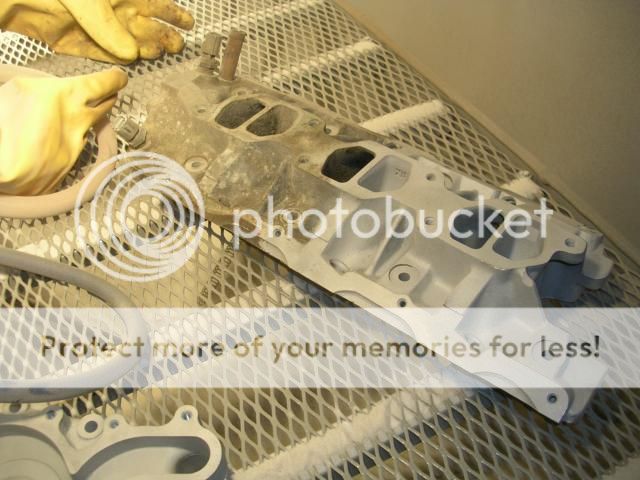

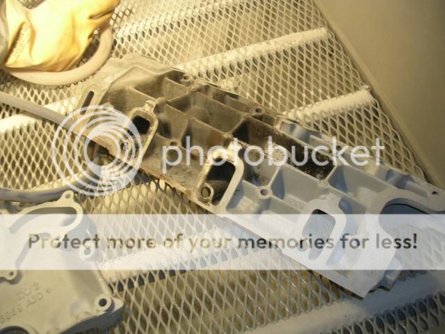

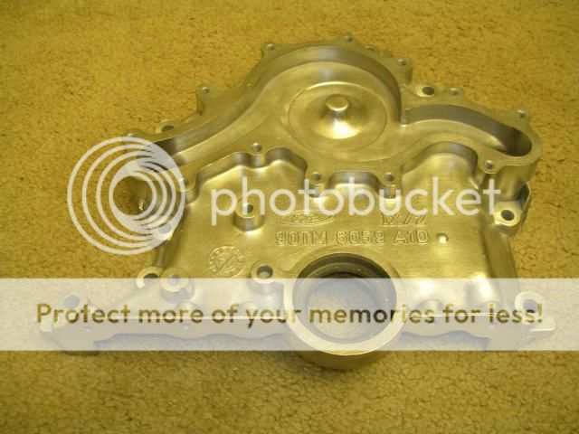

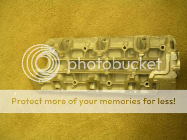

Blasted all the oil stains and corrosion off and then hit everything with a brass wire brush and cleared all the exterior surfaces.

Dang those are good and clean enough to just clear coat and run with them.
Robert
posted with a cramp and Prozac.
Damn those are shiny......I need to send you some ar15 parts.

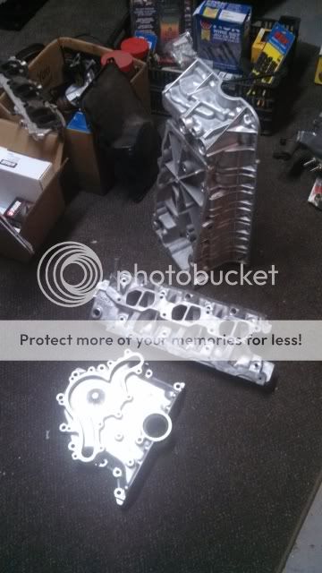

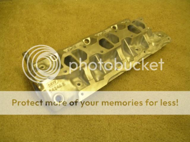

Cleaned up the SOHC pan too

Does the SOHC pan give another quart of oil capacity? Besides looking good...
Sent from my HTCONE using Tapatalk
The SOHC pan has a main girdle built it, but you also need the SOHC main bolts, 2 piece oil pickup tube, and the proper torque procedure.
Still holds 5qts.
