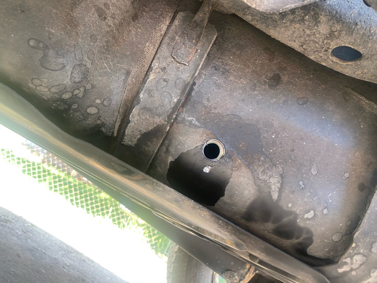

I, living in the shizz hole that is Spokane, am dealing with a vast amount of homeless people on a daily; it hasn't mattered much until last week when I had someone drill a hole in the bottom corner of my gas tank to steal my gas.
Understandably, I was upset, but I was mostly upset about how hard it was to find support for fixing plastic tanks when there were plenty of discussions about fixing metal tanks. After some research, I found a few options, one of which I successfully used one of them to plug the hole in my tank.

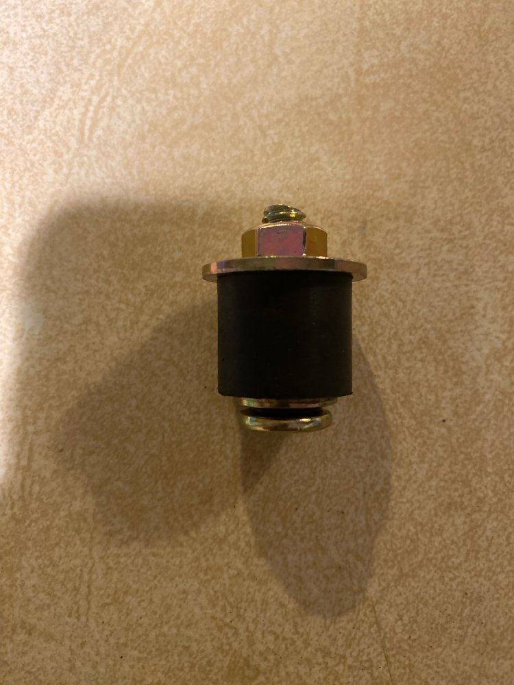

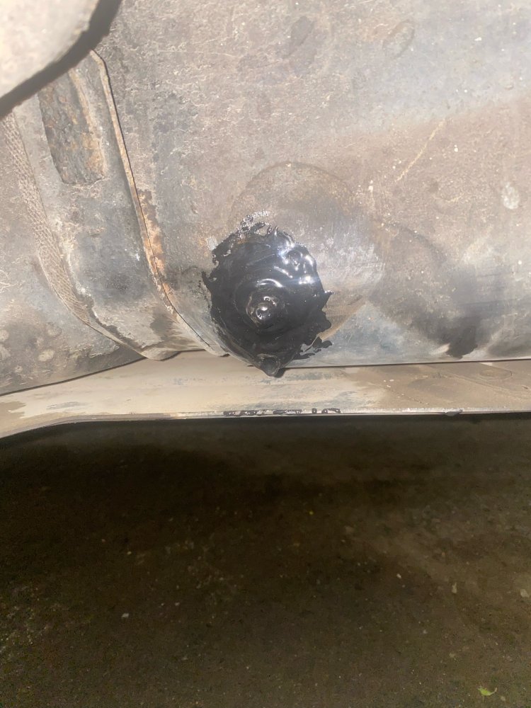

1.) I bought a variety pack of neoprene rubber expansion plugs on Amazon, the smallest of which (3/4 inch) was just small enough to hammer right into the hole. I tightened it as I tightened other expansion plugs (until you can't anymore); needless to say, I broke the rubber seal. Luckily, the kit came with one more of the same size, so I hammered that one in and hand-tightened it almost as tight as my fingers could get it, ensuring it was snug and had minimal movement. I then used the plastic JB weld and smothered it all over the top of the metal bolted area and the immediate area around the bolt on the gas tank. That has been working for me for the past few days, and I don't see that changing until the rubber eventually gives out from the gasoline exposure. Hopefully, because it's neoprene, it will last a while.

The rubber on that expansion plug will degrade and particles will end up getting drawn into your fuel system, I'd consider it a temporary fix and get a new tank as soon as you can. Then I'd add to the skid plate to defeat the next gas thief. I hope the dirt bag got a gas shower when he drilled your tank.
That's the basic plan as of right now; I just don't have the time or money to put a new one in, i figured the rubber would get worn out at some point.
as for a skid plate, I have the OE skid plat on the bottom of it. If you look at the pic with the hole, the skid plate is on the bottom, and the hole is on the side.
I've been thinking about adding something to that side to keep people from doing this again in the future, but right now, I just don't have the time to put a lot of research in.
as far as a gas shower, based on the HUGE puddle of gas under my truck after it happened, my guess is they took a max of 5 gallons and let the other 10 gallons I had in the tank at the time spill out.... which sucks.
