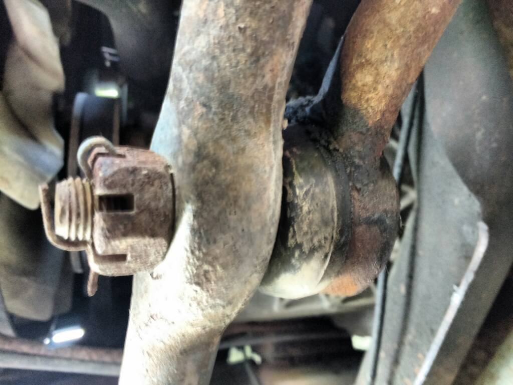

Also could you snap a pic of the front suspension? Camera at the same height as axle beams and tires straight ahead.

Looks to me like someone has put in a spacer under the coil spring. Can you get a clearer pic of that area? Also get a pic with the pitman arm showing, with the camera at the same height as the tie rod bolt. And last get a pic of the radius arm to frame connection from the side.

Here's some close ups
How's everything look
I got pics of the tie rod joints and the pitman arm connection.
I also got a pic of the spacer...guess I kind of have a suspension lift?
Sent from my MotoG3 using Tapatalk
The Pitman angle does look off a bit. The tech section shows the proper angle. Plus 4x4 junkie always says, " You get a suspension lift you should get a longer pitman arm. " And I read his post about lifts religiously lol.
