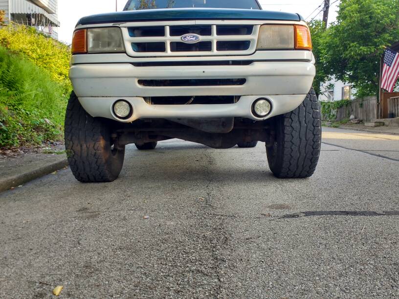

The issue is whether I should get a steering damper or upgrade my pitman arm. It seems like my body lift came with spring spacers in the front, so I may need to get the pitman arm to compensate for the added height.
Here it is
driver side
Pass side
Lmk what I should do...i don't even know what size to get pitman arm wise.

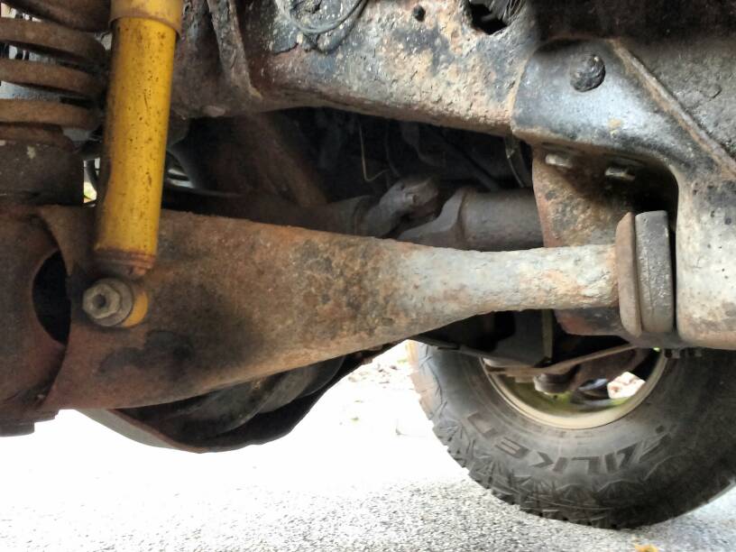

The reason I asked for pics in your other thread is because what you originally described didn't make sense. And when you showed your pics we could see that there was a suspension lift [of sorts] installed. I would still like to see a pic of where the radius arm connects to the frame, that might tell us a little more about how much was done for lift. Also please take a pic of the front pitman arm, with the camera at the same level as the tierods, and far enough back that we can see both tires. Basically the same as the first pic in the linked article. You will probably have to take it from the drivers side of center in order to see behind the front cross member.
I think that you would be OK with a fa400 [the standard drop arm] pitman arm, but the pics will help make sure.

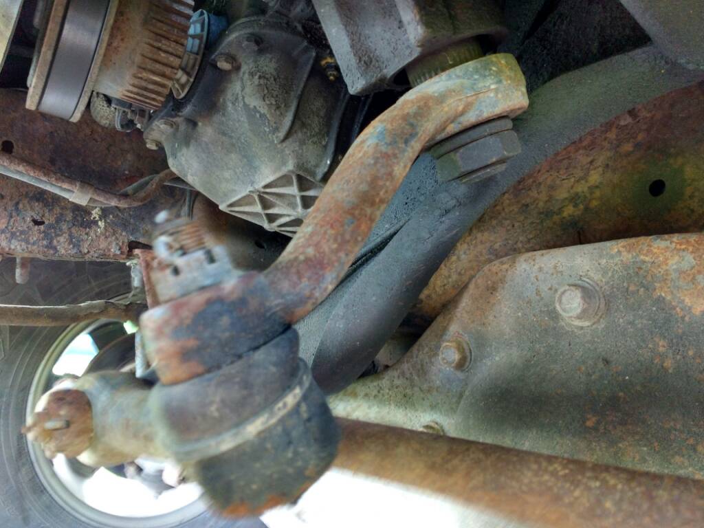

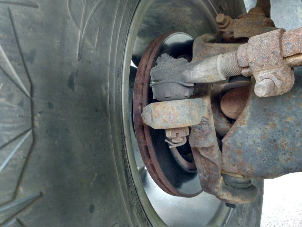

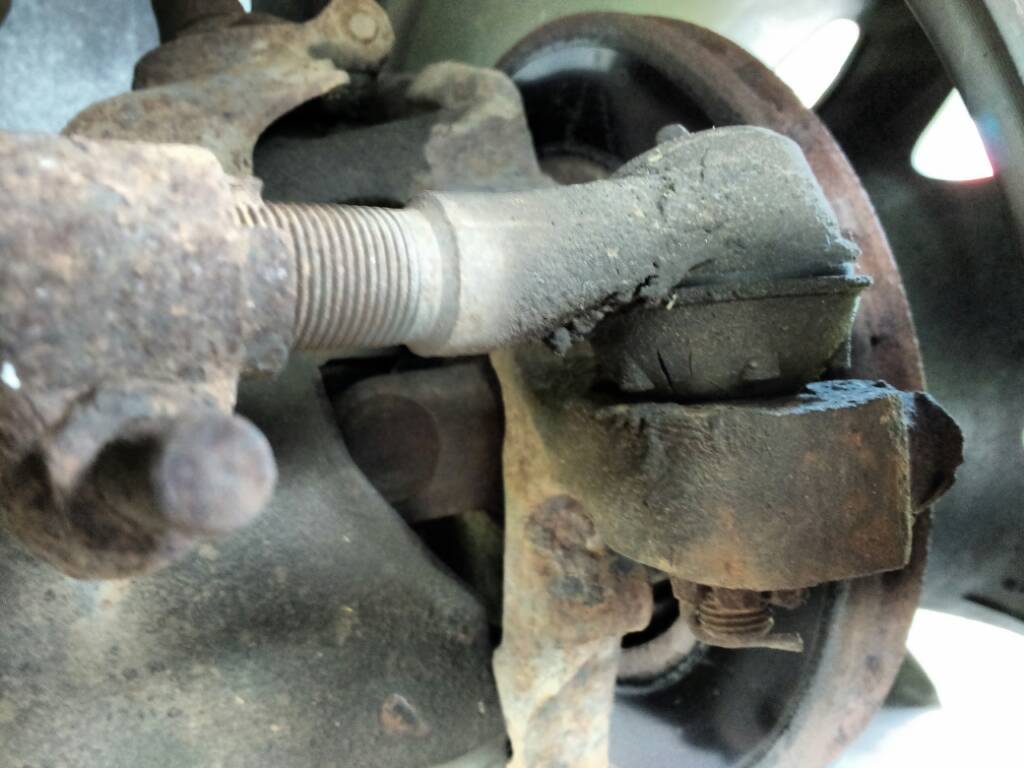

Here's the tie rods I do believe:
pass side
Sent from my MotoG3 using Tapatalk

As far as worn out steering and suspension parts, it's impossible to tell if they are fubar from a pic. You need to have a helper moving the steering wheel and you be checking for play at the tierods and pitman arm. Ball joints, wheel bearings, and steering box are checked a different way which I won't get into here. Then don't forget the rag-joint which is hidden under a plastic cover just above the steering box. Your best bet is to take it to an alignment shop and let them check it for you, then replace anything they say to, and then take it back for an alignment. Make sure they have the proper bushings for the TTB style caster and camber, as they are not a common item.

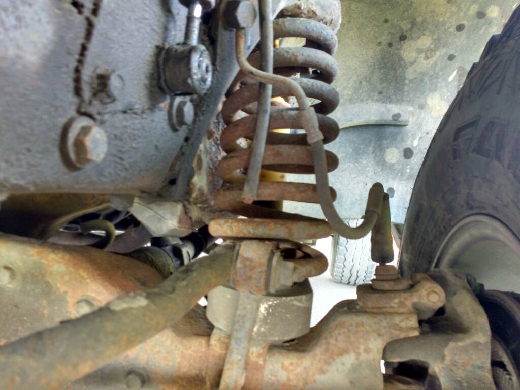

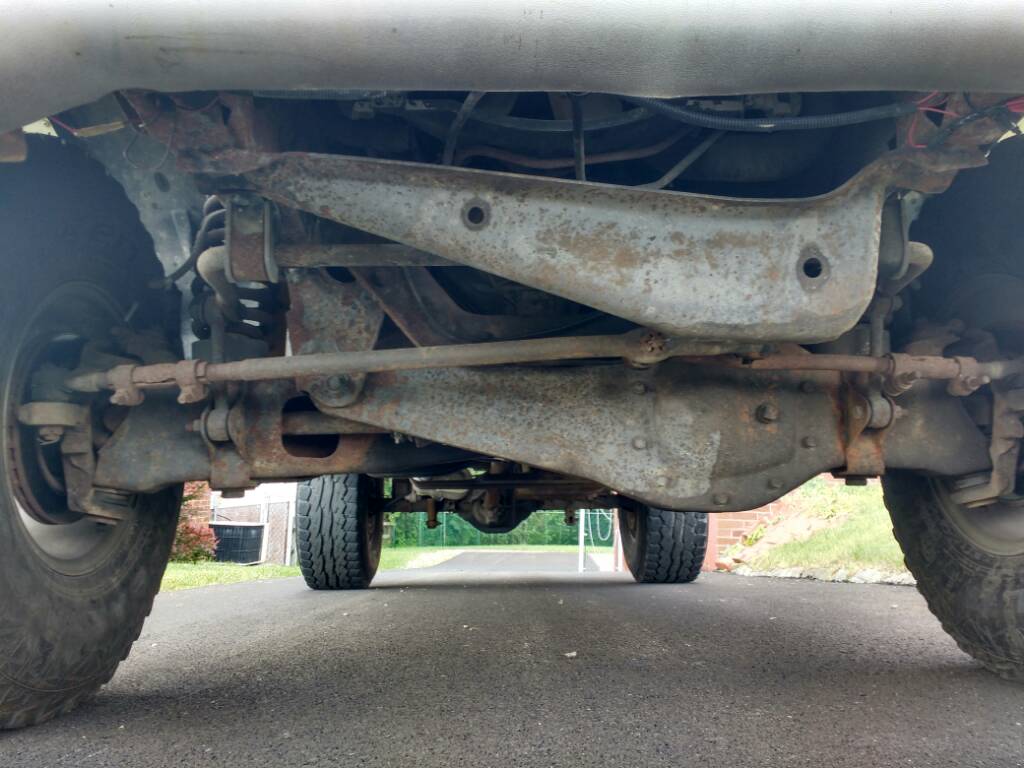

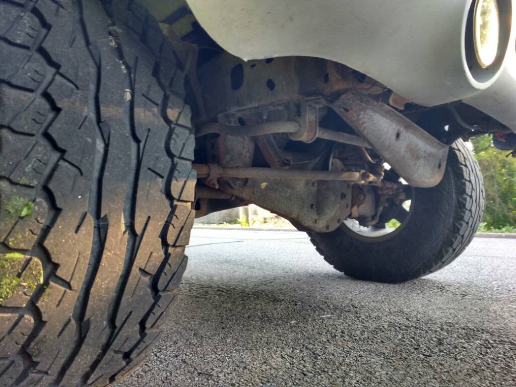

Drivers side

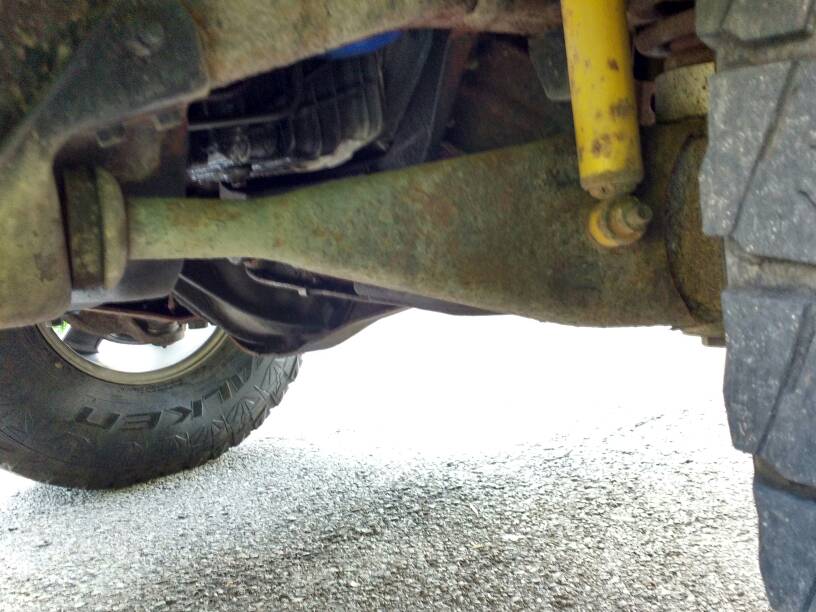

pass side
Front view: I got different angles again, hoping they can help. That cross member is a big pain.

The pitman arm and tierod angles looks good to me from the pics. The spacer under the springs I suspect is a bandaid for sagging springs. It's time to check everything else.

To me it looks like you have just a spring spacer lift on that (a body lift consists of spacer pucks inserted at each cab-to-frame mount location, and is a completely separate entity from the suspension).
You shouldn't need a drop pitman arm for a spacer lift... It's only when the axle pivot brackets are swapped out for longer (lowered) ones will you need a pitman arm to match the amount the axle brackets are lowered.
Assuming your tie rods, ball joints, wheel bearings, the axle & radius arm bushings, and steering column components are all in good shape, I would suspect your problem to be related to insufficient caster angle (caused by the spacer lift). Some caster angle can be restored by using higher-offset (or adjustable) camber/caster bushings, but it's possible you may have to also drop your radius arm mounts down 1-2 inches to restore the caster.
You might also check for excess play in the steering gear. This doesn't cause "Death Wobble" in the usual definition of the term (extremely violent shaking), but rather causes wandering within the lane from side-side, and seems like every slight correction you make to keep it in the lane is an over-correction.
Under no circumstances should your truck require a steering stabilizer though (on these particular trucks a stabilizer is nothing more than a band-aid to cover up symptoms stemming from another problem).
