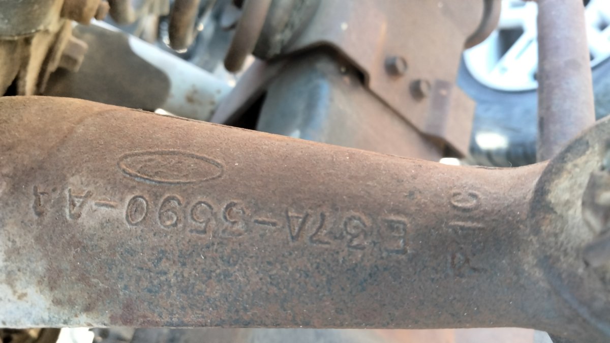

Edit: Correction - I missed the 2wd in the original request, everything below is a 4wd so please ignore:
and here I took the time to check the 1st gen in the 'yard today and get dimensions for ya :p
2 3/8" offset, 5 3/4 center to center
Just in case it was too difficult to read I scribbled down the part no E37A-5590-AA ... now looking at the high res I think that first 5 is supposed to be a 3 - with the part number it should be real easy to get a drawing with a little google fu.
